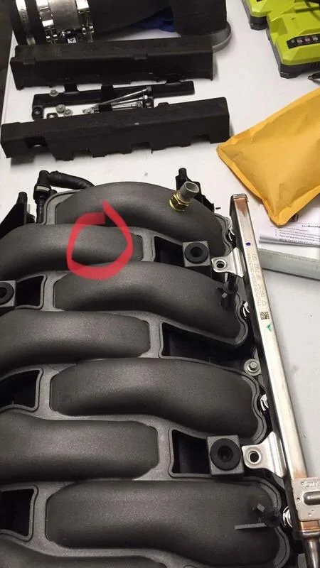

Yeah they suck big time. Make sure its high enough to not interfear with any coolant or brake booster lines.
The threads are a 3/8-18 NPT tap
Think it'll be fine to install here?
So drill using a 3/8 bit and then screw the sensor with locktite on it?

Use a 9/16 drill bit then tap with the 3/8 npt pipe tap, don't bottom out the tap or the sensor will remain loose run the tap in just past half way then check fitment of the sensor.

Thanks for the tip! I had to order a 3/8-18 NPT tap as I didn't have one. Appreciate the info guys!
