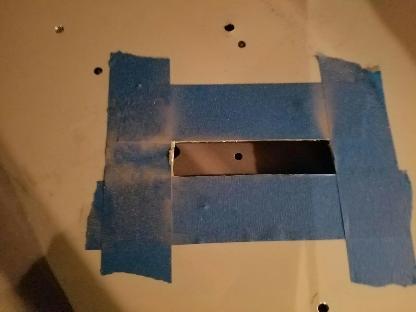

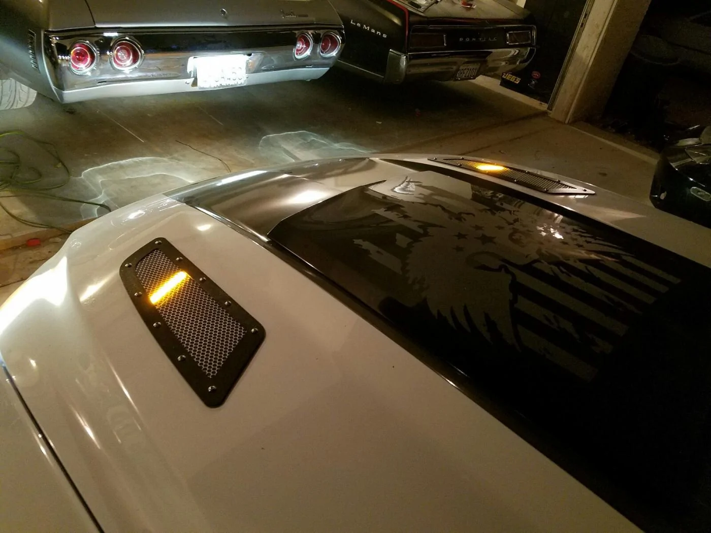

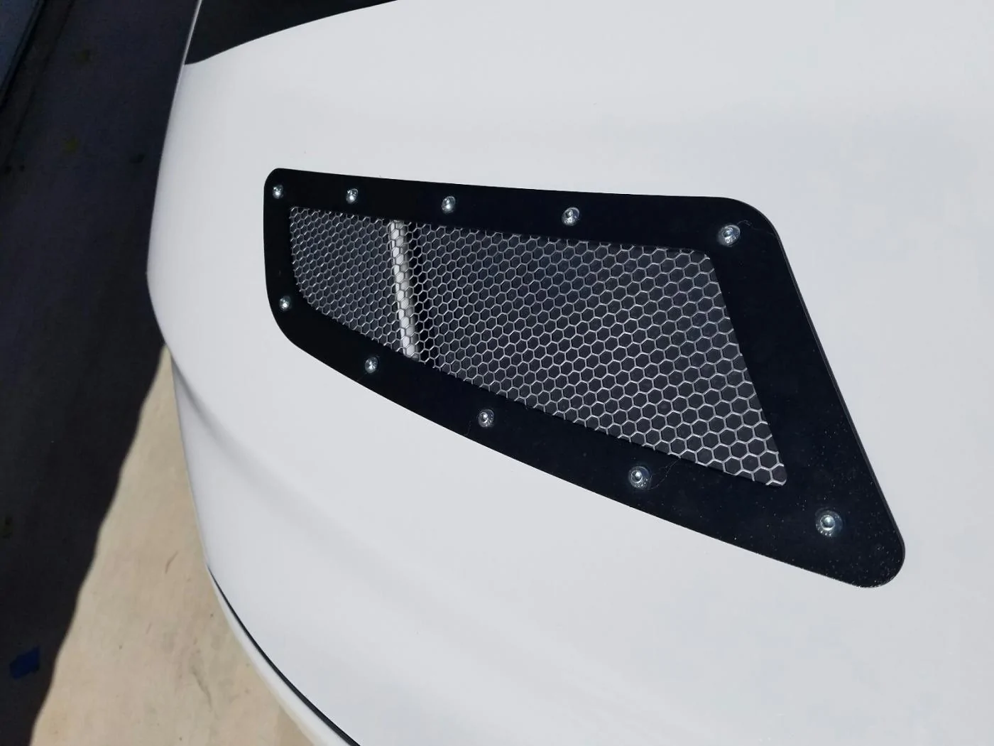

So about 6 months back now ..i did to want to do this mod..i ended up modifying drake heat extractors with Starkey products led hood vent turn signals..i did as well have to cut a hole in the hood..not as big and drilled like 10 holes each side ..everything fit really flush ..and eliminated that flutter..as for the water getting in the engine bay..i use airraid inclosed cai.

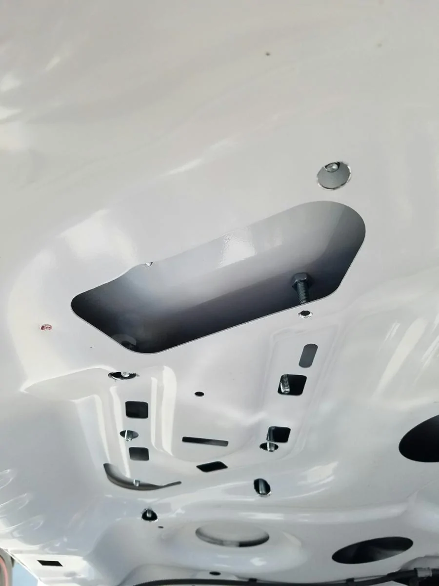

[MENTION=23824]Nookie[/MENTION] see [MENTION=26474]Elvis66[/MENTION] 's post, the picture third picture is the second skins mounting points, it's impossible to fit them in two different slots unless you modify the second skin in a separate place. Modurstang fit them to the stock locations.
