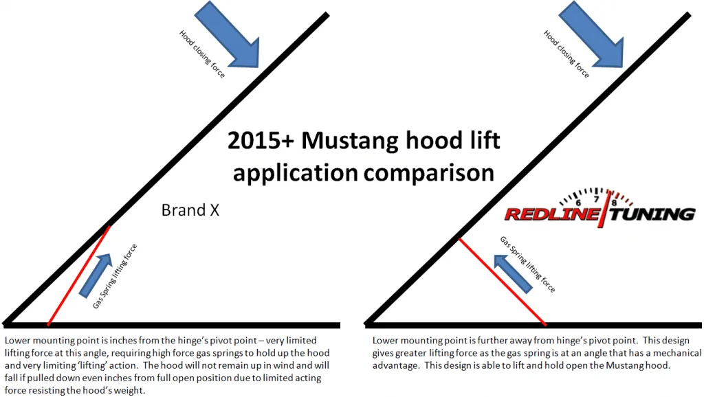

There are many options out there, but the graphic below shows why the geometry of our system is the best:
In addition our system does not require you to loosen both hood hinge nuts so there is no concern with the hood alignment. :thumbsup:

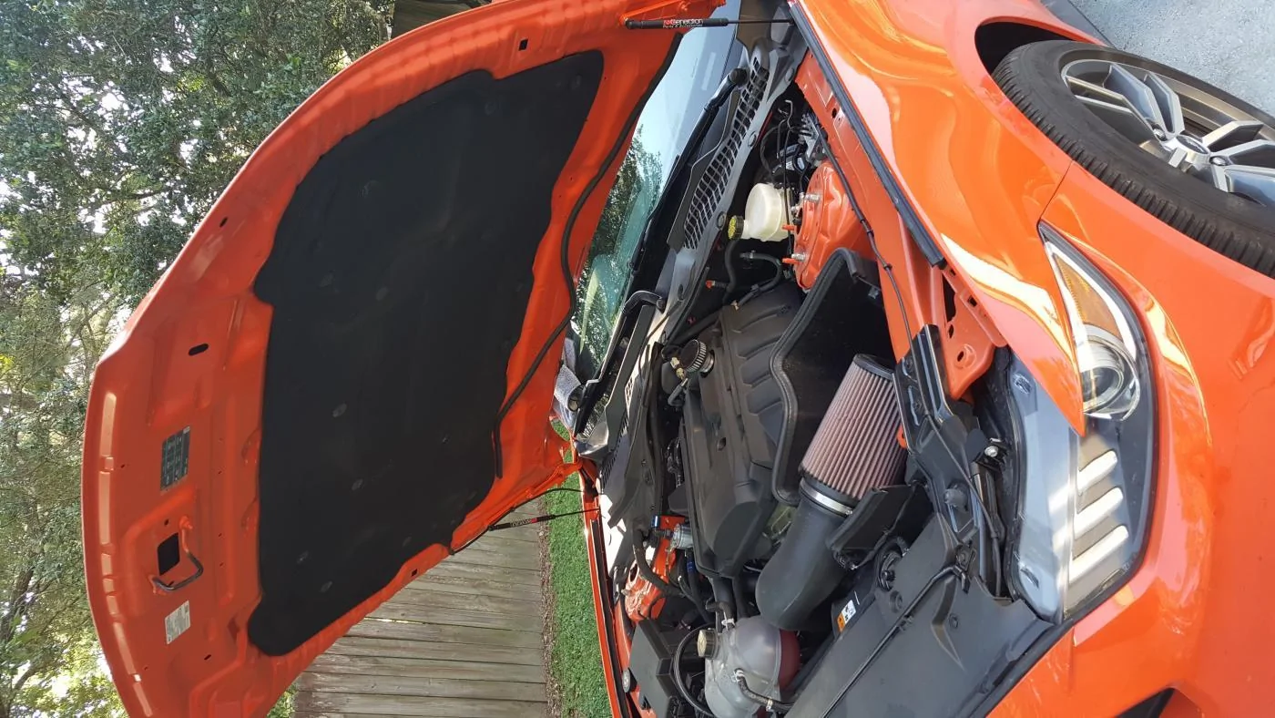

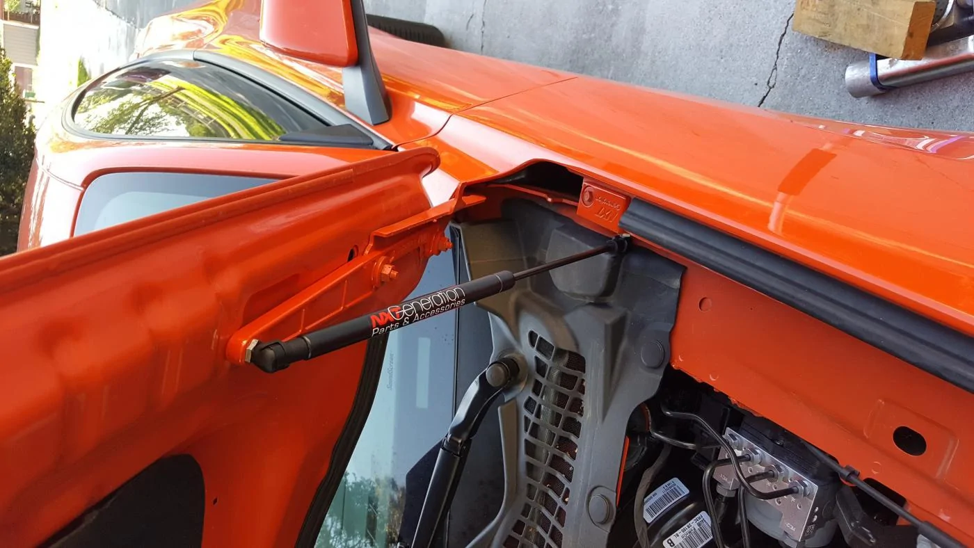

Cut a slit from the hole you drill outwards and the battery cover comes right off without removing the struts. Really simple and you barely notice the slit or the hole. Honestly when you pop the hood to show anyone they are going to be looking at the engine, not the battery cover or the small hole you drilled in it.
I just put my redline's on this weekend and couldn't be happier, great product! JLT painted them to match and they look as great as they perform!
