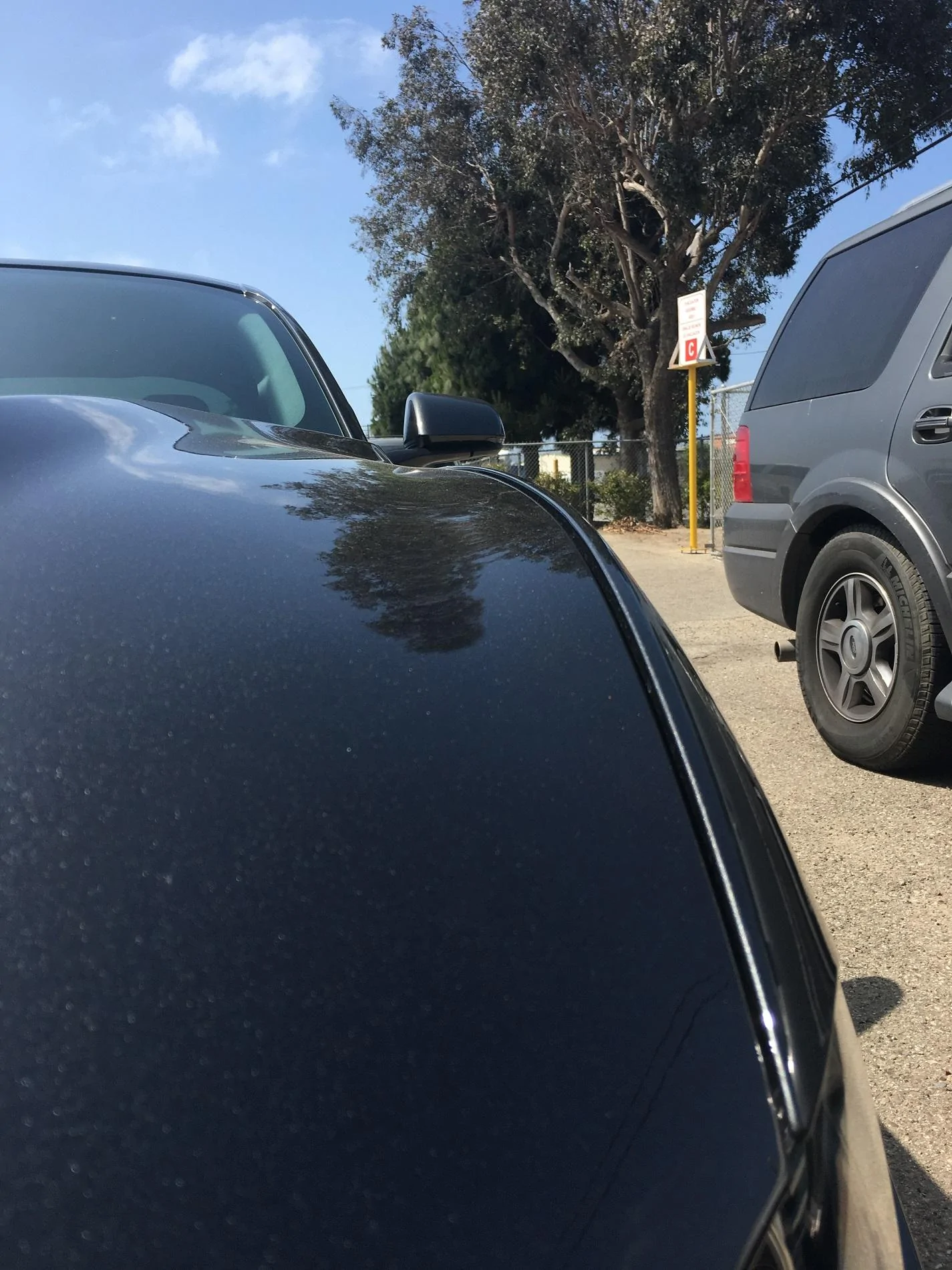

Hey guys so I just installed Redline's hood strut kit over the weekend and now the driver's side part of the hood sits lower than the fender like 1/4 inch lower. the passenger side sits normal, and before the install everything was fine, I'm kinda at a loss on how to adjust the hood back up. Any others have this issue? Or suggestions on how to fix it?

My thoughts exactly, I did not measure but I will go take a couple picture real quick and post them

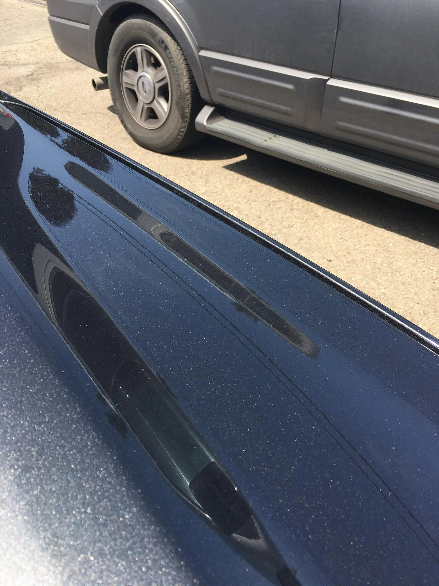

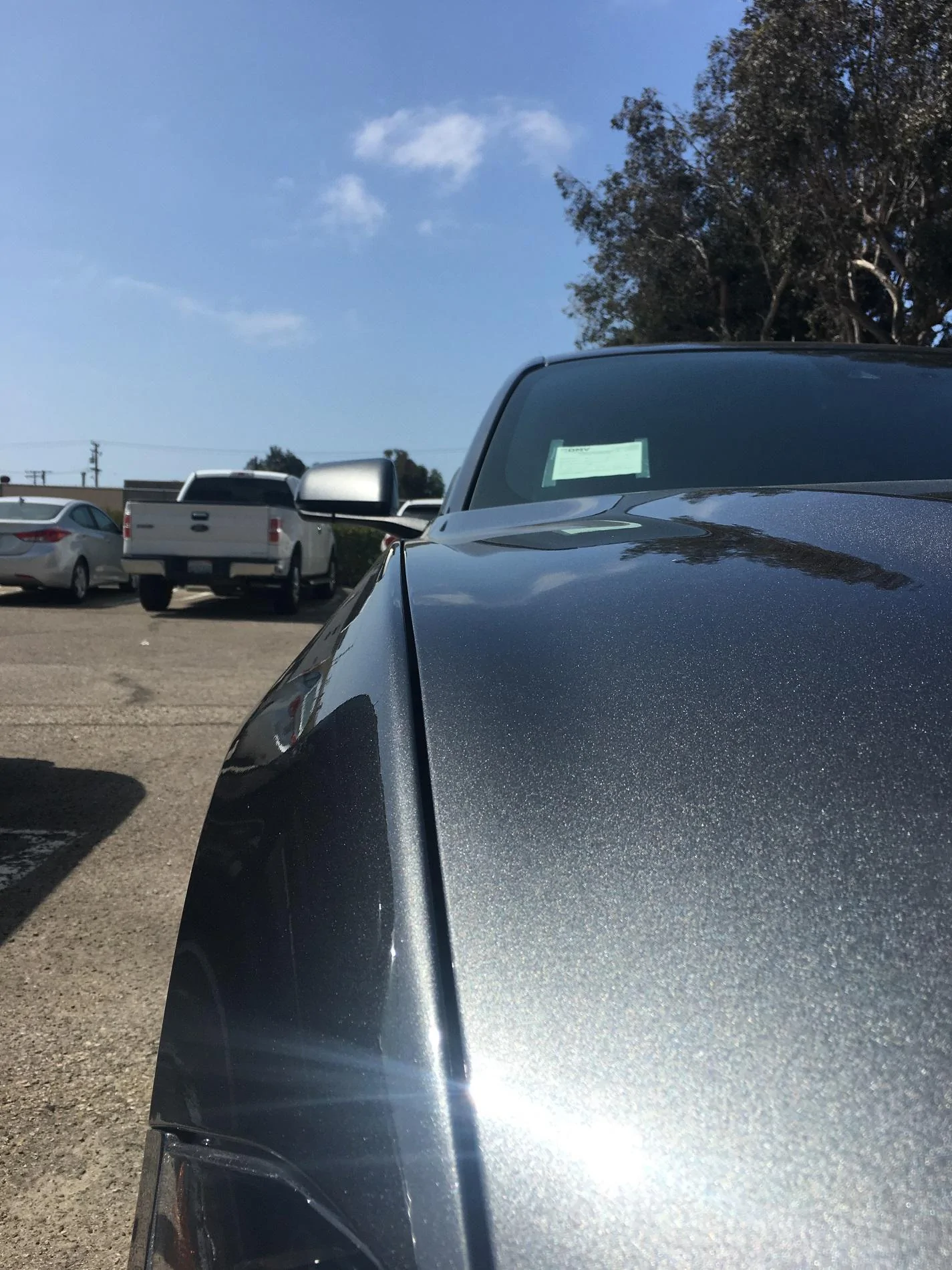

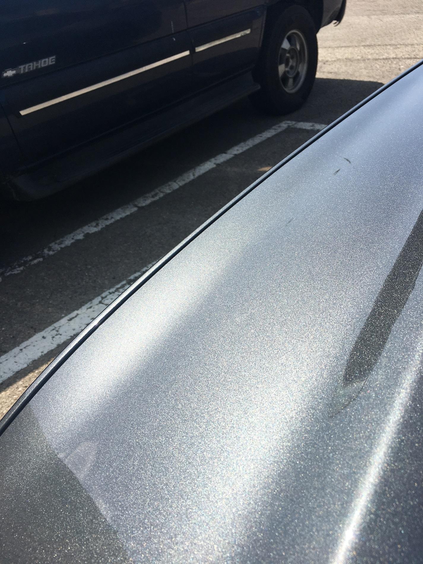

heres the pics
