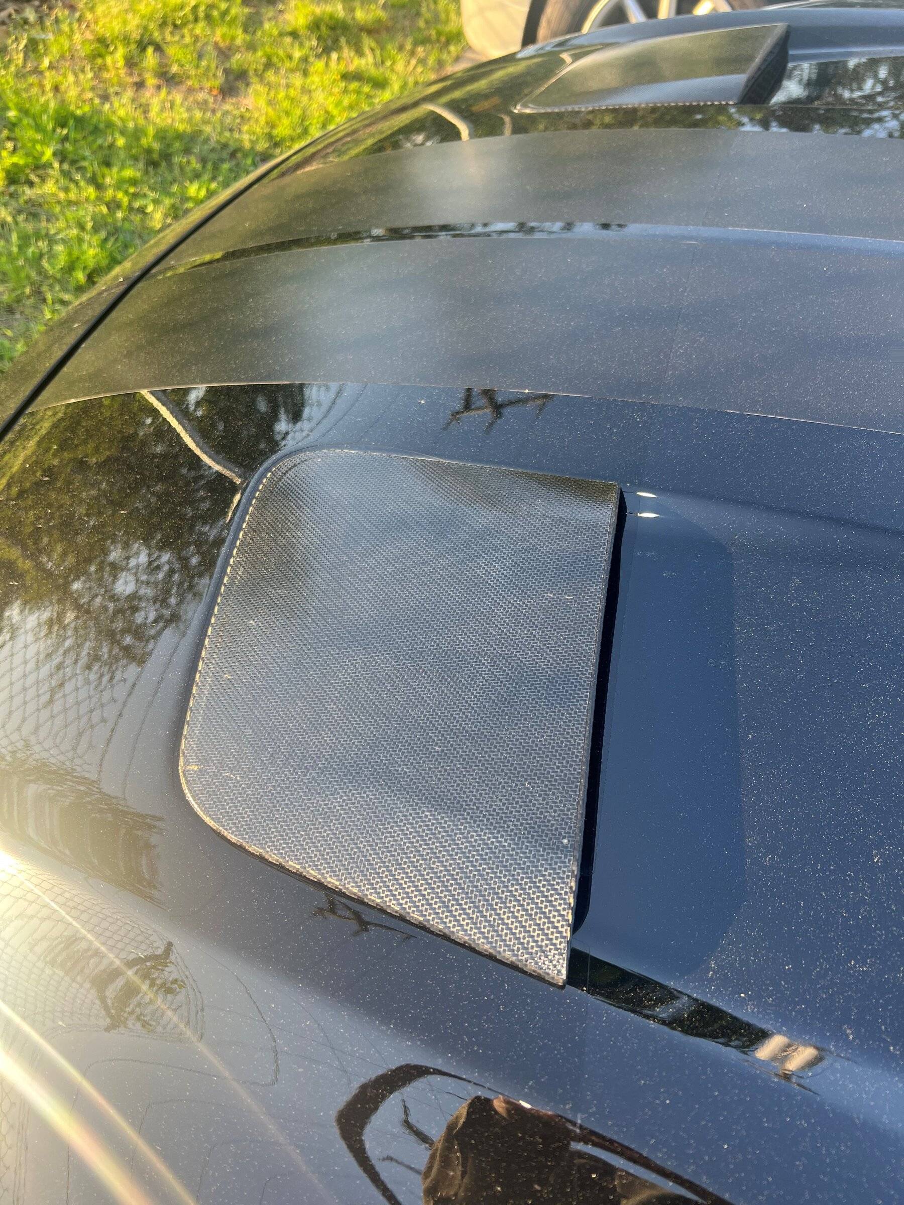

It can if you have a good installer. The heat vents and strips both have ppf on them also. Ignore the dust.

Have you seen both the FJG and non-FJG hood stripes in person and felt them with your hand? They drastically differ in surface. You need to see it to believe it, I guess. I had the matte PPF on the matte part of the stripe at the detailer and it was removed, as was expected from previous tries shown here, microbubbles were created. The rough surface just doesn't like it. FJG is entirely different case. Also the same can be said about the "Mach 1" letters in the stripe, FJG has them in same paint with shimmering metallic particles, my stripe has them in same non-shimmering rough matte paint, as a result, PPF hides that logo, makes it barely visible with just the outlines, which is unfortunate... You really need to see it in person, have both cars next to each other, then you'd know. Matte stripes can be ppf'ed, just not the non-FJG one, sadly, it has completely different surface than anything else the detailer ever seen, like 3D texture, not really like stripe but paint on the stripe. So no, it's not about a good detailer. Mine did a perfect job on the full wrap otherwise.
I can only speculate that they made two versions of the hood stripe's matte part because on gray FJG it needed a bit more punch, so they added metallic particles, flakes, and gave it different reflective properties, it's less matte, more reflecting, less diffusing light, smooth on touch. To make it work better with the FJG colour around and stand out more, I guess. FJG stripe kinda looks higher quality upclose.
