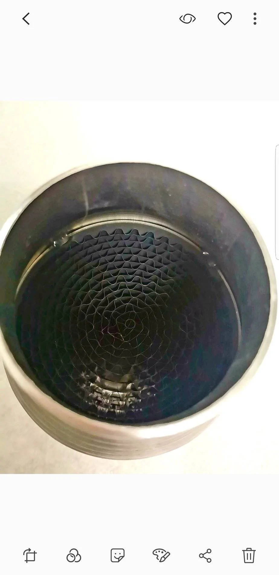

So I'm still stumped and trying to understand, how does a cat delete make a car so much louder over a high flow cat? I've just ordered 50 cell cats and u can practically see right through these things . So why is it that a delete would be louder than a 50cell cat ? Can someone make sense of this for me? Theres nothing in the way of the 50 cell cat practiacally

For one you have something that will have resonance to it vs a delete that has non.

When I swap between my catted ARH lead pipes to my catless ARH lead pipes, there's a massive volume difference. Cats are just really good at muffling the sound.
It doesn't, the high flow cat you just pictured will be 99% as loud as a true cat delete.
However, that is an extreme high flow cat...it's pretty much just a bulge in a pipe with just about nothing inside. Most other high flow cats have a decent amount of material in there. Not as much as stock, but alot more than the one shown. That's why most high flow catted setups are not as loud, and definitely not as raspy.

You just made my day man hahaha . I'm really hoping you're right. Cuz I'm trying to get a special while you out of the car as I can without doing a cat deletes or long tubes.
