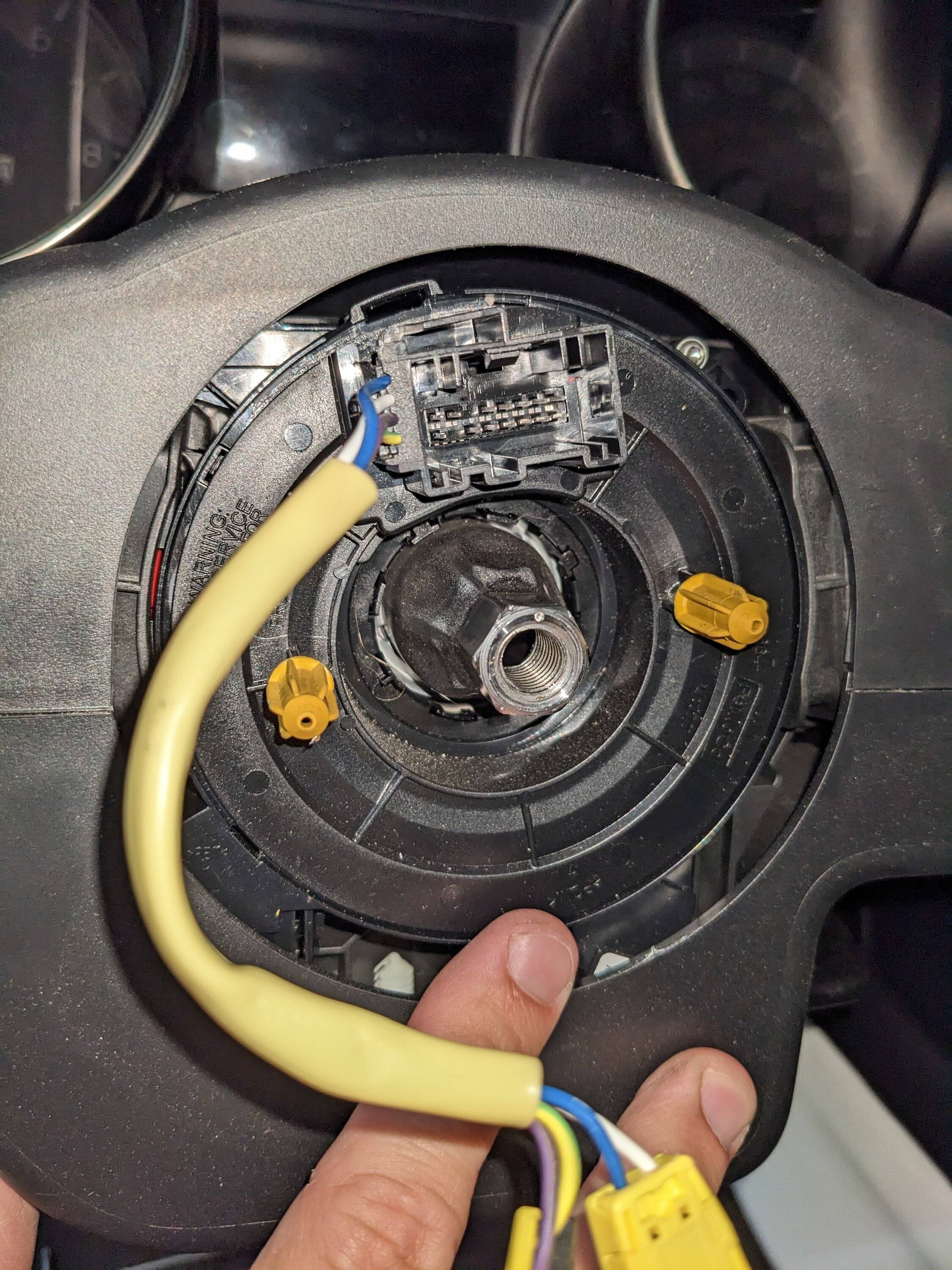

Anyone know what this part is called the steering wheel clips into? It has tons of slope, and I suspect is the source of my magride/audio/launch control issues I've had the last two years.
Sorry if the photo is massive.

Clock spring

Got the new one. There is a surprising amount of slop in the brand new part, and it was confirmed this much was "normal". I guess about 1/16" of play between the two parts, where as the old one was more than 1/8"
I am starting to think this isn't going to fix my issues. Oh and Ford has no returns on electronic parts haha
