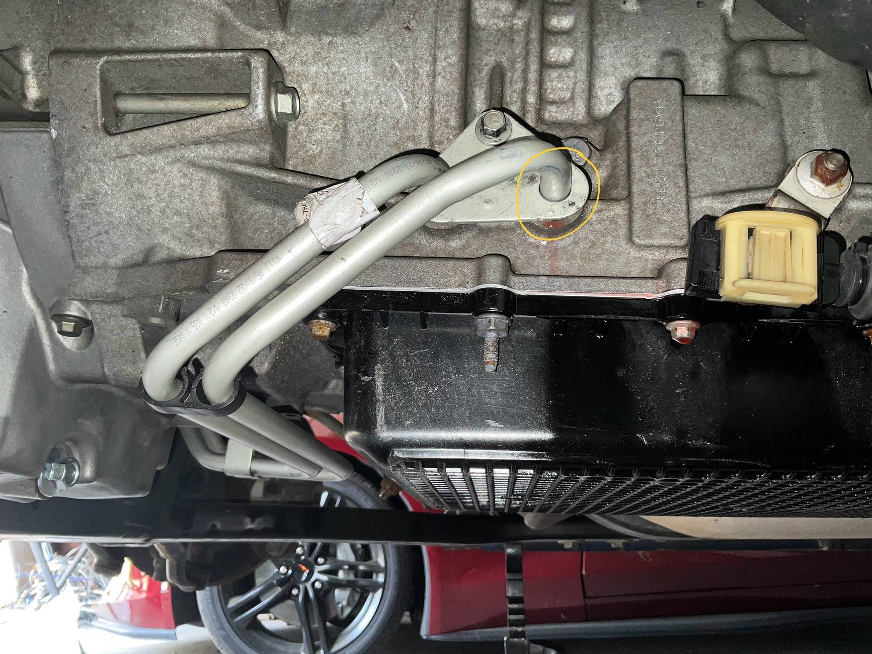

Help with identifying part
jaybong1
May 16, 2024
Ohio
Jay
2016 mustang gt
leaking transmission fluid. Need help with the part number or what this part is called. thanks in advance. I have a 2020 ecoboost
IIRC, there may be an O-ring at that location. Someone with the 10R80 shop manual may be able to provide the service pages for that area.

Have you tried just tightening the bolt?

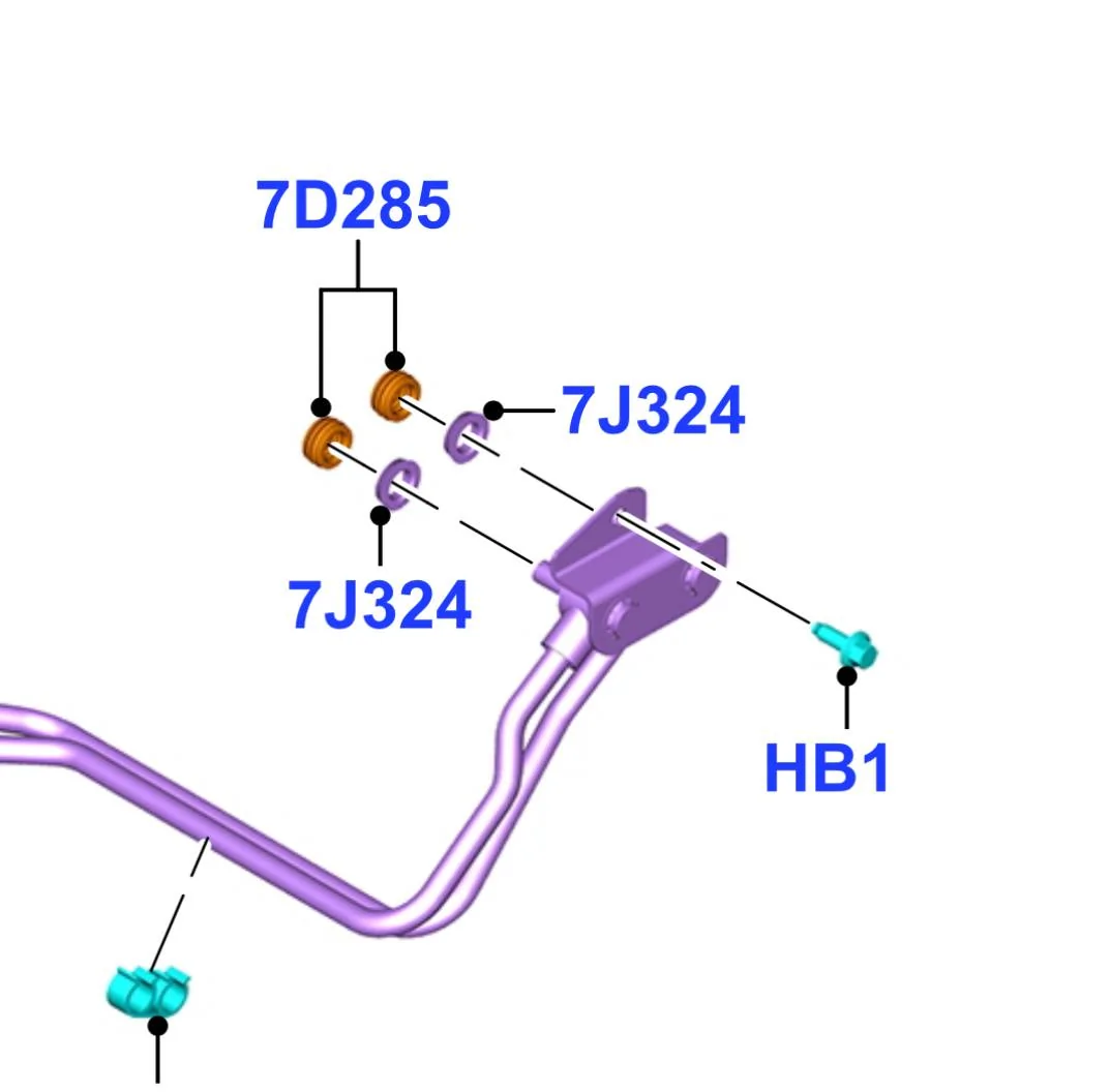

Found the part. It was actually two seals per line. both lines were missing the outer ring , replaced them and the leak is fixed.
Good deal. Your post and fix will help others in the future looking to do that same repair on a 10R80.
