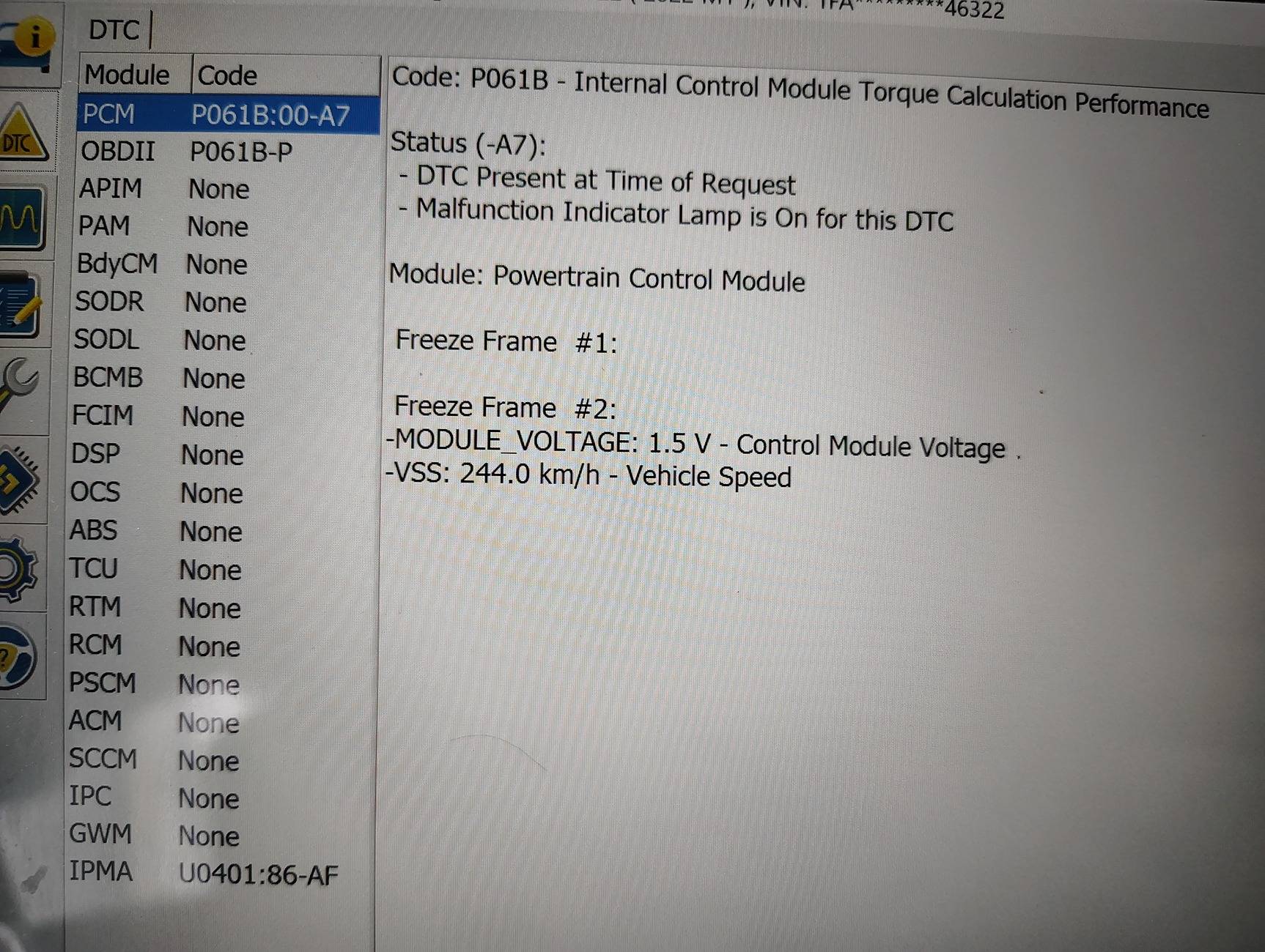

They have recalibrated and updated each module... Flashed ECM with factory tune. Did they replace those collapsing vacuum lines on back of intake? Nope... Like they are doing the bare minimum. I have Forscan and I usually only get p061A or p061B a long with a code in the IPMA.

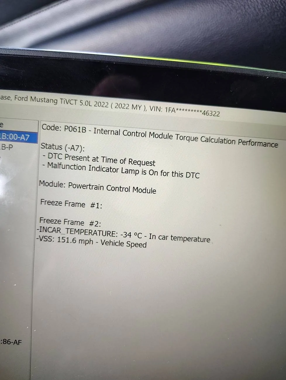

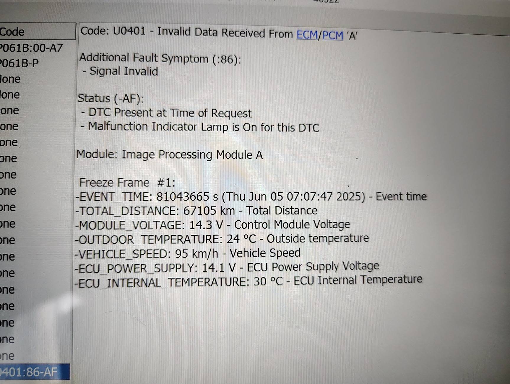

This morning I decided to log VSS and some other parameters on the way to work. When it threw the wrench light this time I got a freeze frame showing PCM saying VSS at 150 mph. Every other module showed 60mph. The data stream for the VSS was all over the place after this.

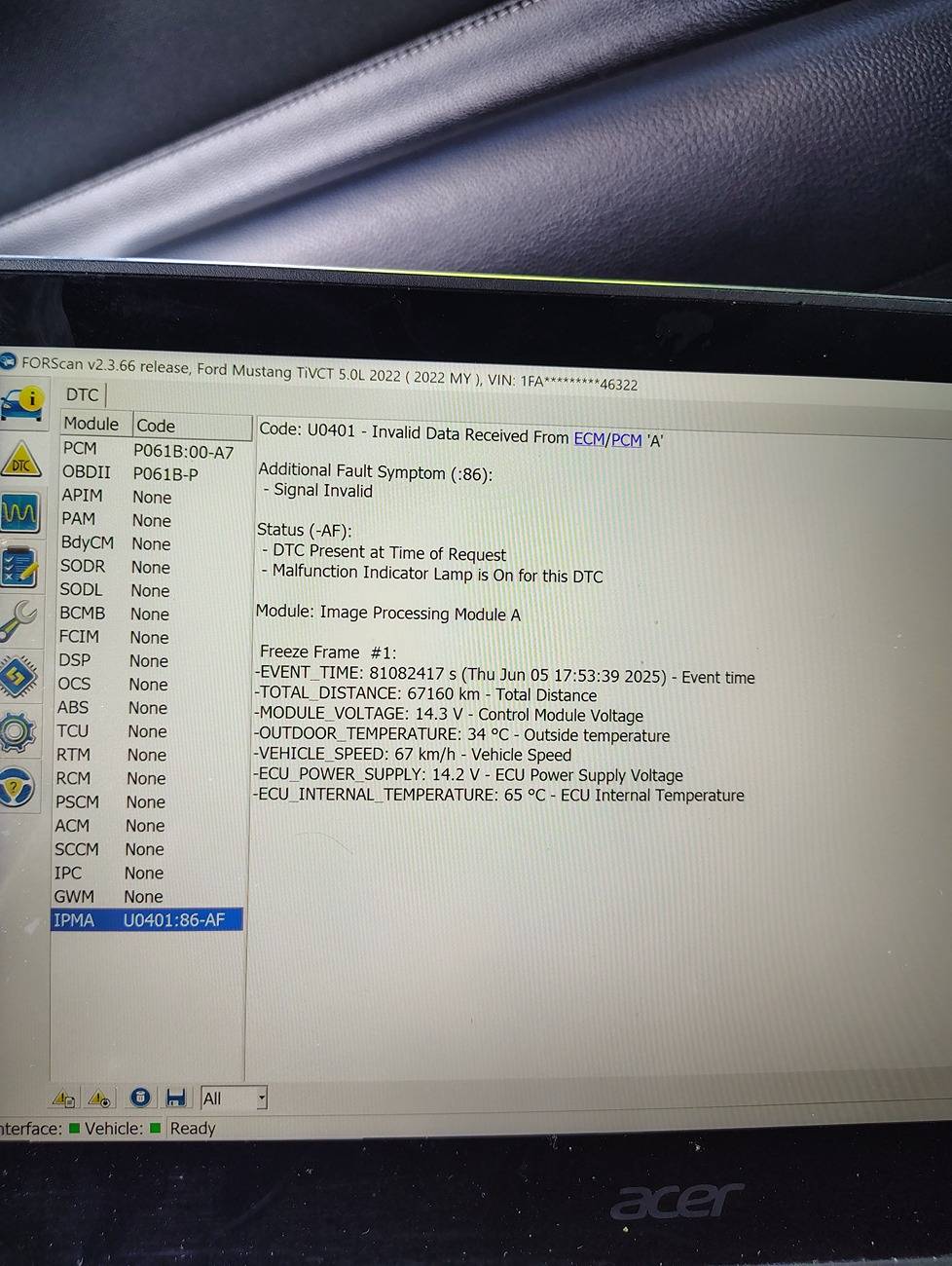

After work I used the same PID's on the way home. Everything looked good. Then I got the wrench light and again with a freeze frame showing VSS at 151mph when going 45mph. The VSS log stayed the normal though. Not all over the place like this morning.
Could this be the VSS sensor causing this or is this likely a PCM failing? The car does this no matter how you drive it.
