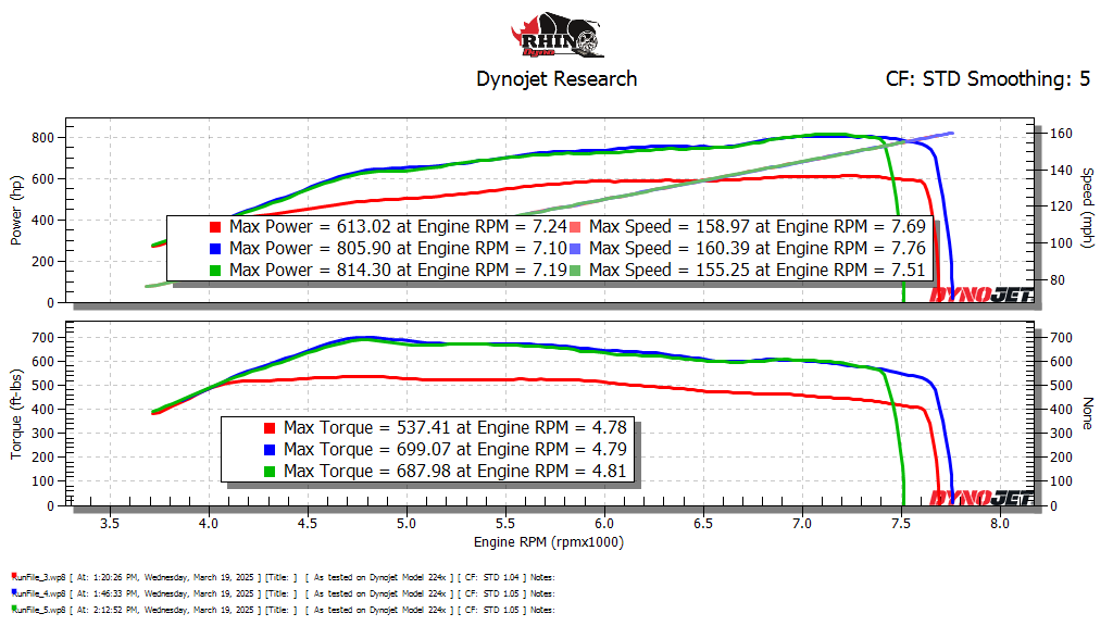

Looking for some advice with boost settings on a twin turbo S550 for 93 and E85. Currently car has SP at 10, GP at 0, and car is making 9-10 psi. Fuel system is a Wengerd dual pump hat..
I'm wanting a boost group for 8-10 psi for my 93 tune and groups for 12-14 and 16-18 psi for my E85 tune.. Is this possible with the Turbosmart controller?
Thanks!
