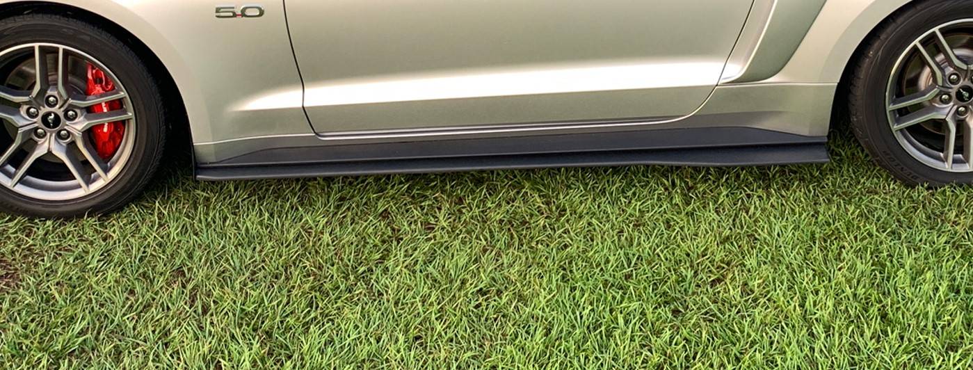

I added Scott Drake Rocker Splitters that had a glossy looking surface which made the skirts look darker as well. To match the color and texture of existing parts I used Rust-Oleum 12oz aerosol Multicolor Textured Aged Iron (P/N 223525). The lighter flakes seemed to rise to the top. When I lightly sanded the texture with about a 600 grit paper, the color matched perfect (Just enough to knock off the light speckles, but not lose the desired texture).
Realizing the Rustoleum is not overly durable as a top coat, I applied SprayMax 2k Urethane Clear Coat Matte (P/N 3680065).

Good to see someone who had a similar idea to me and actually carried it out. I kept finding the opposite results in my research (someone trying to turn textured splitters to gloss black or even painting the OEM skirts gloss). Nothing against painted splitters but something that would make the aftermarket parts look like they came on the car from the factory would definitely help me maintain my clean look I’ve been going for. Do you happen to have anymore photos? The difference looks almost unrecognizable against the OEM skirts in that photo. Thanks again
I can try to take photos in the sunlight tomorrow, as I don't have any close-up pics currently.
BTW...I would also suggest a good surface prep, as those locations are vulnerable, and you don't want your paint peeling and chipping. I use a plastic adhesion promoter aerosol spray as well.

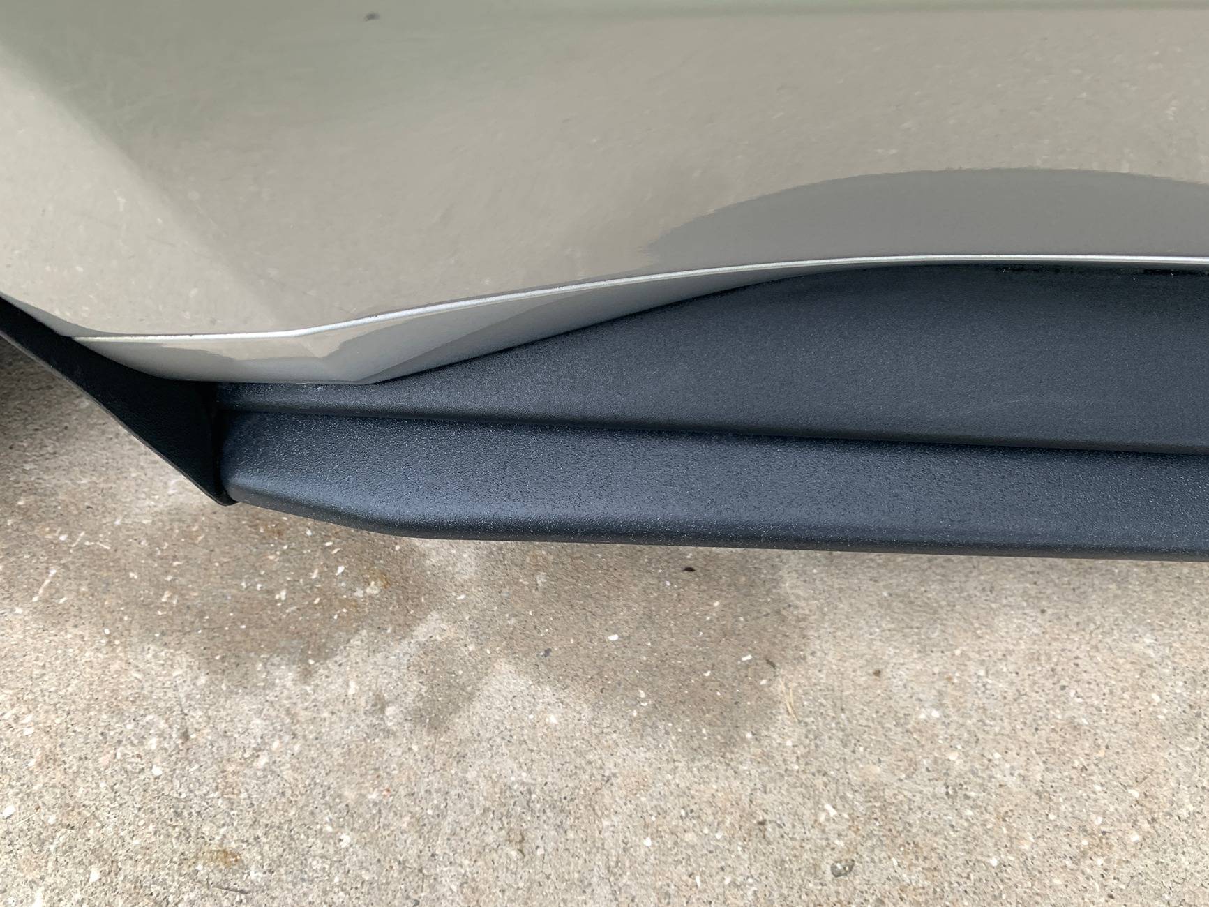

Here is a close-up. If you'll look closely you may see the white speckles. As I said earlier, I sanded lightly and it removed the more pronounced white specks (as they tended to rise to the surface). I'd like to reiterate to apply a durable matte clear. I learned that not all matte clear paints are created equal. The two I've had better luck with are the 2k SprayMax I mentioned earlier, and Dupli-color's Wheel Matte Clear.

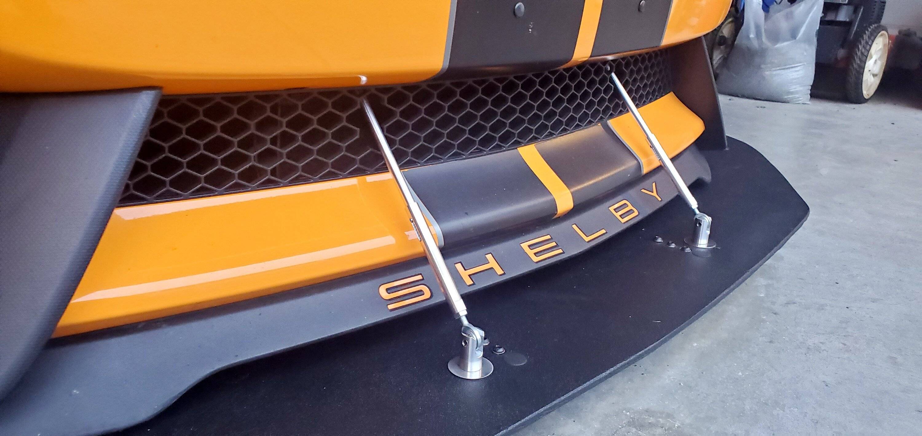

I used Raptor Liner spray on bed liner in a can for protecting my custom splitter. Not a perfect match, but not too far off. Would match better but the factory plastics aren't as black now as they were when they were brand new.
You’re right that’s not bad at all, and probably pretty durable since it’s meant for a truck bed. I’m shocked how close Snakebytes mixture of regular in store paint products came out. It’s near identical!
Honestly shocked the mixture you were able to create with off the shelf products. It’s almost identical to the stock color and texture. I definitely think I’m going to go this way over the SEP products. The SEP stuff looks like it works good but it’s super expensive and you need a variety of there products in conjunction for it to work. It’s not even about the cost, because I’m willing to pay for something to be right, it’s more so that it looks like I can get my desired look better with what you used. Thanks again!

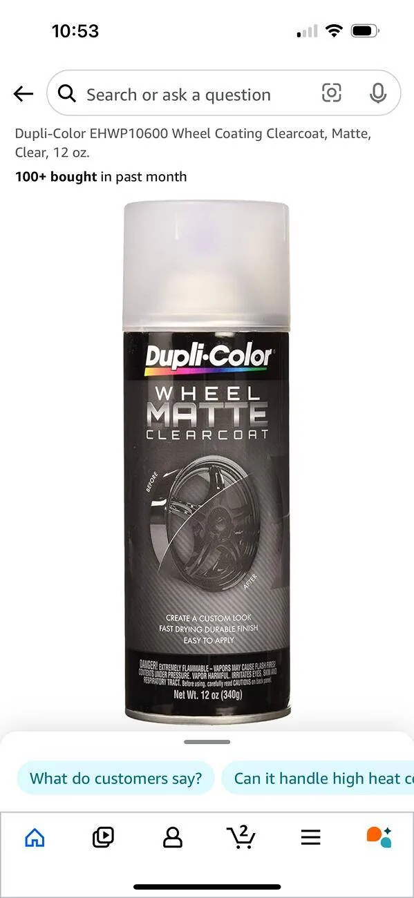

I see you mentioned the 2 different clear coats you prefer. First, is this the right duplicolor clear? Secondly would you pick one over the other? I know the DC clear is half the price but that doesn’t mean it’s half the quality, so I figured id take your opinion before ordering. I’d imagine 1 12oz can should do the job for a front lip.
If I was not aware of the 2k option, I feel I would have been pleased with the Dupli-Color Wheel Matte Clear results.
Realizing my side splitter is more vulnerable as sticks out further from the car, and realizing that my wife's personality is on the other end of the OCD spectrum, I opted for the 2k. :wink:
