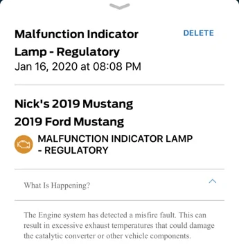

Hey guys, was driving tonight and all of a sudden the car started hesitating on throttle, was stuttering and losing power...(only used medium throttle to 4k...nothing crazy) Engine was warm...35 degrees out here in Colorado.
I saw a bunch of indicators light up and it said I couldn't switch driving modes or exhaust modes.
Saw that service engine light was on. Pulled over, turned off car and on again. Engine light was still on....then get a notice on my FordPass app on my phone that "The Engine system has detected a misfire fault"
I can tell its not firing correctly...power isn't their and there is more vibration..don't hear and noises or scraping internally..it's just running like crap. Car has been flawless up until now...no tick or anything.

Crank relearn fixed it. Took 5 min with a tuning device. Ripped it a handful of times, she’s running great!
