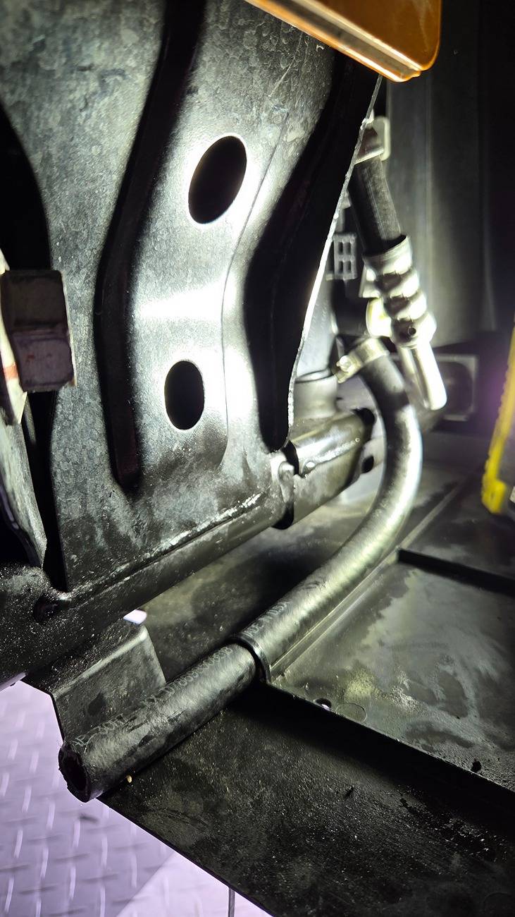

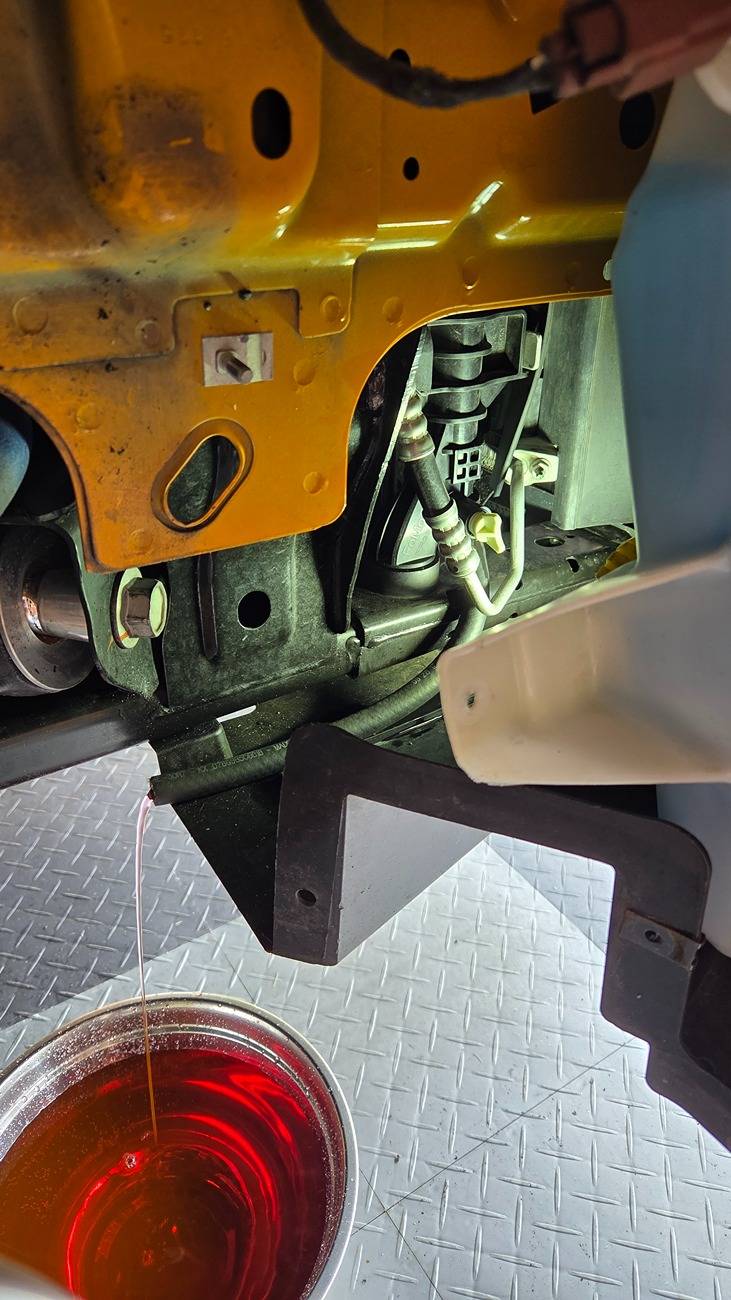

I want to move my radiator drain valve rearward, for convenience in draining.
I made progress by clamping a short piece of 3/8" hose to the short pipe below the drain valve. (Photo focus was on foreground and is fuzzy at the valve in the background.) I still need to remove the RF wheel and fender liner and then (with great difficulty) reach in to operate the OEM valve below the washer fluid tank.
I need the OEM valve to be always open so as to hand over the duty to the new remote valve. But the problem is that coolant leaks out of both the pipe and the valve when it is backed out. I can plug the new hose before installing a new "remote" valve. But I'm not sure how to handle the leaking coolant at the valve itself, short of stuffing a rubber plug in there temporarily. I hope this description makes sense.
Another approach is to cap the short pipe and then replace the white valve petcock with a threaded-to-barbed adapter. Has anyone done something like this, or does anyone happen to know the thread spec of the OEM valve?
Valve I want to locate at the subframe around the fender liner area:
OEM valve requiring removal of washer fluid tank and fender liner. Hose attached to short pipe:
Hose clamped to short pipe and tie-wrapped to belly pan:

Cap the petcock with a threaded plug and use a valve inline with the short drain pipe? I'd be afraid of a hose blowing off under pressure, though, since the drain pipe isn't barbed.
As an alternative, maybe add a remote mount linkage to unthread the petcock.
B
A
I think I would need a dual threaded nipple to replace the petcock and then cap the nipple. Otherwise a plug will just stop the flow out the pipe, too.
B
I don't understand. Elaborate for me.

The petcock stops flow by threading in all the way to through the bore. If you get a short threaded cap, you can have drain open while capping off the radiator. IE, see how many threads are left on the petcock when you have free flow from the radiator.
B
Kinda like carb adjustment screws, you could build a petcock with an extension linkage. It would need to be more rigid (maybe solid with universal joints), but the same concept.
Right. I counted 4 half turns for maximum flow, so that's just 2 threads. That's why I suggested a capped nipple.
