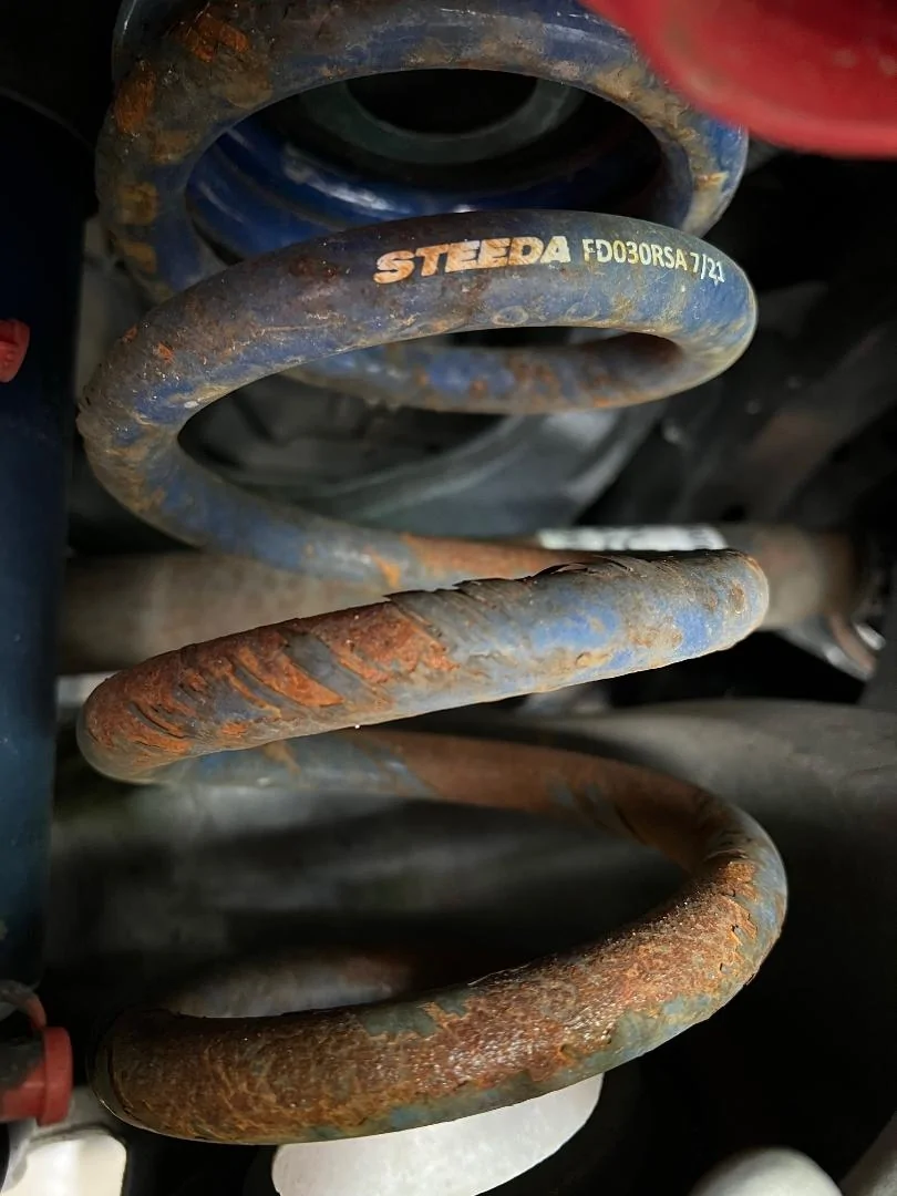

FYI - Corrosion pits are the last thing you want on a cold-wound (high tensile residual stress) suspension spring made from CrSi or CrVa alloy wire. Steeda doesn't warranty corrosion and I've had terrible experience with their springs rusting compared to OEM and other aftermarket suppliers like Eibach, Ford Performance, and BRM. Whatever lowering springs you choose for your desired ride height, keep your spring rates and roll rates balanced front-to-rear to maintain manageable over/understeer characteristics.

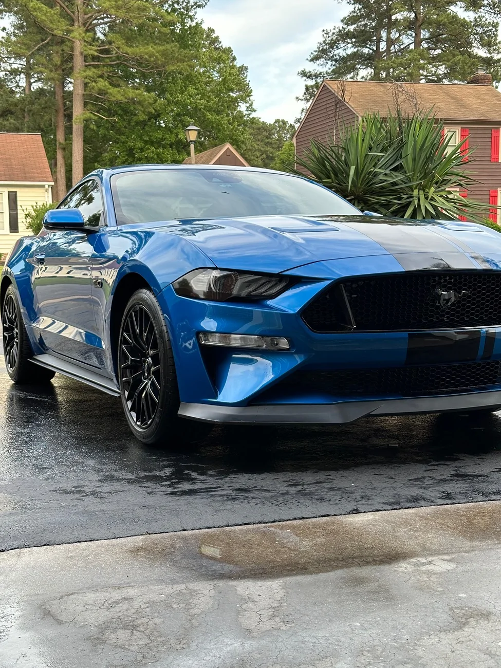

One thing I'm starting to notice is everyone that buys the track kit seems to really like it. Where other suspension kits have mixed reviews. I was mainly worried it didn't lower the car enough, but I have had some people send me pictures of the stance it has and I think it looks really nice.
Feel free to post some pictures of the way your car sits on these springs if you want. Maybe this thread can help others out in the future.
I have pretty much decided I'm going to buy the track kit at this point and go figure everyone is sold out of the full kit. But I will make sure I right up a review and post pictures of the way the car sits when I am done.
