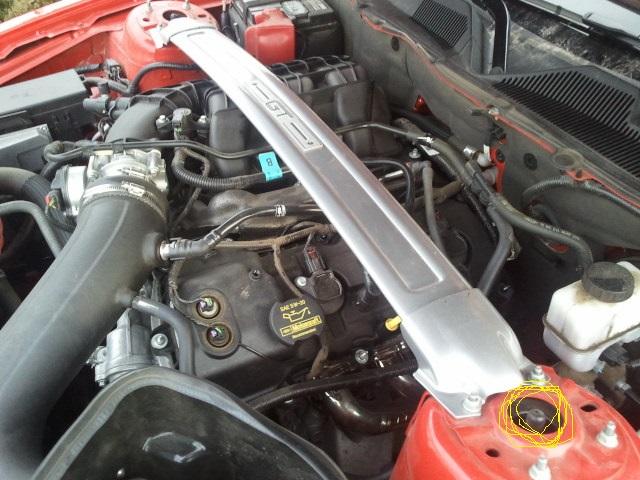

First, the nut that holds the whole strut together backed out on my front strut. Passenger side strut. The center nut of the strut that you can see when you open hood. Going over bumps it would clunk or hitting a pot hole at slow speeds clunk. Highway speeds no issues. I put some blue Loctite on and torqued the nut. Zero issues since.

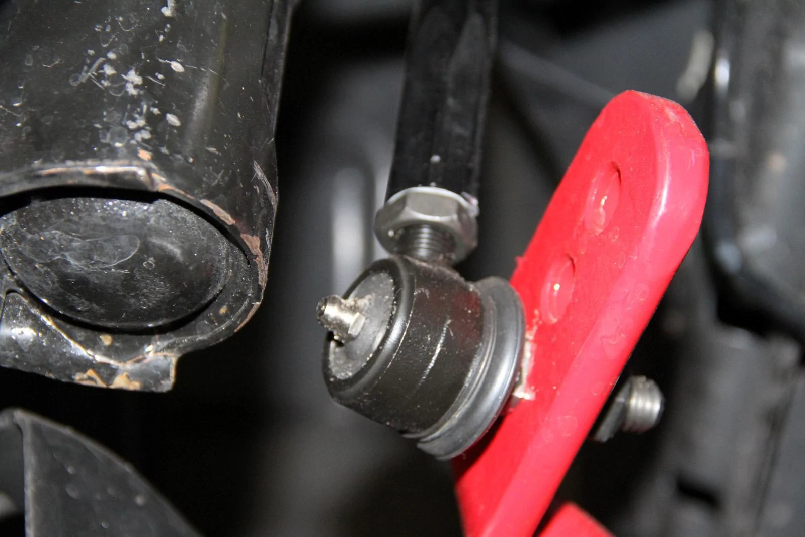

The other issues was coming from the rear but I could see the same issue presenting itself in the front. End link bolt backed off causing some play in the sway bar where the end link met the sway bar. Again, I developed a clunk noise in the rear end.
That's what I have experienced.
Although not my car, the pics below show the areas I am talking about. The yellow circle for the strut and the sway bar issue.
