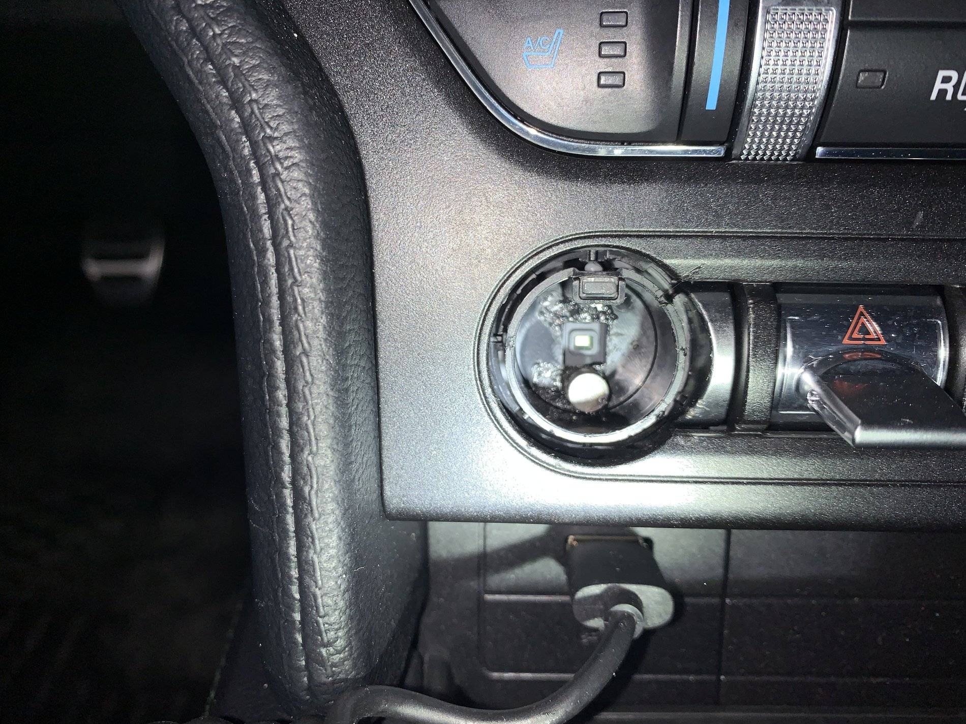

help. i broke my ignition button harness

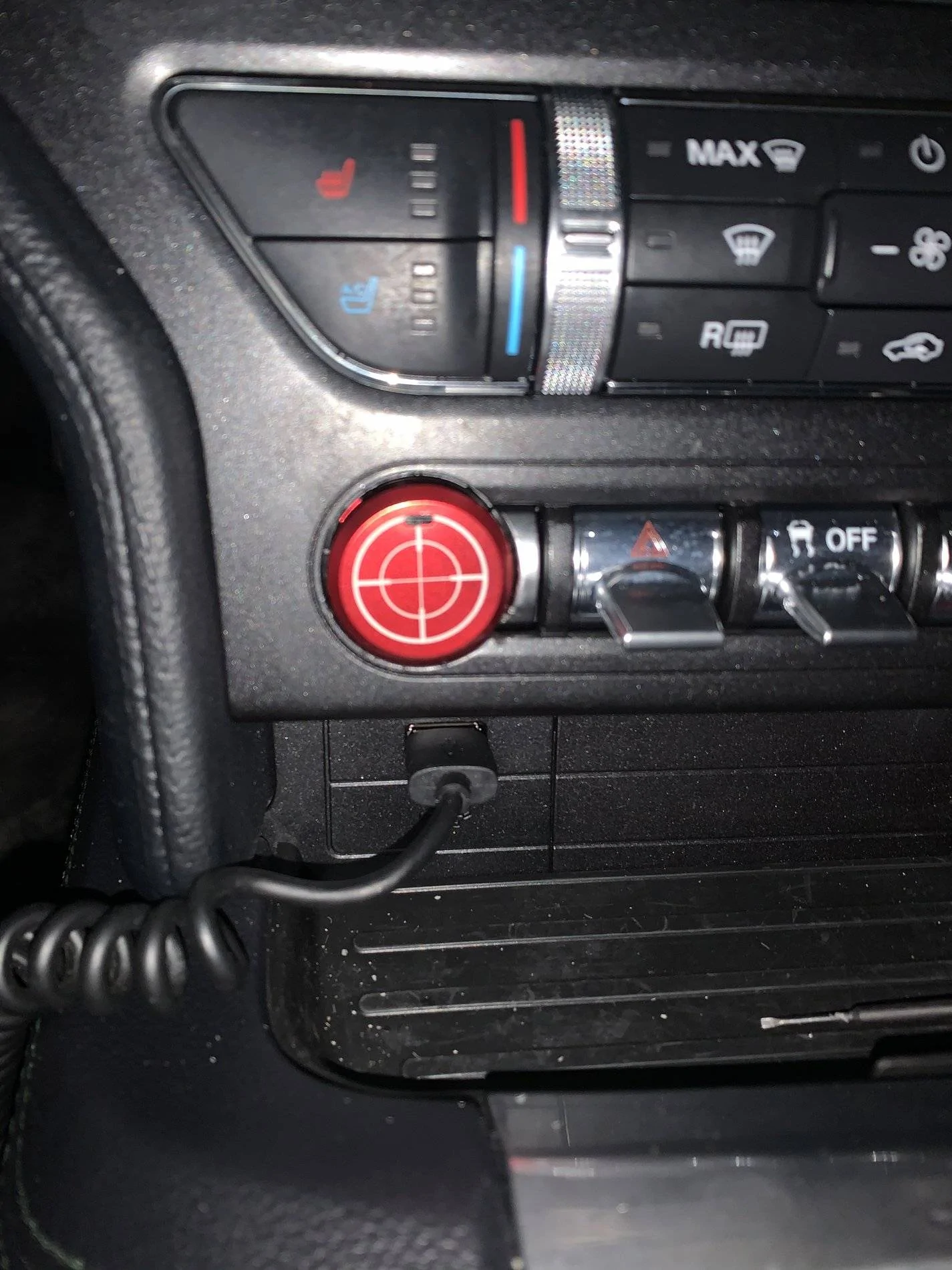

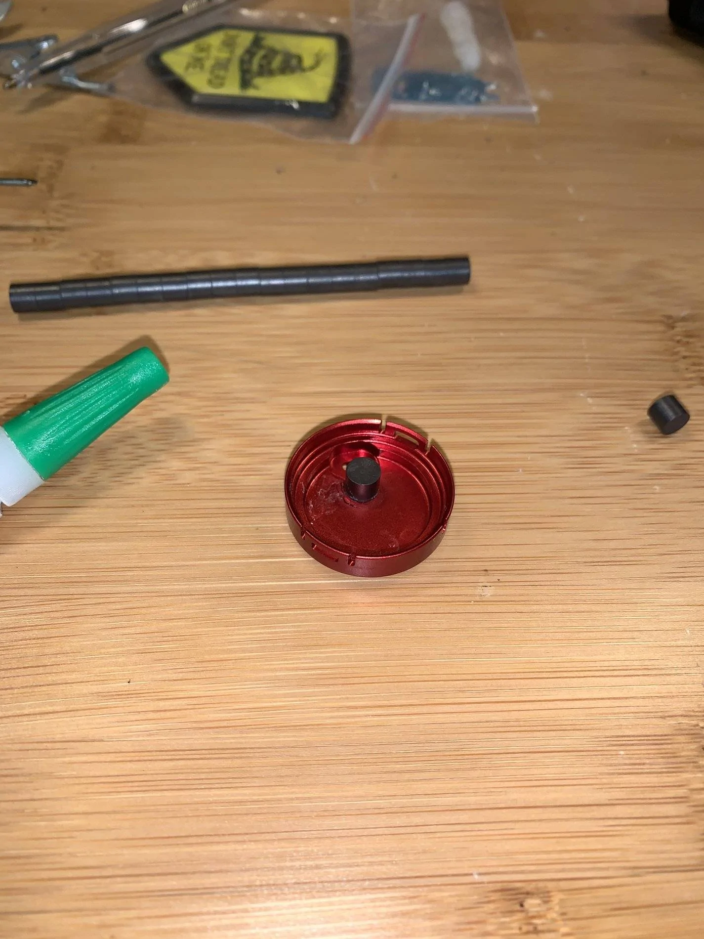

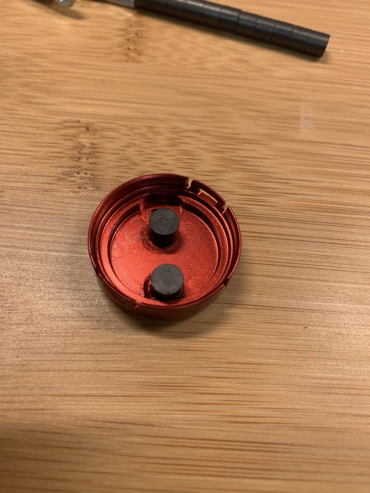

Success!!! Magnets baby. Really sucked getting them in there (since they are attracted to each other and the devices you would place them in there with). Plus super glue can make the Pope curse. But it’s good enough.

Nicely done. And the car starts and all that?

Way to go Doug. Awesome job. Where there’s a will, there’s a way!!

Great idea there! And you've left yourself the option to change it again if you find another button you like. Really ingenious idea!

If the magnets don’t work try a couple small dabs of silicone.

The magnets are a great idea. I bought the red start button and got a bit scared after seeing you break the clips. But now there is a backup plan.
