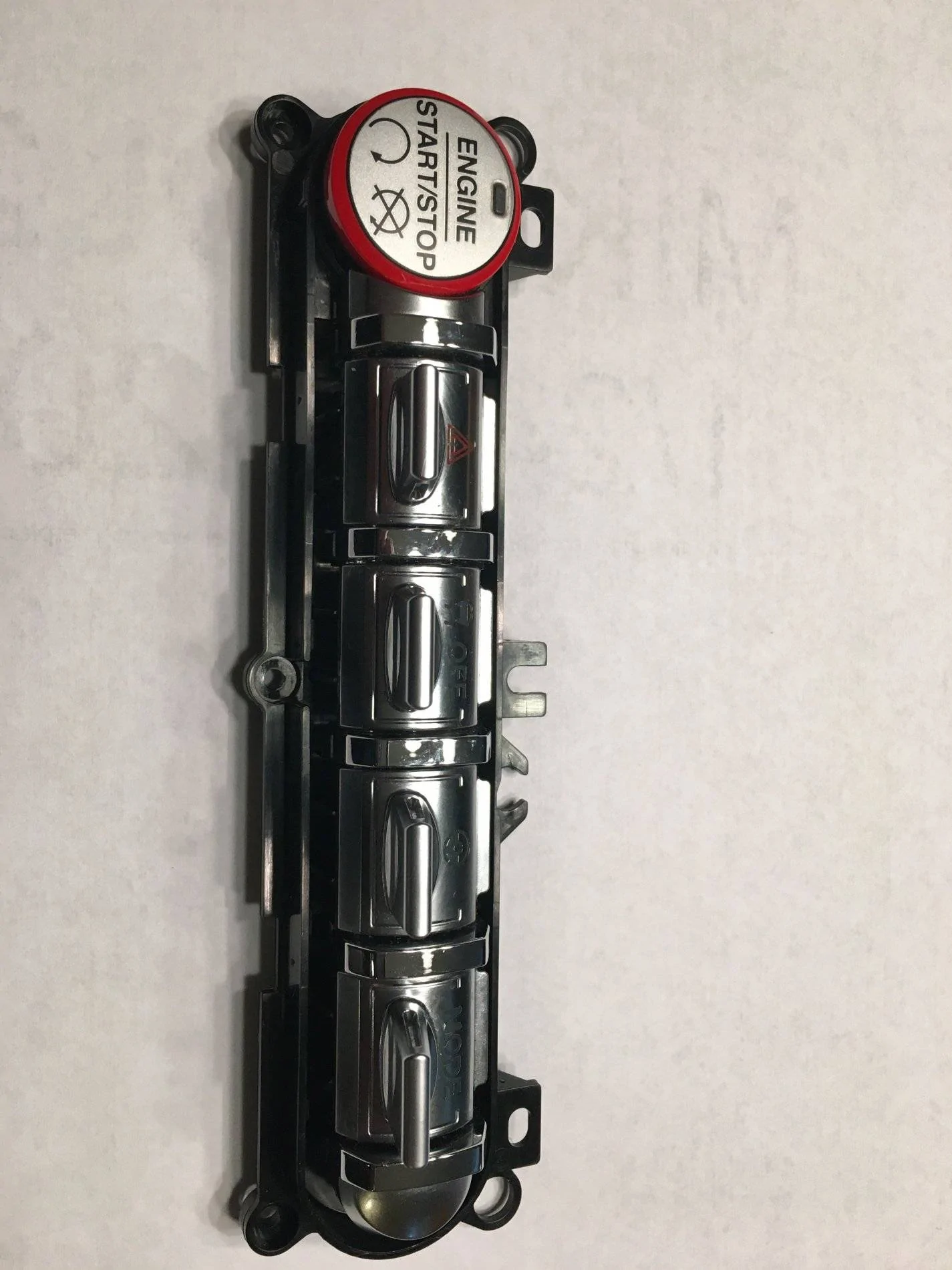

help. i broke my ignition button harness

Looks like you broke the clips the button actually grabs onto, which sucks. You'll need a new bezel surround to properly fix that, and they're not cheap. Even used they're like $350.

Doug, I’m thinking a new switch is in order as that is what the cover attaches to. That said, I searched like a demon and couldn’t find a damn thing about start switches for S550 Mustang’s. So now I’m thinking ice445 is right and the switch is integrated into the panel. Oh Boy!

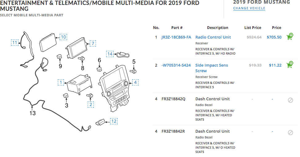

OK, did a little more searching but you are not going to like what I found. It does appear that you will need to replace the "Dash Control Unit" (or the bezel like ice445 said). The bad news is that all of the Ford parts guys are showing is as discontinued.
Here's one I found on eBay.
https://www.ebay.com/p/927085331?ii...MIxvX9qb7N6QIViY3ICh0UjADOEAQYASABEgJj_fD_BwE

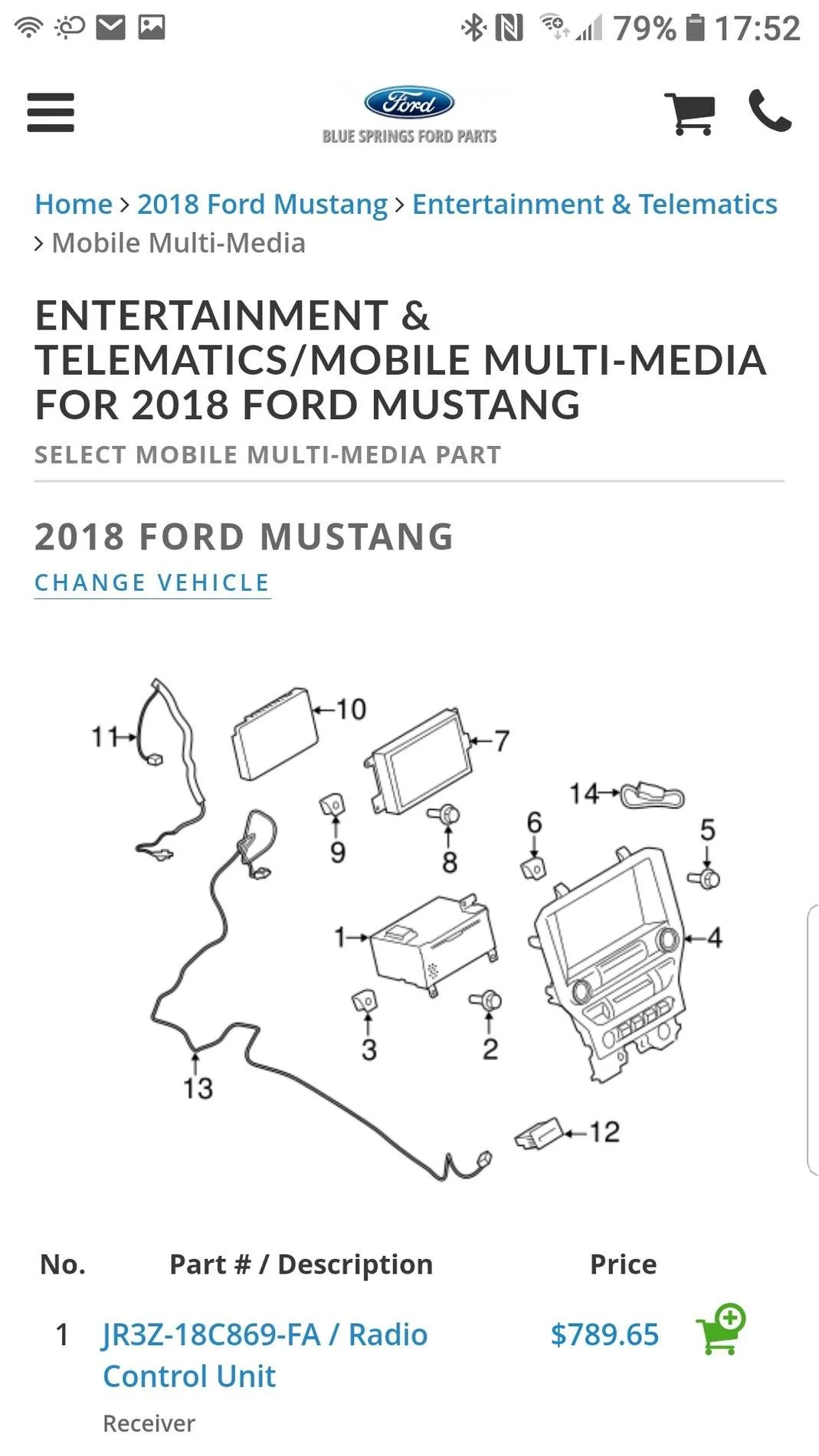

I looked too and I'm pretty sure the switch is part of #4 in the attached page out of the Ford parts diagram. Unfortunately there is no price listed. It's from an '18 but I doubt newer is much different.
Being as yours is newer and a Bullet the dealer is probably going to be your only recourse.

If i could even find it. I don't know why I'm not googling it. simply can't find it
I agree with the others. Tape or glue it and never look back. Shit happens.
thanks - I just saw this

Someone in the classifieds is selling used ones from a 19 and a 20. I think it shows as discontinued because it was superseded by another version but I'm not sure what part number that is.

found a pic of what I really need:
