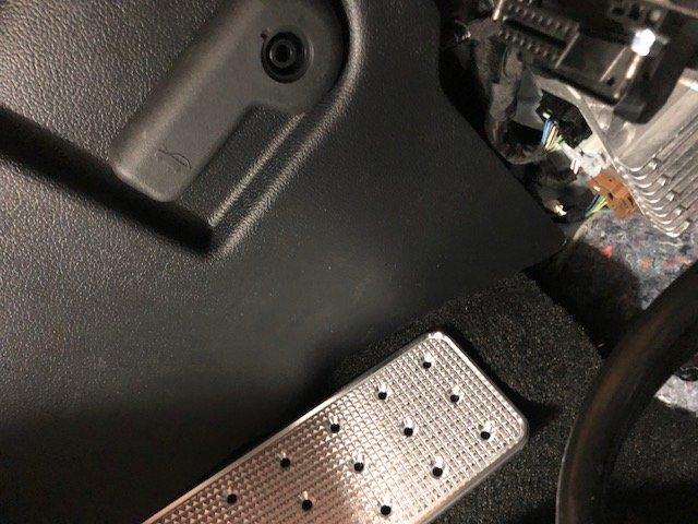

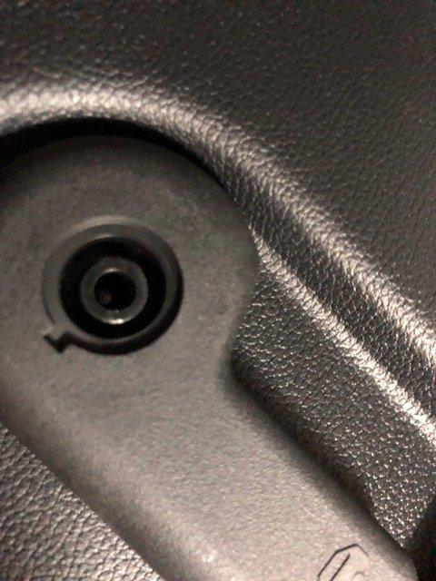

hey guys need a little help!
I am installing SRP pedals and want to install the dead pedal with nuts and washers on the back side of the carpet and need to remove the side panel behind the hood release lever and cannot figure out how to remove it.
Does anyone with experience know how the lever is removed gentle persaution has not helped and I dont want to break it.
Any help would be greatly appreciated pics attached.

Find a socket that will go over the inner circle. Press it in and pull/jostle the lever.

Thanks that worked

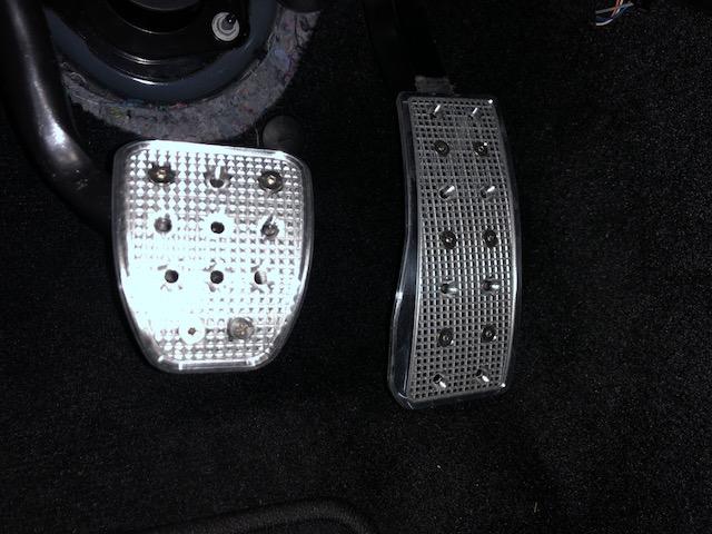

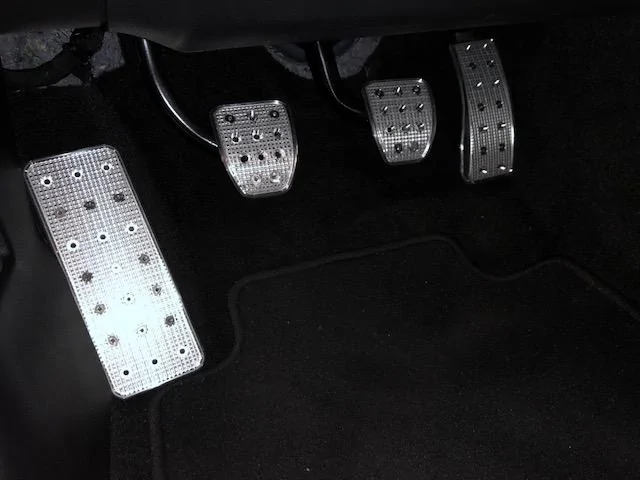

Here are a couple of pictures of the pedals installed. I decided to mount the dead pedal to the original pedal after grinding it and sanding it flush took all the bumps off of it. Decided not to drill into the carpet or bild a spacer to fill the vacant area of the stock dead pedal. Works great and feels good heal toe is much easier now.

Thanks. I was struggling with how the dead pedal would like up squarely and look right. Its so much larger than the original it didn't seem to want to sit in the space correctly.

Not slippery at all they have very good traction due to diamond cut pattern, I would not have changed the pedals if I could have found a matching factory gas pedal that was wider but I really do like the SRPs after putting some miles on them now.

Yea you need to play with it a little and I also trimmed about a quarter inch off of the side panel so that I could put the dead pedal as far left as possible so the right side would fit properly. Drilling the factory brake and clutch pedal is a bitch and you need to be perfect as there is no room for error.
