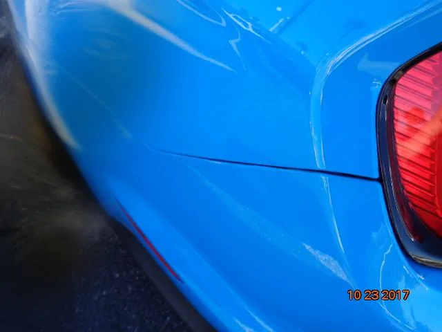

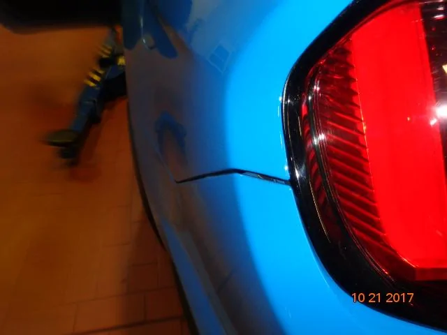

Hey guys i have sesrched and found multiple threads on rear bumper gaps.
I have ordered some new brackets and was wondering if anyone has link to remoal install video or if someone could post the repair manual on rear bumper cover removal?
I know this is not a hard thing but would like to know were any hidden clips etc are.
Any help would be greatly appreciated,

How bad are your gaps? Post pics. 350 bumper gaps are a right of passage. Embrace them. LOL

I will post before and after pics tomorrow.

Thanks I was not able to completely remove the rear bumper cover I even looked at these instructions I could not get the rear of the bumper to come off it states to pull really hard I did but it felt like something was going to break. I was able to replace both side brackets and it improved the gaps but I know it could be better if I would have been able to get the bumper cover off. I feel whatever is holding on the bumper that bracket needs to be raised slightly so that the weight does not cause the rear to sag.
I will figure out what is preventing me from getting the cover off and tackle it another day.
At least the gap closed up a little and is not as noticeable.
FYI all of the screws for the brackets were loose along with the nuts that hold the fender liner in place were also loose.
