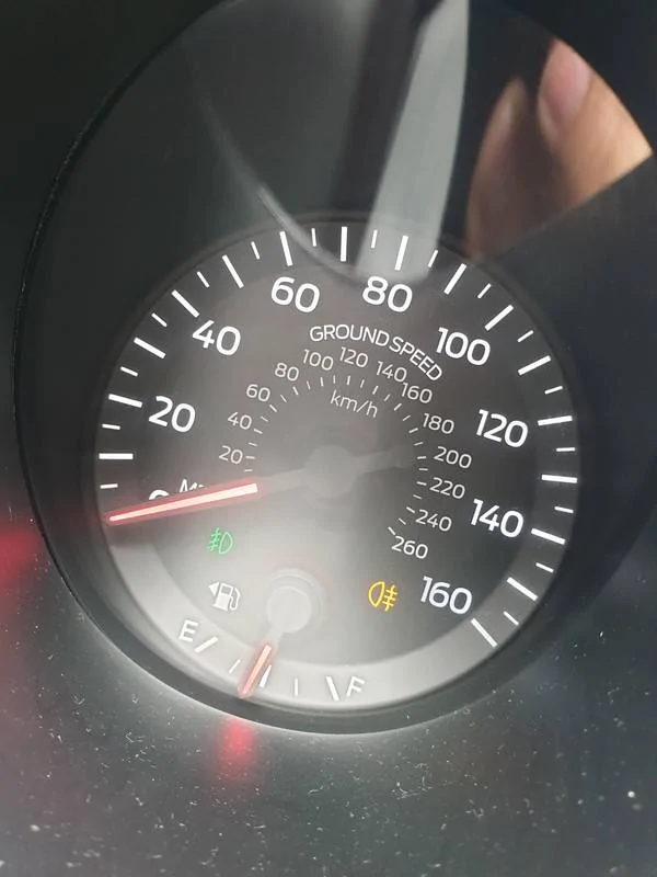

I need help to fix problems on ipc Module or in dashboard!!
Ford Mustang Ecoboost 2.3 2015
The problem start after refill full fuel tank, it's showing only half level while i its full! As you see in the photo!

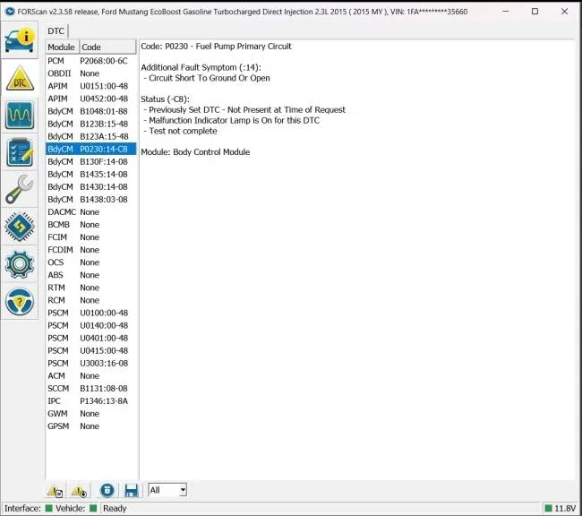

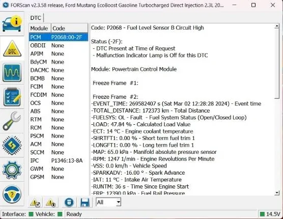

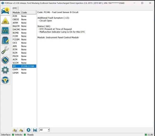

I have contacted the forscan to read errors code and found this following codes
Code P0230 Fuel pump primary circuit
Code P1346 Fuel level sensor B circuit
Code P2068 fuel level sensor B high circuit

Look under the driver side rear seat. There is a bundle of wires. See if a mouse has eaten some of them.
Mustang_Ak47
Mar 7, 2024
Germany
Yuosif
Ford mustang ecoboost
Okay, i will check)) thank you for your reply
