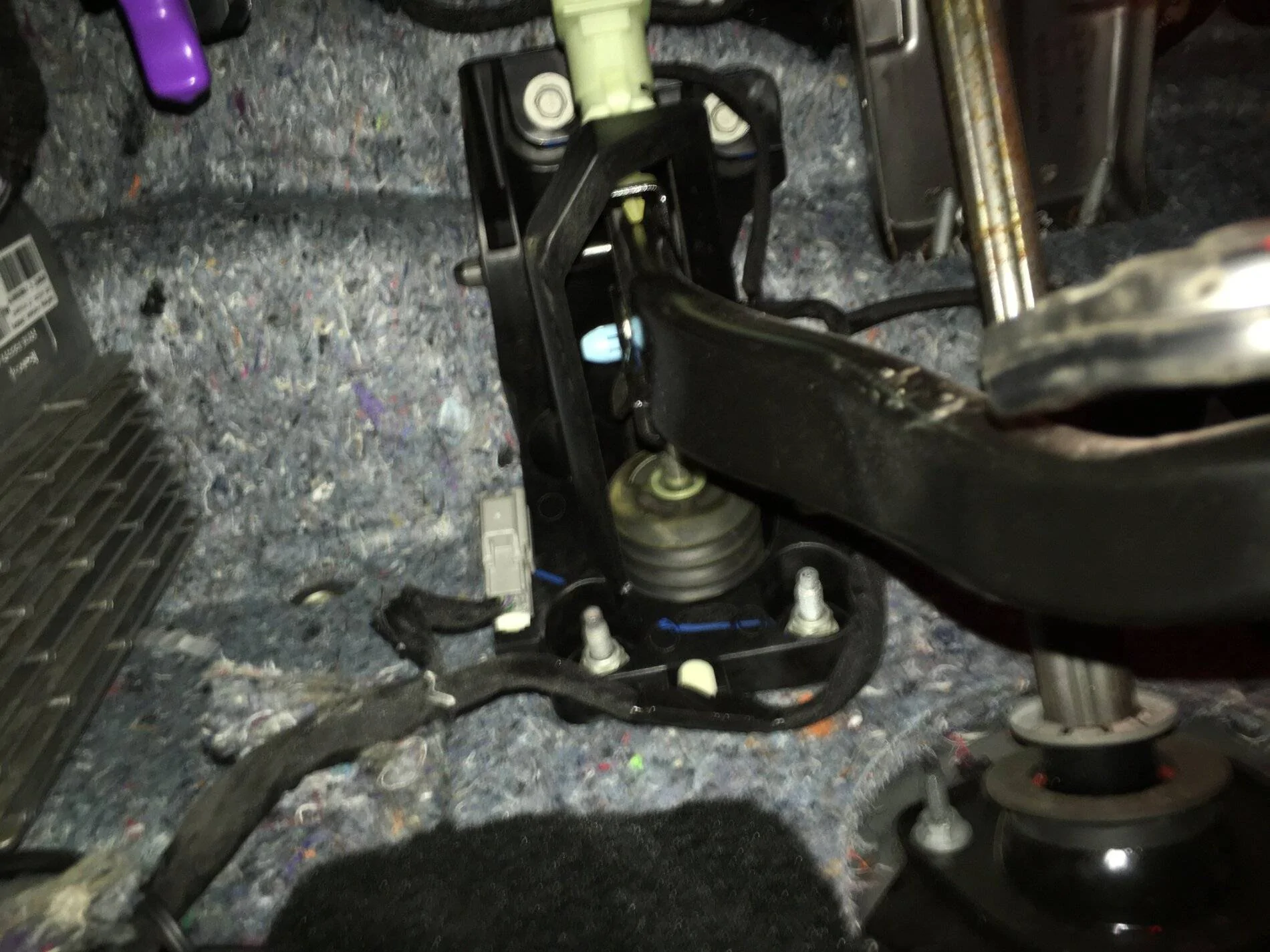

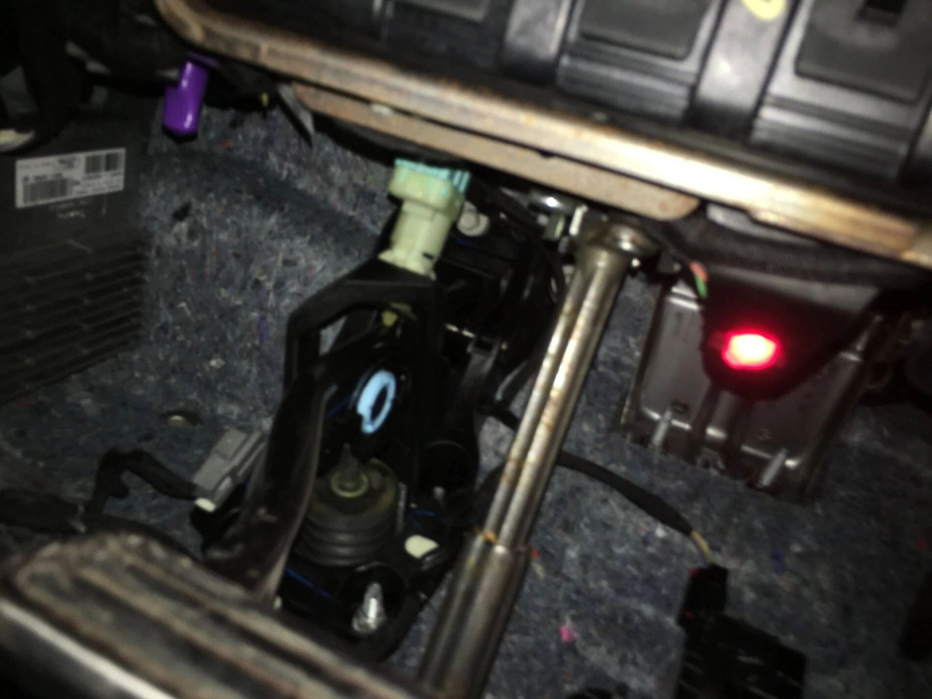

By the way, I just updated my cars Sync to recent 3.0.2. But it didn’t help my dash. Also I checked the cables on drivers seat side and it looked good to me.

One more idea may be to see what happens if you disconnect the dash, as you seem to have already made your way to the cables? If there are no new problems that occur after you disconnect the dash and drive as normal, I'm thinking there's less reason to worry that an update done by the dealer on a dash that may be broken will cause problems, as in the worst case scenario, you will simply disconnect the dash again and drive with it disconnected.
