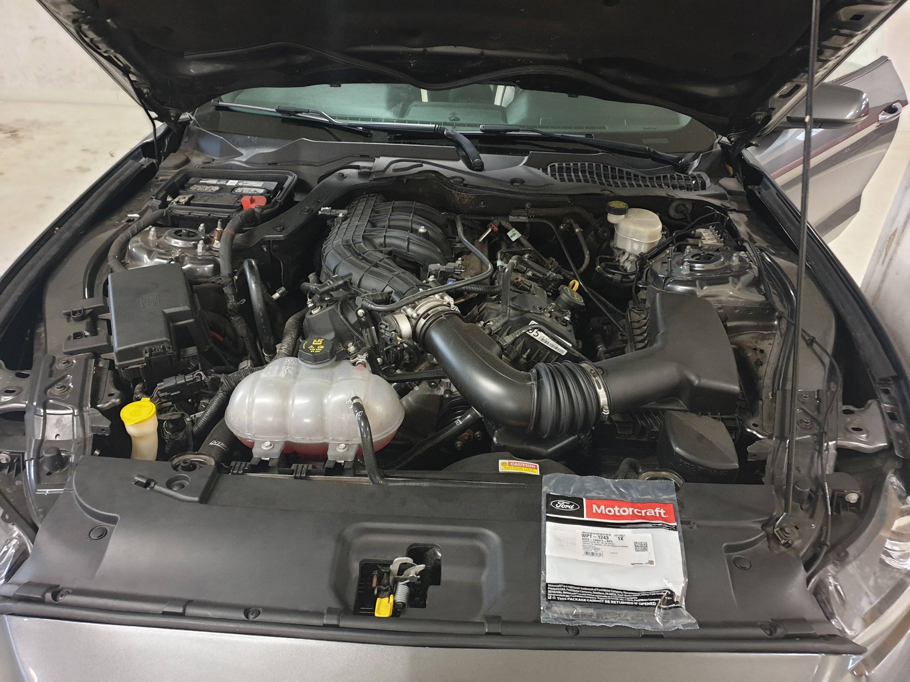

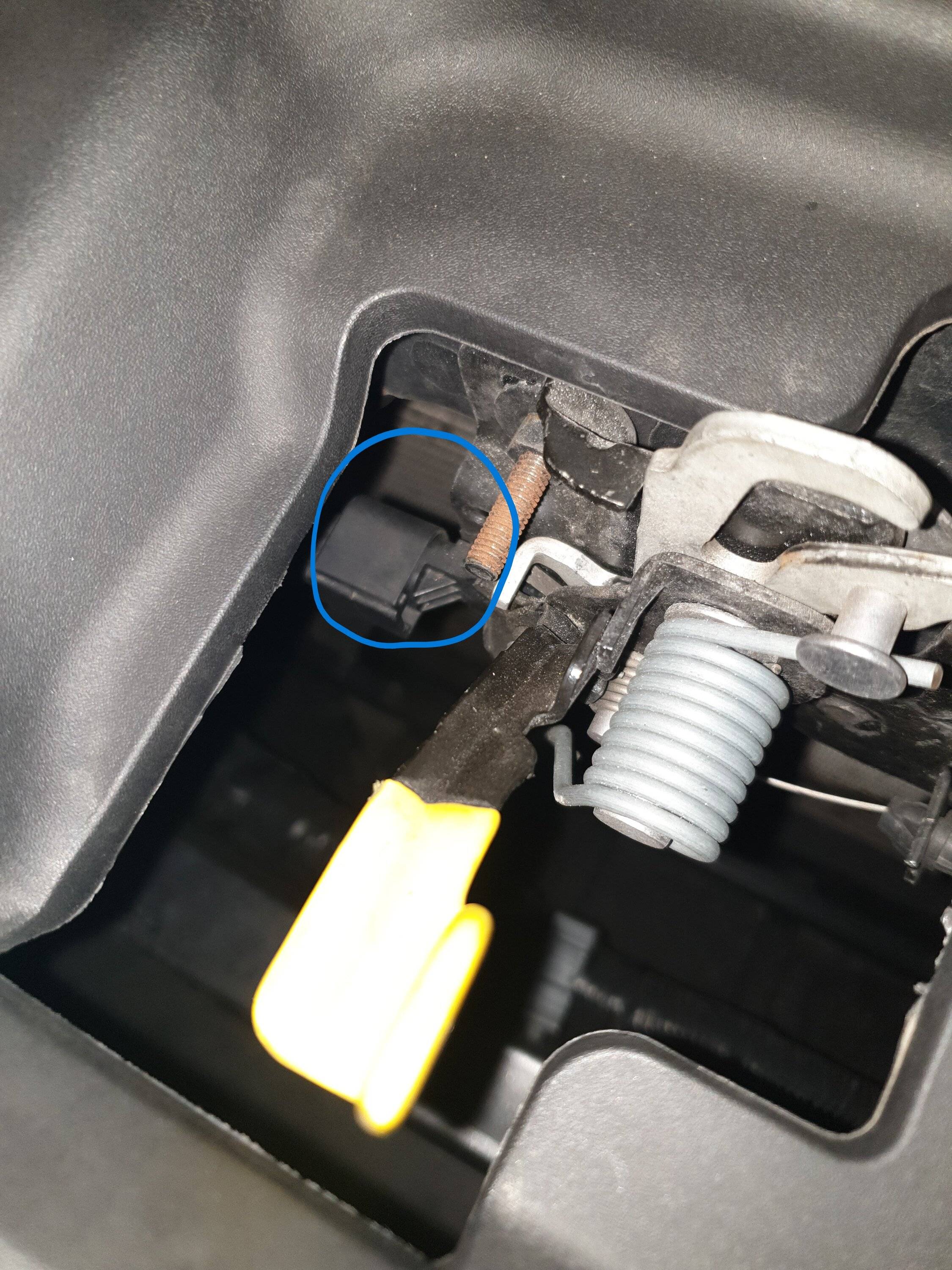

Hi, I've bought hood ajar sensor and i will change it.
Where is it located?
Is it correct connector on second photo?

Is it correct connector?

I've changed ajar sensor, but still same :-(
