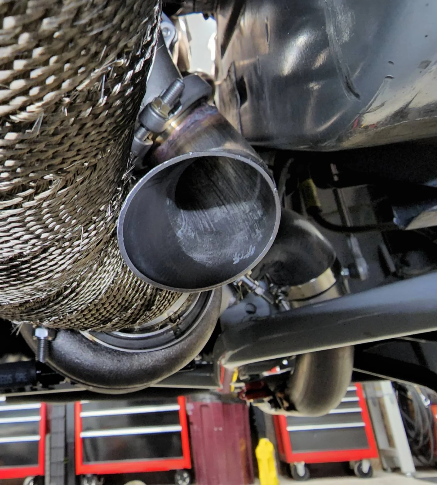

So I just finish installing my kit but it seems the charge are to low for my liking. What are you guys doing to to fix this problem? Different touring? This is for an 18 mustang, pic for attention, lol

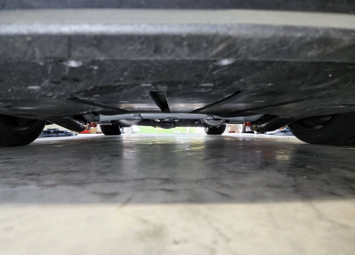

Loosen everything and push up as much as possible. You can bend the tabs some and gain a little bit. My car is lowered on bmr springs with 20" wheels and slightly taller tires and I've only ever hit the pipe twice lightly. Iirc it was some weird angle pavement or something.
Initially I thought about re-welding the mounting tabs in a different place and cutting off some of the pipe where is connects to the turbo, but it's been fine.
