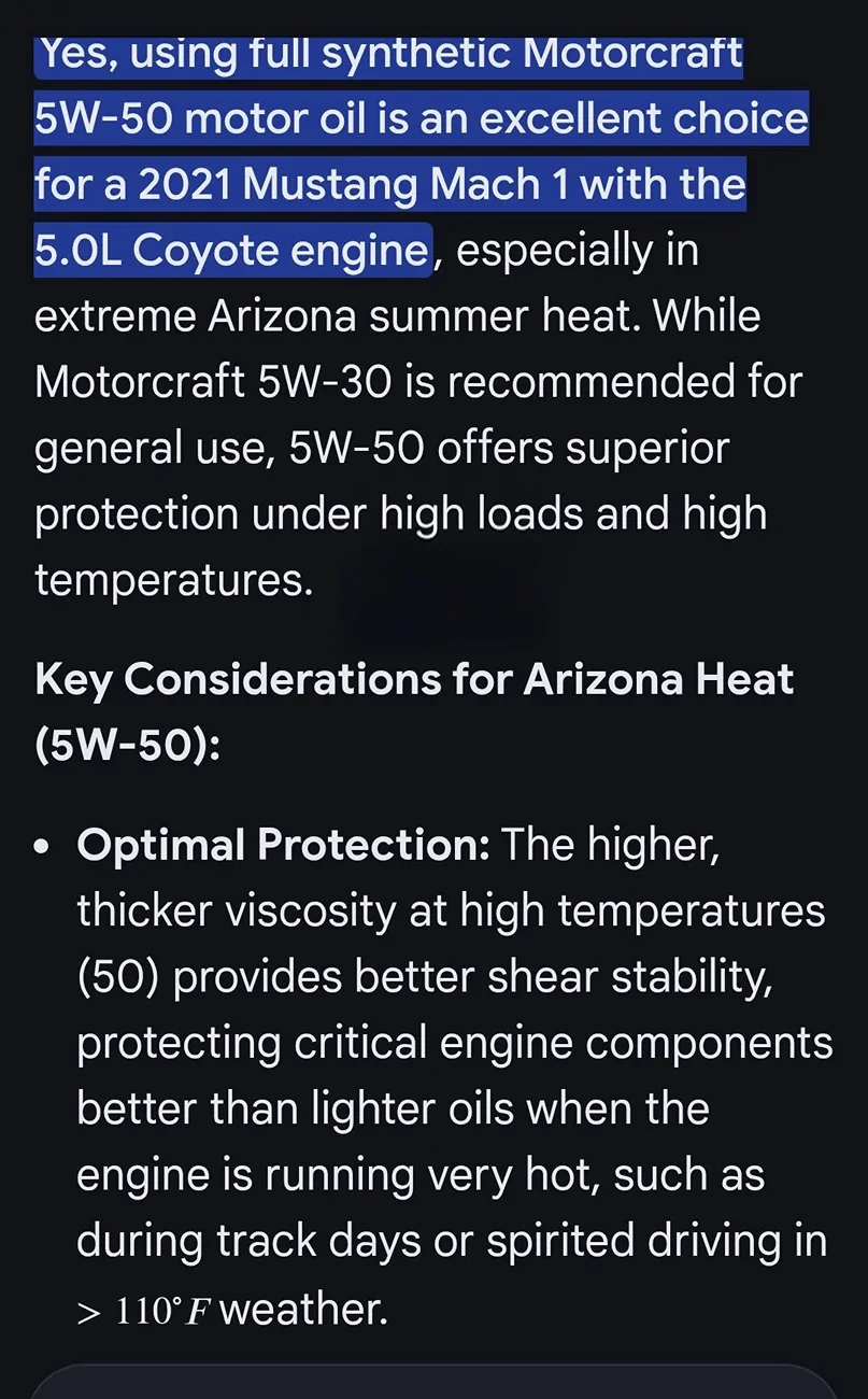

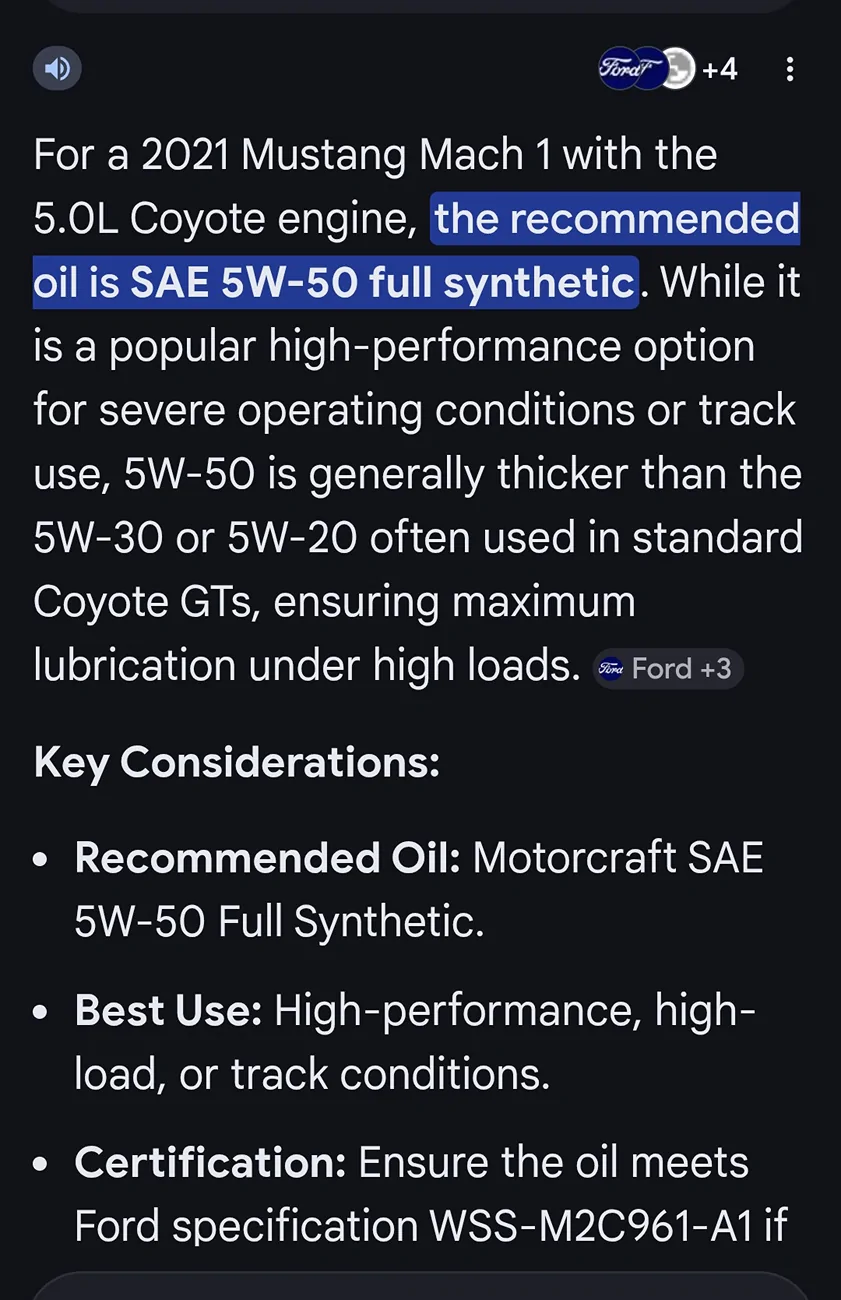

I use Motocraft Full Synthetic 5-50w March thru September and 5-30w Oct to Mar.
Not sure where Masshole is, but living in the Central Arizona Desert April to September the ambient temperature range 85 / 95 April ,May to September 100/ 110 and above to 115 , I'll use 5-50w

Thank you for your input to this Thread , I am no oil specialist . My personal preference to run 5- 50w FS in the Summer Arizona Desert Heat doesn't cost any more per case that 5-30wFS as of 4-6-26 ,I hope in the future that doesn't change , you know .
I do spirit around , although the engine isn't under the loads of full out racing . But the under hood temperatures when I open the hood to let heat escape, feels like opening an oven door on broil. I think I'll purchase a infurred thermometer , I'm curious to the under hood temperatures.
