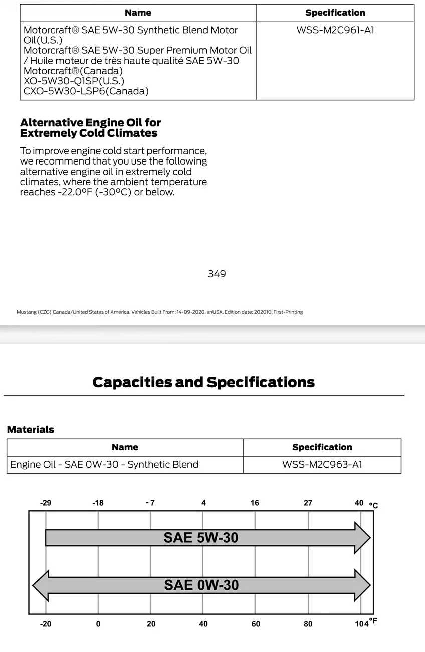

Some more detail would help with the discussion.
What Model Year is the car?
Does it have any modifications to the engine or drivetrain?
What is the primary purpose of the vehicle? DD, track, drag strip, etc.
What weight and brand of oil are you using now?
What brand, type and octane of fuel are you using?
What temperatures do you anticipate seeing this Summer?
How often do you change the oil? Or do you use the OLM?
Why do you want to use a heavier weight oil?
Thanks.
