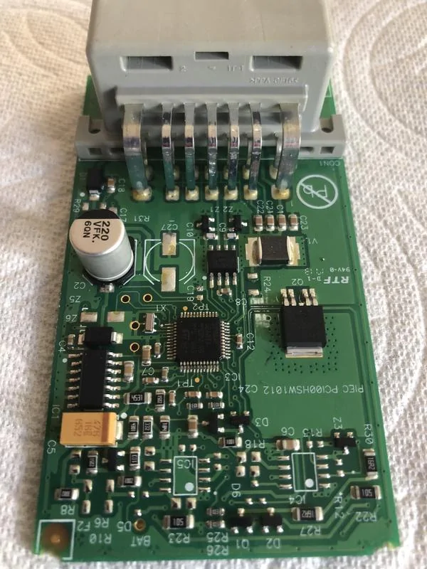

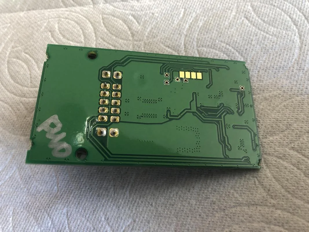

This mod has proven quite difficult. I’ve involved people much smarter than me that have great knowledge in regards to coding and a positive outcome albeit in different cars other than the mustang.
I currently have everything connected (HSWM, harness, heated wheel and airbag, SCCM, all coding with multiple changes for hopeful outcomes) and still no workie. The heated button is on the sync3 screen and has touch function but does not activate the wheel. I know everything is connected physically correct because when I run a HSWM test though forescan, it actually heats the steering wheel and I can feel it especially when I run the test back to back.
There are not a lot of other parts that interlink with the whole process. I even tried changing the GWM that had 18 firmware and that didn’t help but was only $30 to try. With all this trial and failure, the next step is to try an 18 FCIM which is the whole surround of the sync 3 screen and this is not a cheap part. It is also so far not easy to source. No dealer can give me a price nor can they just order one which is somewhat baffling so I’m currently waiting for a wrecked 18 with 401a package.
