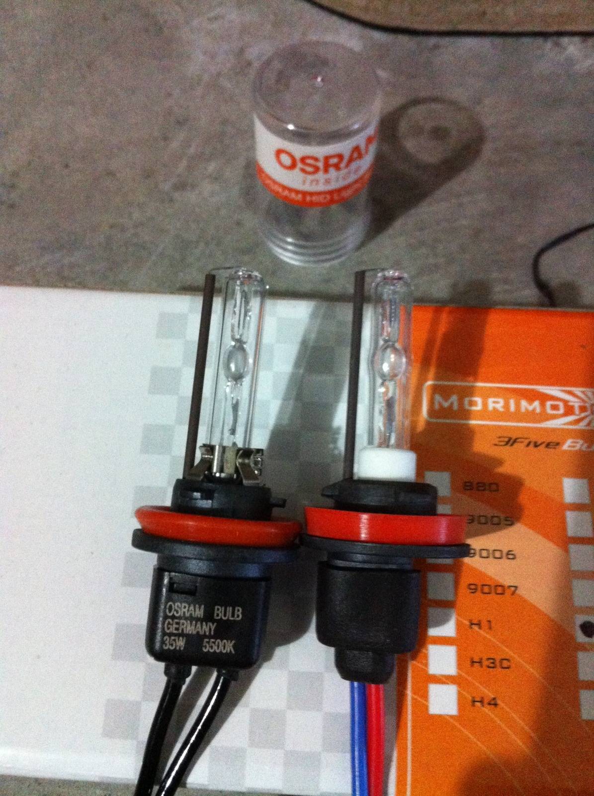

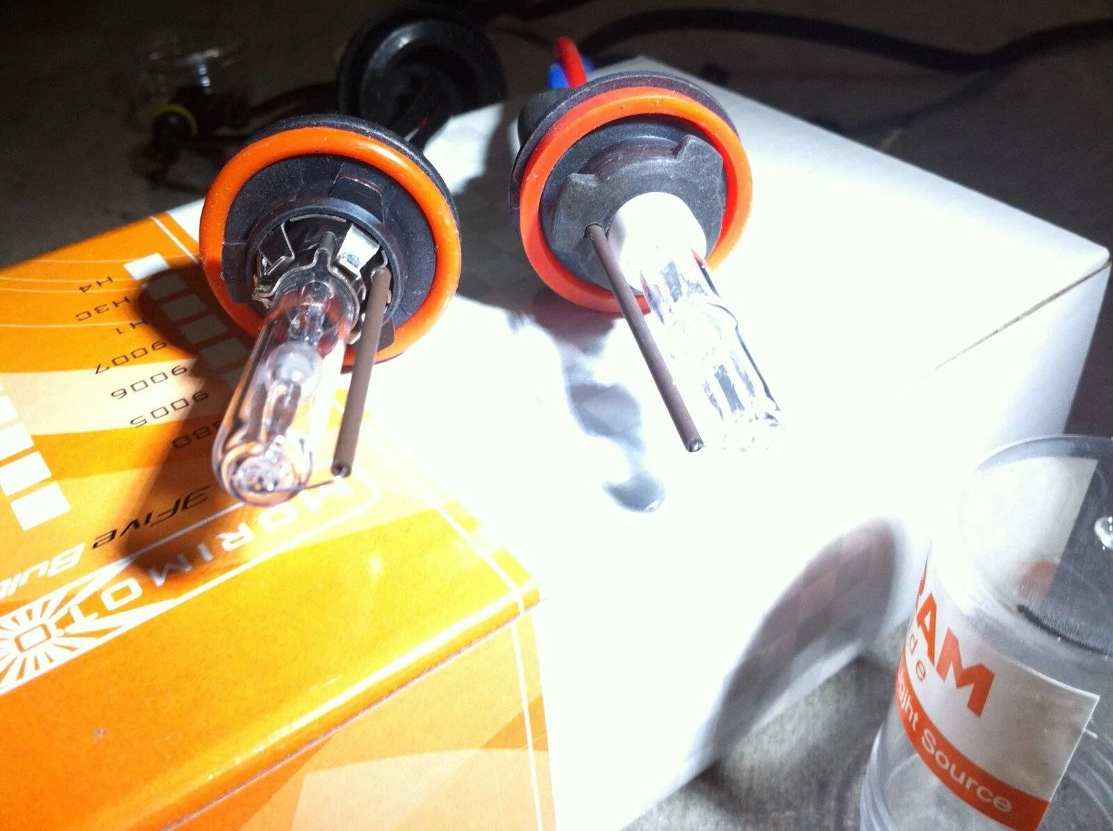

In an HID system, the bulb is not the determining factor like a standard halogen system from a power output perspective. The ballast controls the power supplied to the bulb. If you put "55w HID bulbs" in your car, it would change basically nothing. If you put 55W ballasts, that would be when you needed to look into a harness and a dedicated power supply. that being said, installing a 55w ballast is not practical, as any kits you may find that claim to be plug and play including a 55w ballast for our cars would likely be cheap chinese junk and not worth the cost. I haven't seen how the ballast mounts on the mustangs, but on my F150 it was mounted directly to the cover on the headlight assembly itself and not something easily swapped due to size and shape related mounting constraints.
there are options for changing bulbs to get different color temperatures, just keep in mind the higher color temperature, the less usable light output is available. OEM should be 4300k. I find 5000k best for my eyes at night. Any more than that and it starts to get blue, which reduces visibility. Also keep in mind that OEM branded bulbs (Osram, Philips, etc) quality will far outweigh any aftermarket brand (morimoto, xenon depot, etc).

I'm assuming those were in either a halogen reflector or halogen projector? Halogen headlights are not designed to withstand HID bulbs and will eventually lead to problems. Even halogen projectors you can burn the bowl and end up with poor output.
