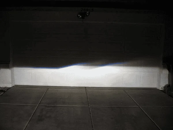

That's required by EU regulations.
In EU it is required to have "asymetric light" to light op the road further in the side of the road you're driving to be able to see pedestrians or other "soft objects in traffic"
Left is flat beam - right is asymmetric
Also for 15-17 cars, HIDs of a certain lightoutput require Headlight washers and auto-leveling. That's why ford put in some lower powered ones in the european cars. (not required for LED)
And due to some visibility regulations 15-17 had no illuminated tri-bars in the headlight (which could be reprogrammed in if you like living in the danger zone) for 18+ Ford EU was involved more thanks to the unexpected high sales.
