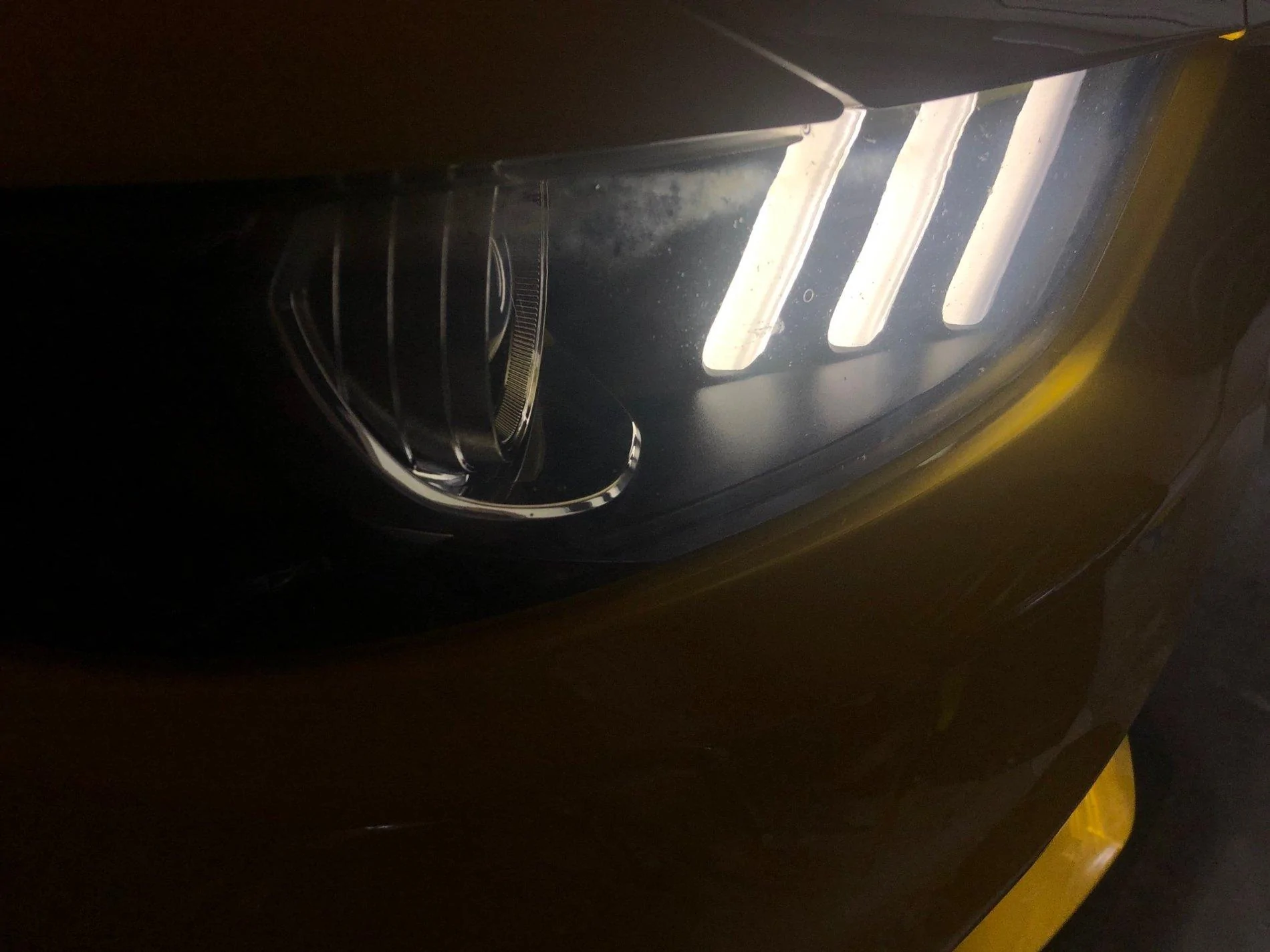

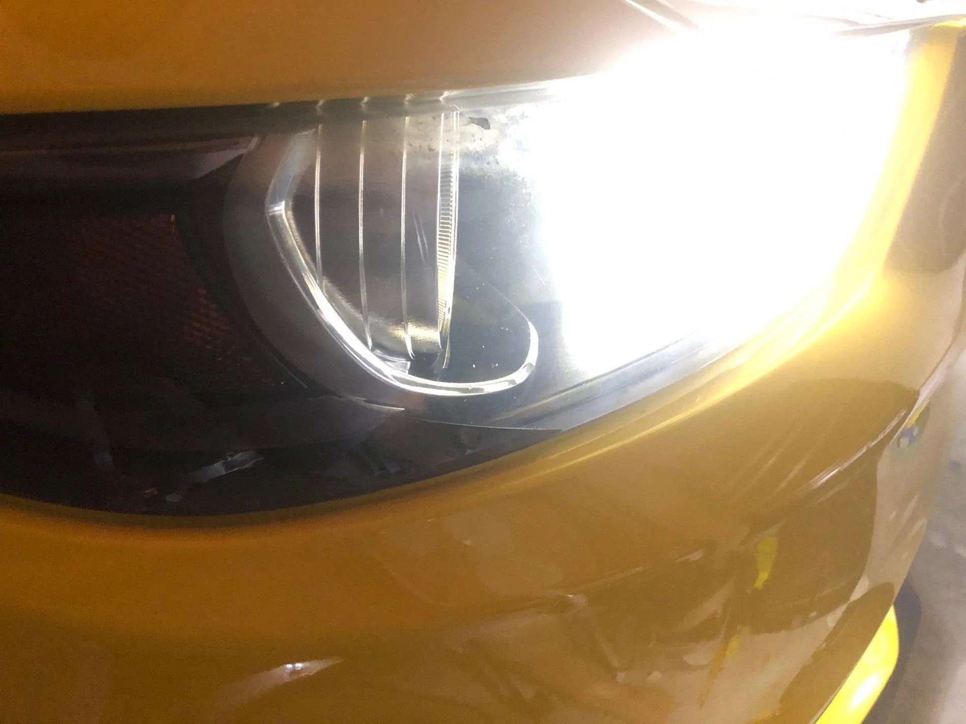

My front headlights on my 2015 have this haze along the top almost like a line but it doesn't really go low or cover the middle or lower half. It also doesn't seem like its on the outside but more on the inside of the headlight housing. Has anyone else had this issue?

I don't think it is condensation from what the OP is suggesting
It is UV damage and inevitable with time. It can be removed by mild abrasive polish such as T-Cut or even toothpaste. Unless the surface is coated with a UV protection film it will quickly return.

It's definitely on the inside of the lens housing. The outside is completely smooth and glossy.

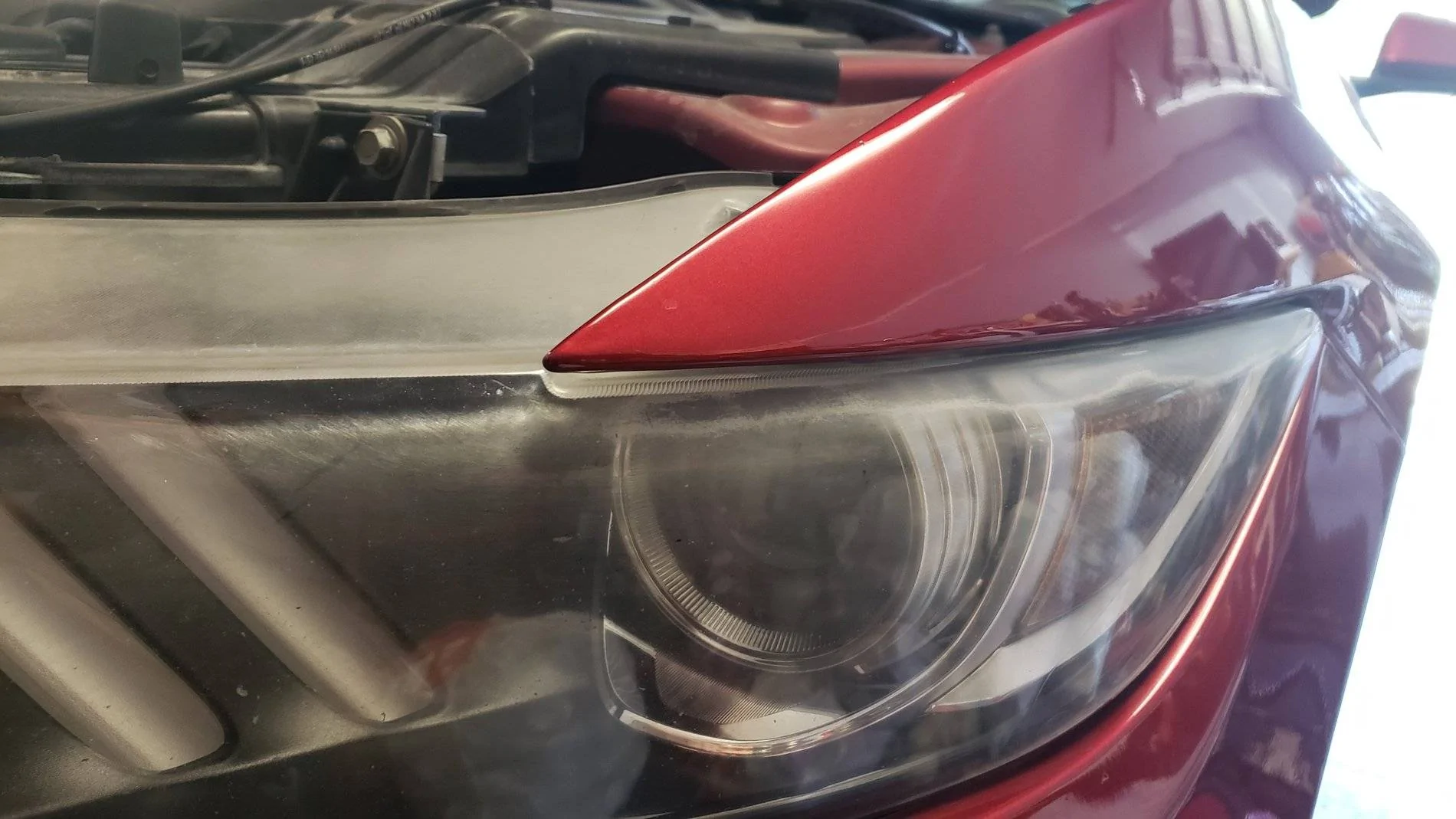

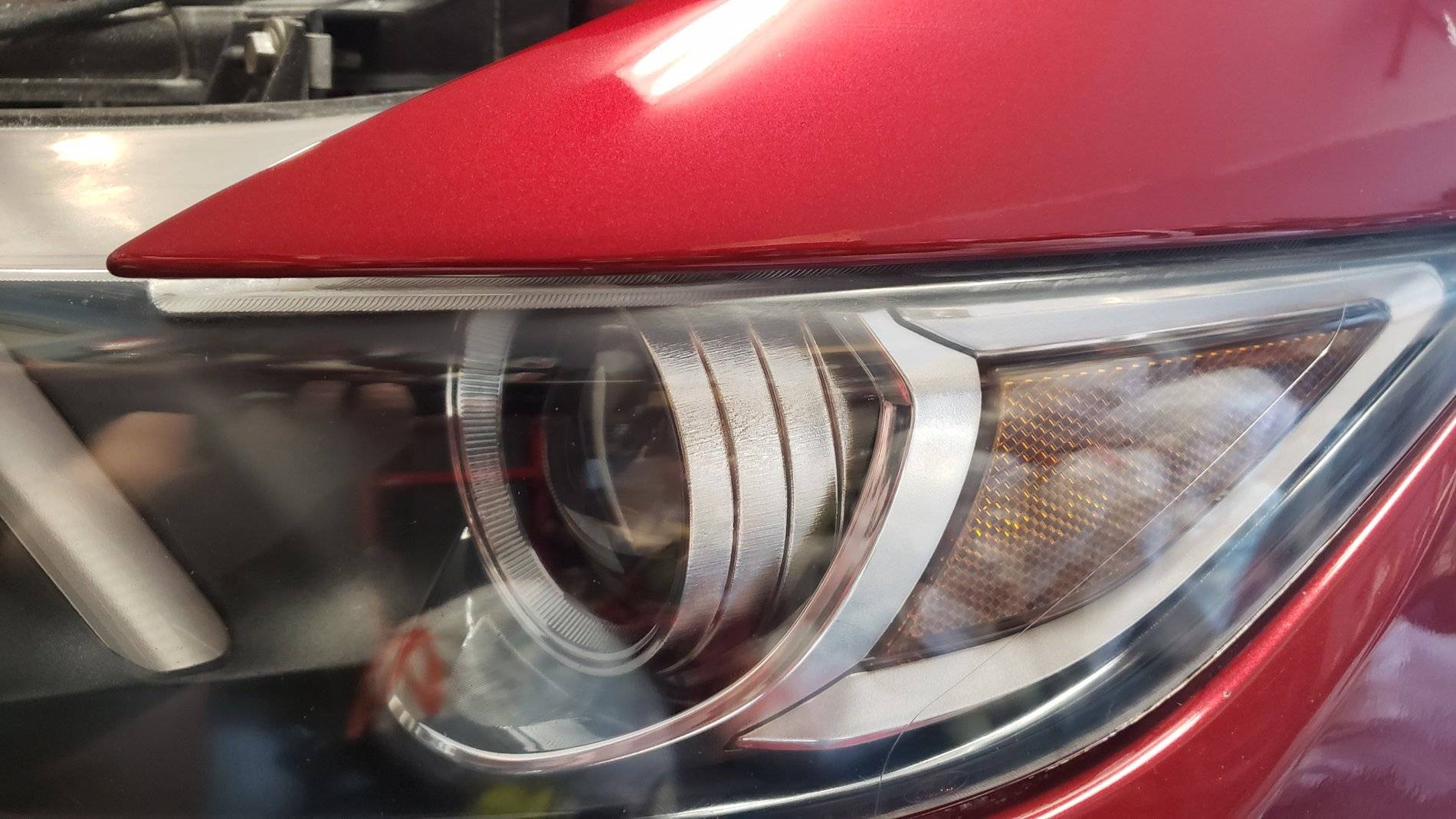

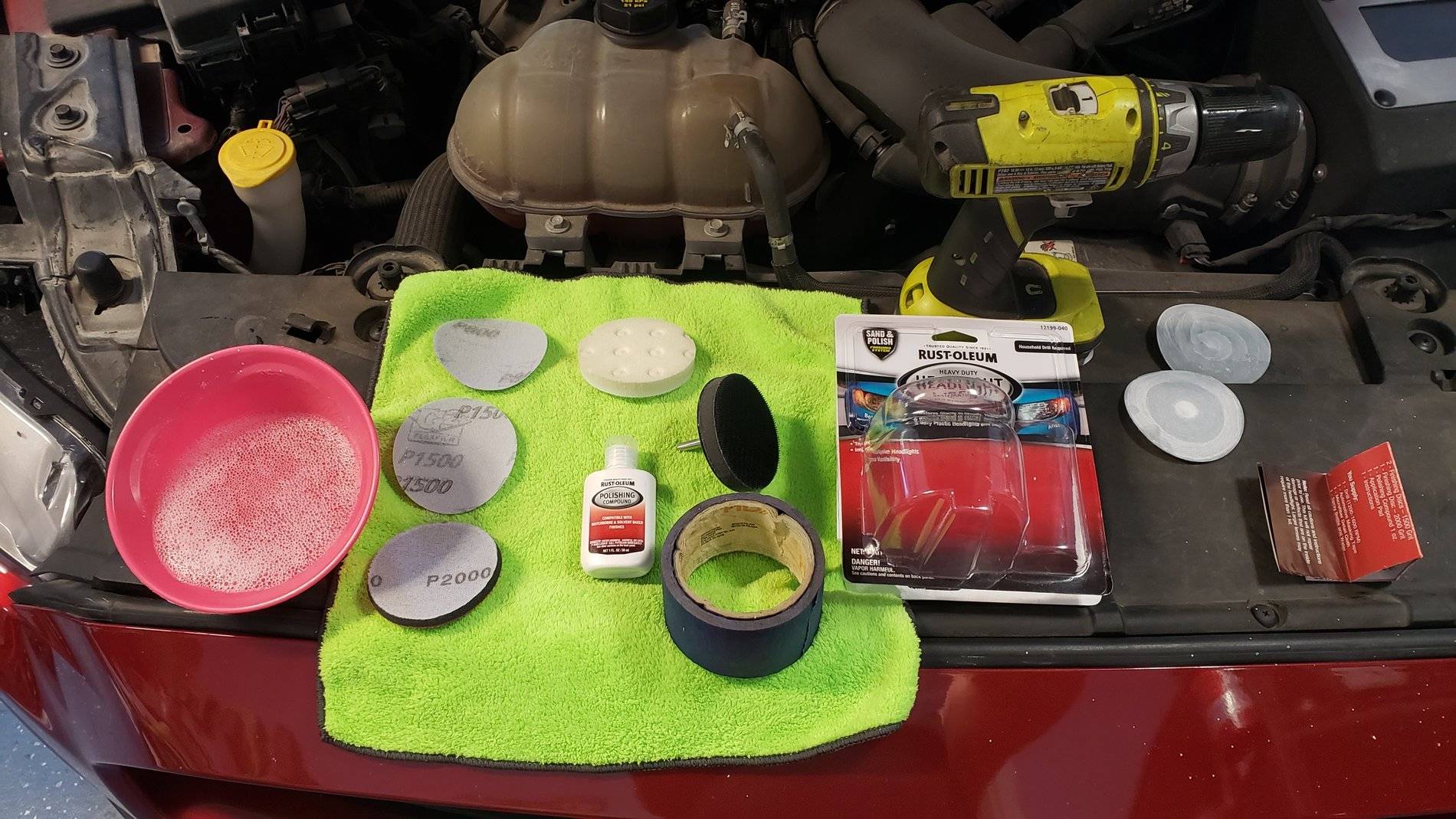

I know this is a year old, but maybe it'll help somebody later on. I have a 2016 and was having the same problem. Then I had the corrosion on the hood that was replaced by Ford under warranty. Now my headlights really stood out. I figured I would try 1 of those headlight restoration kits. Heres some pic and I plan to do a little right up about it with more pics. The white stuff in the lens is the reflection of trash bags in the 2nd pic.
Have you put a UV finish over the top ? If not you need to as it will soon degrade again otherwise.

the little kits for polishing headlights works great but...... they will not stay that way long unless you coat the headlight afterward with a UV sealer and I don't mean the $5-10 stuff either. you need a 2-part epoxy type sealer or a UV activated sealer and neither are cheap. the one I use is about $90 and will seal 20-30 sets (I do headlight restorations as a business)
the best thing you can do is sand down the original OEM UV coating, polish it back to perfect and UV seal them, then after a week or two, put on a clear headlight protective film to protect them from sand/rocks and road crap.
