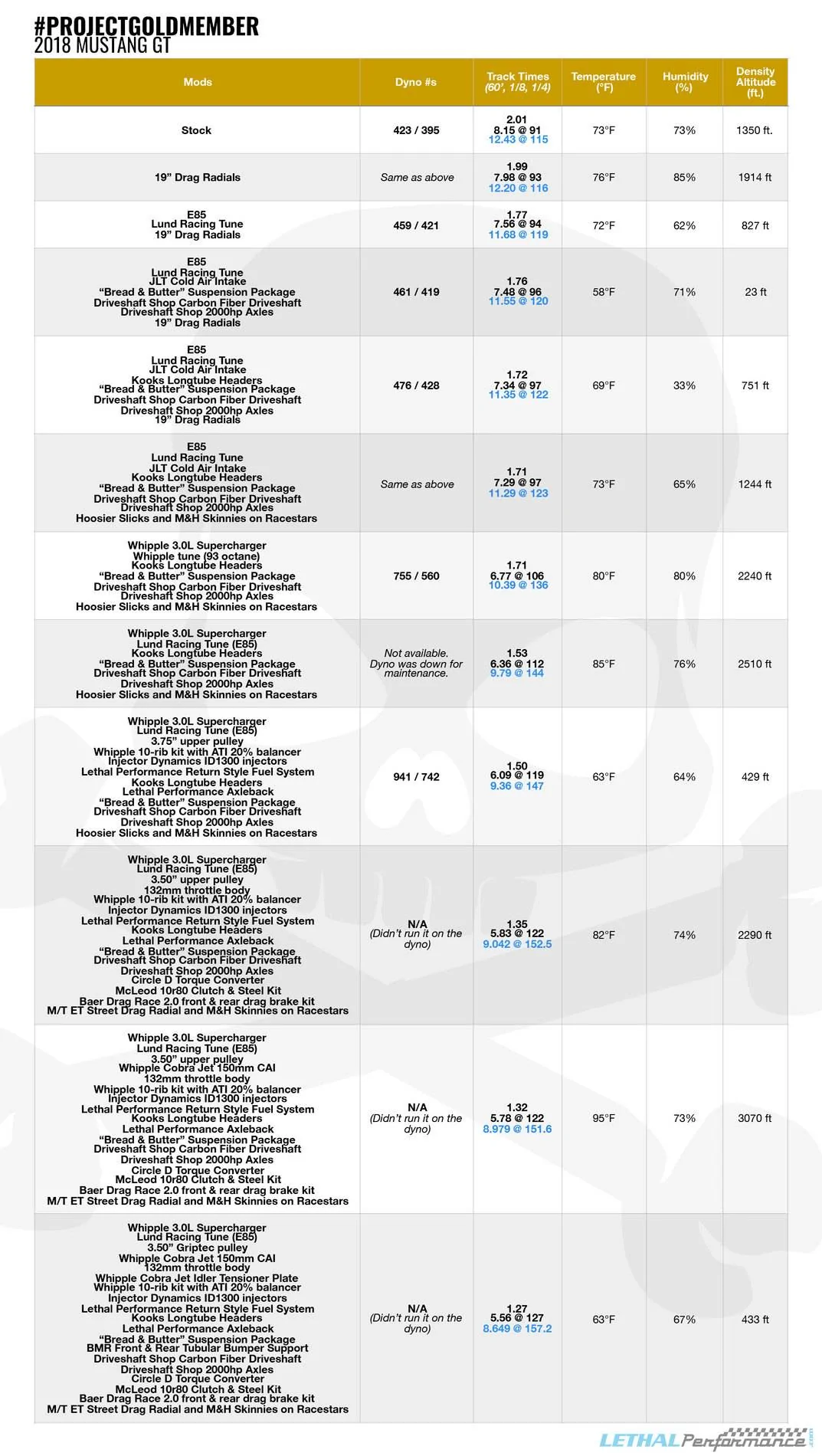

Longtubes are definitely worth it on a 2018+ especially when paired with a Lund Racing E85 tune. Catted setups will yield less gains than an offroad setup.
We picked up some awesome HP gains with the headers and some really good ET's at the track with them. Here's a breakdown of our build which lays it all out.
We've got some sick deals on LT's right now and can also hook you up with a Lund Racing Ngauge tune combo so give us a shout if you have any questions and we'll be glad to assist you.
So the LTH are only worth 15 hp and 0.2 s in the 1/4? Seems not very cost effective.
