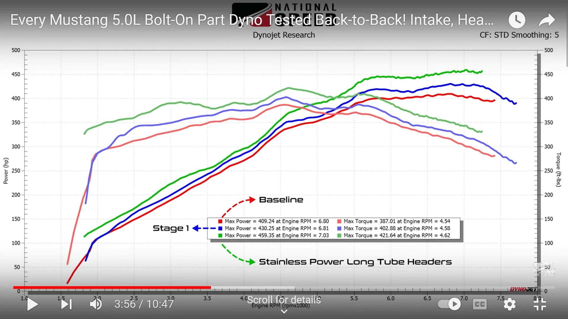

Had a few minuets so I found a back to back dyno of headers vs no headers. It is both a CAI and headers so might get some crying, but no loss at low RPM. If fact it gained everywhere.
Red is stock
Blue is CAI only
Green is headers and CAI
Red is stock
Blue is CAI only
I believe baseline is factory calibration, and the CAI/LT’s are with tuning. Tuning is probably 70-75% of those gains in reality.
They optimized each and disabled dynamic timing. Tests same day in a 2 hour window.
Point is you don't lose low RPM power with headers.
Definitely not. The AVG TQ, usually rises, and more is shifted 200-400RPM lower.
If we are going to play the "here's my dyno sheet" game then give me 20 minutes and I can find dyno sheets that tell every story. I have seen long tube headers loose low end power a lot, especially when you improve the back end flow but not the throttle body/front end flow.
My point was long tubes are specifically designed to increase the top end hp/ high rpm power. Shorties are designed to increase middle range hp and torque.
In the dyno sheet you provided you can see the exceptionally large dips in the power band in the middle range. It does make more power but that's not a very smooth line and I'd much rather choose a smooth line with less power than a dippy line with a little more power.

@Jstang23 I think we are talking apples and oranges.
I'm saying a set of headers with 36 inch tubes will produce more avg torque below torque peak and 26 inch tubes will produce more avg above torque peak.
Block hugger or shorty headers I don't waste my time with.
