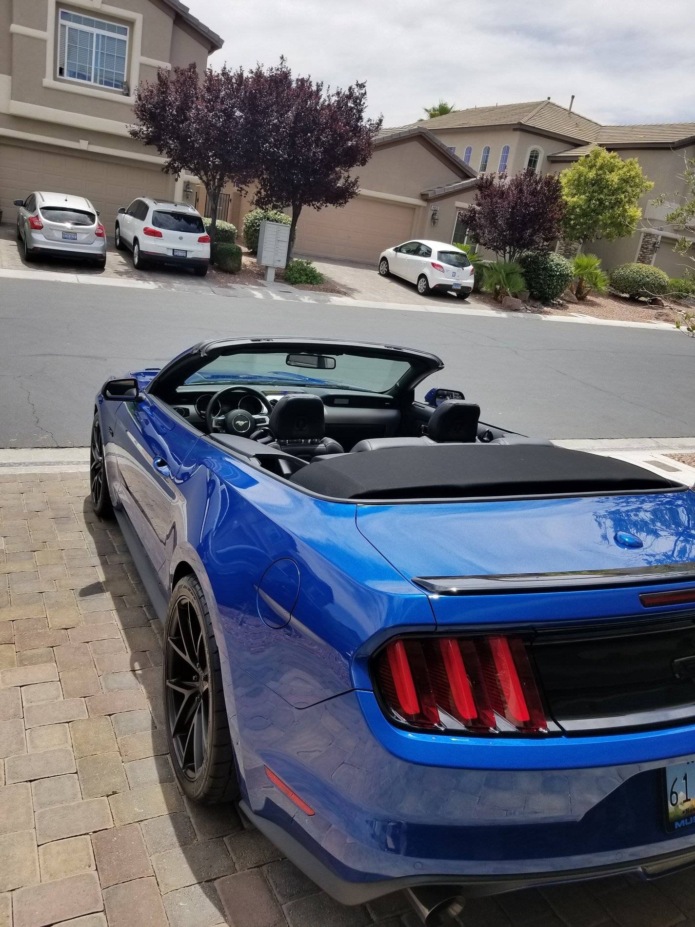

Good evening fellas..
Question.. I live in Vegas, and own a convertible GT.. I always always have the top down here. Already have a Borla Sport Cat-Back and it sounds amazing. I want to add LTH's for the sound and the performance... but the questions is... will it be TOO loud when the top is down? Obnoxious? Will my wife still enjoy driving with me or will it be too much?
Thanks for the input and stay healthy..
