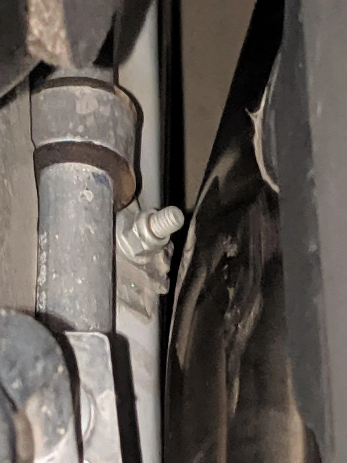

Headers are on. I'm thinking that this bolt might cause some false knock though and was wondering if anyone else just filed it down or something and if so how they did it. Passenger side near the AC lines.
