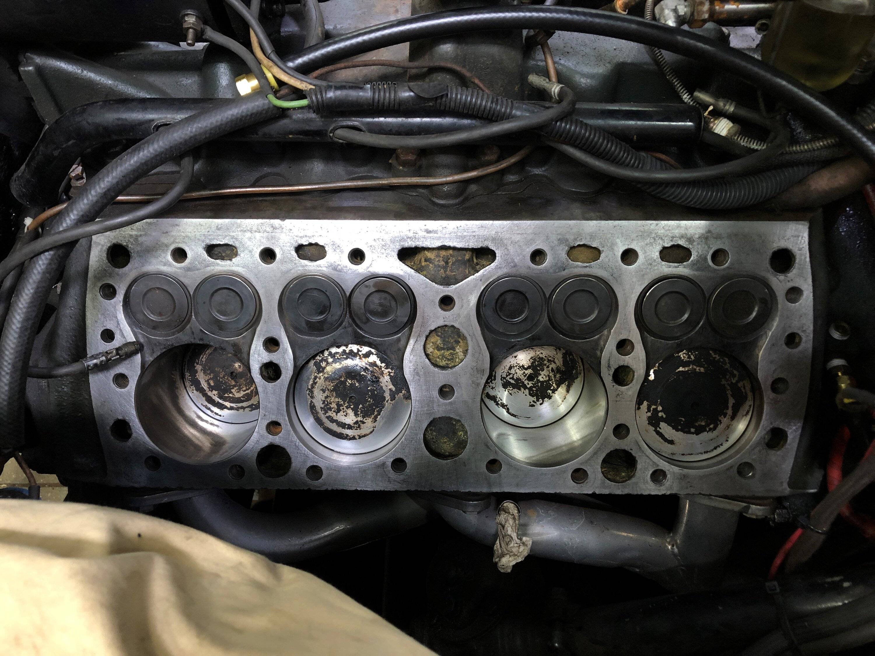

Speaking of which, I put new head gaskets on my V8-powered Ford over the summer. It's got the same firing order as a Coyote, though it makes nowhere near as much power or torque. 😆
