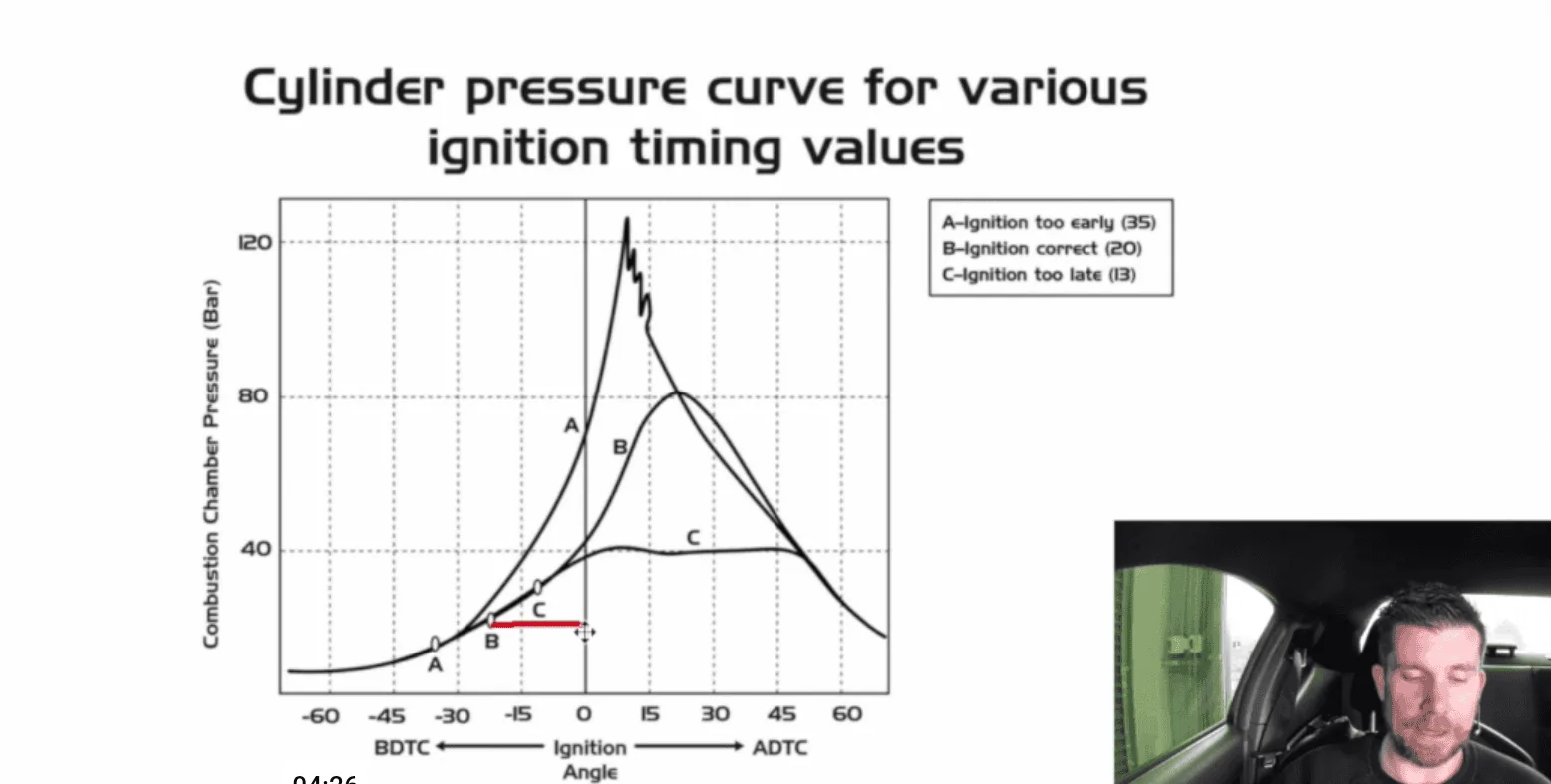

I was watching a video from HP Academy and they showed a graph, showing how pre-ignition affects cylinder pressure. I've heard about LSPI and engine failure, but not much on why it causes so much damage.
Buldawg76
Jan 11, 2022
1,312
1,174
Alabama,USA
2020 Ecoboost Premium, 76 FXE shovel, 77 KZ1000
Pre ignition cause so much damage since when the fuel/air mix is ignited to early it allows the cylinder pressure to peak before the piston has traveled past TDC in the cylinder, so it tries to push the piston and rod backwards against the direction of rotation and breaks things like rods, cranks and piston crowns. Ideally you want to fire the plug at the perfect time so that peak cylinder pressure occurs just past TDC so all the push/force is accelerating the piston/rod in direction of rotation.
It is also very dependent on the quality of fuel being used as well as loads, RPMS, compression ratio, N/A or forced induction, ETC. It can be caused by incorrect ignition timing or hot spots of carbon build up or other small protrusions inside the cylinder that can become hot enough to glow red hot causing the pre ignition.
