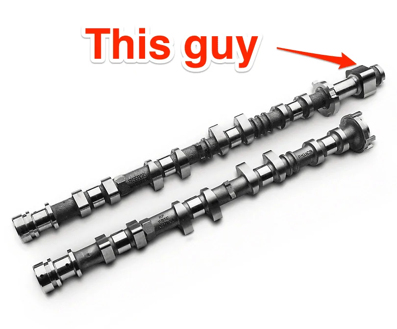

We have camshafts for the Ecoboost. Esslinger Stage 2's. I'm building 3 engines right now and all 3 have Esslinger Stage 2's in it.
Do these change the exhaust note any? I had Crower cams on my '97 GT and it was an absolutely sick sounding exhaust.
I read the FRPP cams add almost no HP and don't change the sound any.
