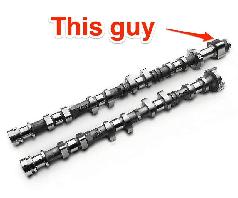

Question: How do these work differently from stock and why are they beneficial/what would make them worth getting?
Esslinger still builds engines, I use them for some block work and camshafts. However our complete longblocks are not done by Esslinger.
The difference in stock vs the Esslinger camshafts we use in our builds is that they provide more top end power. The lobe that drives the fuel pump doesn't change. They work differently like any upgraded camshaft in any engine works. Changes to lift and duration!
Would these cams be a worthwhile upgrade for stock turbo guys? Does the increase in top end power come come at the expense of low end grunt?
You will never lose the low end torque if you stick with the stock turbo. It is fairly small and will always produce desirable torque.
Yes you will see a decent increase in power in the top end, to put a number on it I would prefer to dyno test them on a stock turbo car. I'd hate to say a good 20-25hp increase without actually seeing it happen. These cars are odd, and weird things make power.

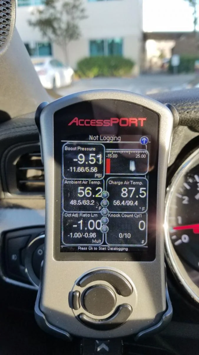

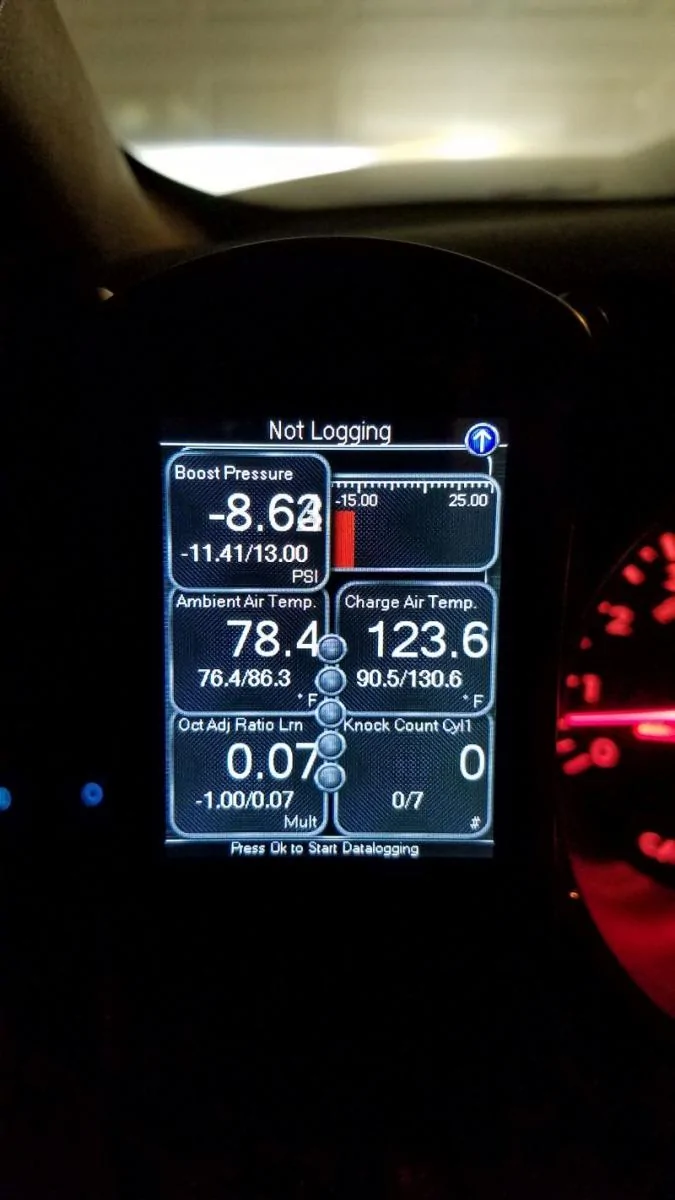

While driving to/from work - 30 miles one-way, I had the A/P connected and observed random knock and more alarmingly my OAR dropping from -1.00 to literally 0 by the time I got home. Should either of these be a concern? I have not kept the A/P connected and monitoring in the past.
As you can see during the 45-60 min drive to work, I didn't exceed 5.56 psi of boost, yet had a knock count of 10.
That evening, while hitting 13 psi at some point, knock is lower but OAR is almost 0. This is on 91 Octane
