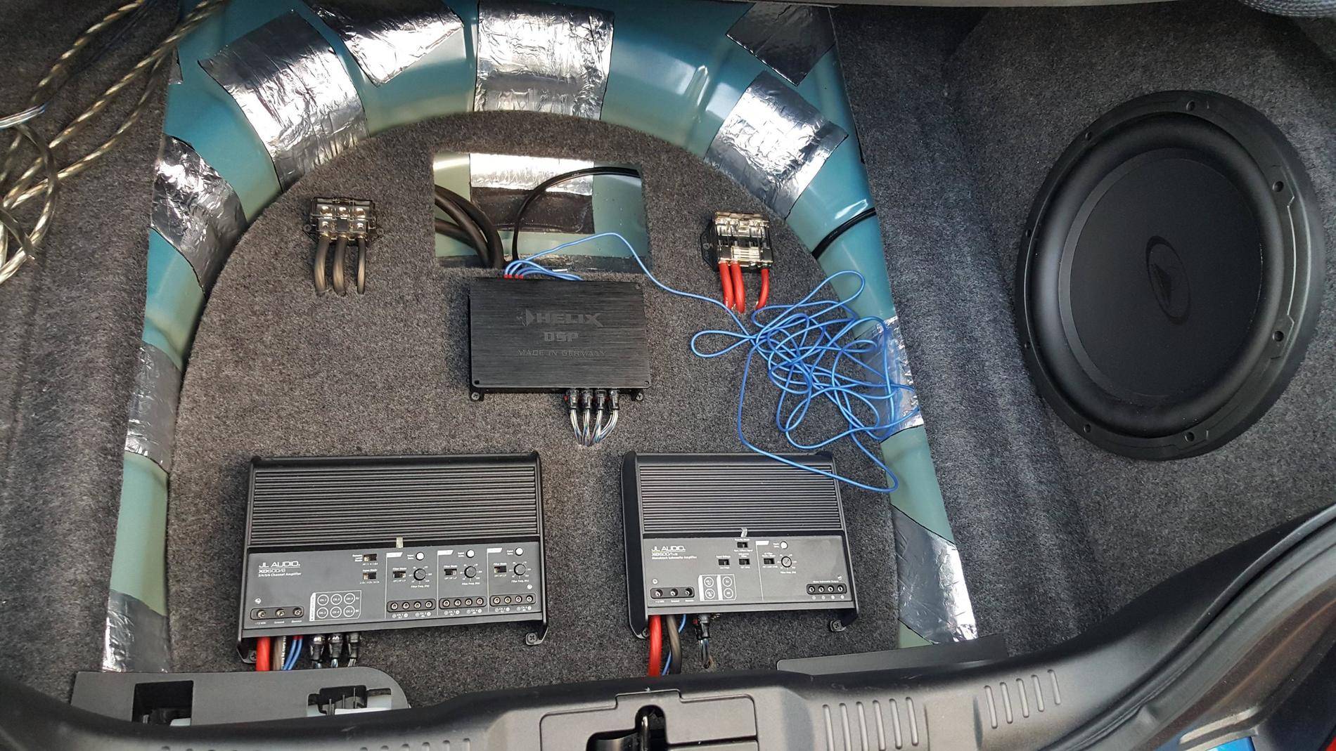

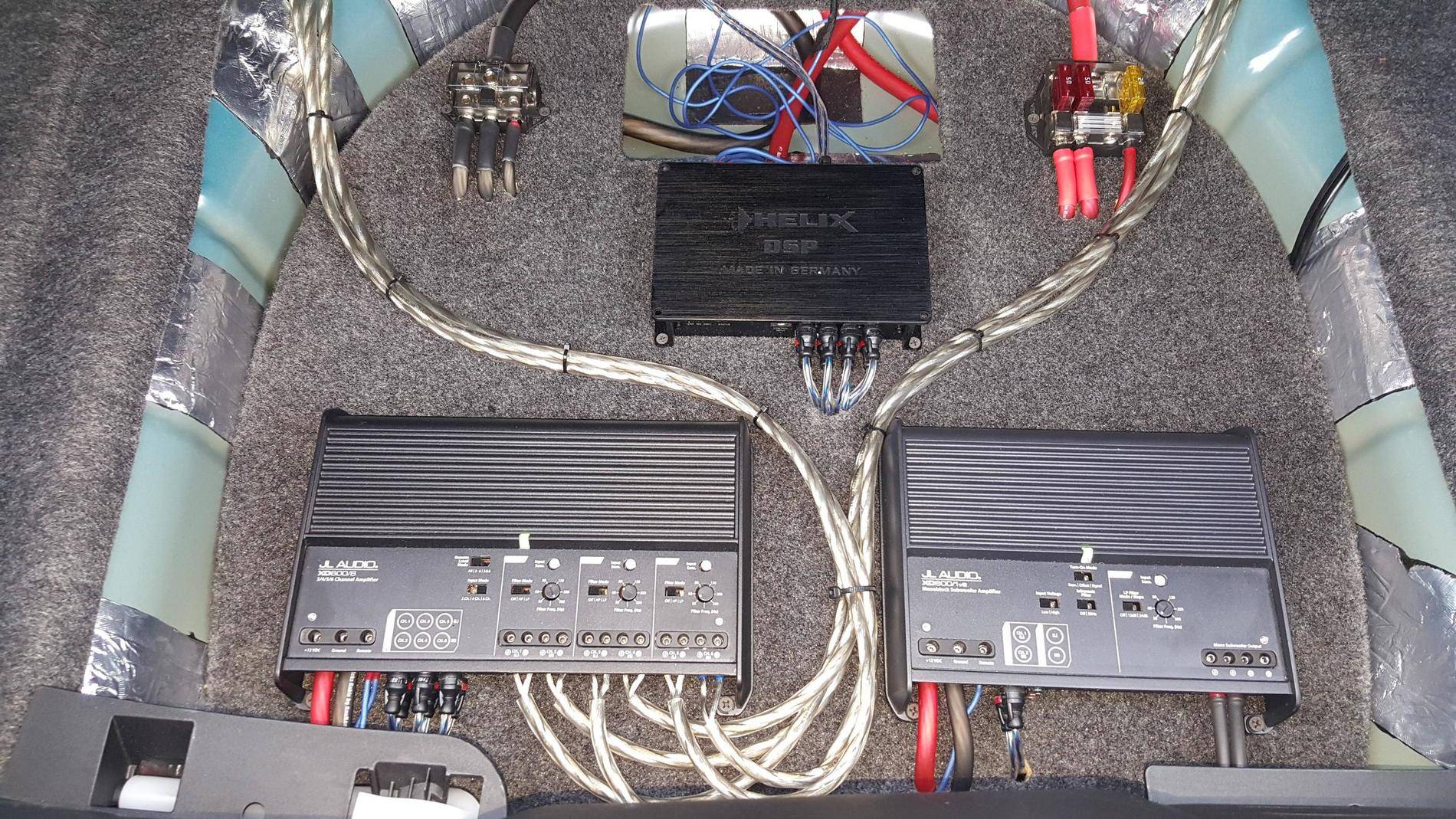

Something like this?

Look sweet! Still debating on the sub box. Currently have a Zenclosures single front firing box. Had a heck of a time trying to use forscan to remove the eq. Finally found out it was the OBD controller i was using. Didn't have the toggle switch. I have a Dayton DSP but I think I screwed it up somehow. Was thinking of the JL unit instead. Have all the speakers replaced and adedd a sub but had to revert back to using the LOC for the sub because couldn't get rid of the EQ. Was thinking of replaced the Zenclosures box with the one we have been talking about re-tackling the stereo in the fall lol

Thank you, did it all myself except for mounting the sub.
Looks like you will have a sweet setup when you're done. DIY is a lot of fun and very satisfying, knowing you did it yourself.

Thanks and it is done now, just no pics of the finish (although above is pretty darn close). Added a link in my sig to the Audio Designs sub enclosure.
