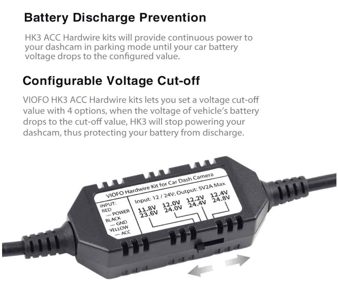

hey guys, so i just picked up a 2023 mustang gt, i'm looking into getting a 24/7 dash cam just to be on the safe side, and i already noticed that my uniden r3 stays powered on if i turn the car off until it shuts itself off. i'm looking to prevent battery drainage, so i just unplug the r3 every time i get out of the car. it works for now. with the dash cam, the hardwire kit states the below info about voltage cutoffs. I want to know, will using a hardwire kit shorten the lifespan of my battery? Even though it cuts off at lets say 12 volts, would the fact that its being drained to 12 volts every time the car turns off hurt the lifespan of the car vs all tech being off when the car is off?
Looks like you can set voltage turn off at 12.4v.battery is usually 12.6 so 12.4 would be fine.
