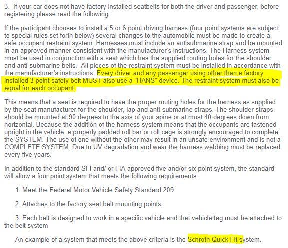

i recently (month ago?) got an email from one of the clubs about requirement for hans device... but i'm not sure if it was only for cars with 4 point harnesses or if it was in general. are clubs moving towards having a hans even if you are running a factory seat belt? thanks i guess i don't see the difference as a hans doesn't connect to any harness or seat belt.

If they are going to require a hand devise then they are going to require a 4 point or 5 point belt system.

Was it Hooked on Driving (HOD)? If so, seems like they're saying you need to wear a HANS if you're using a 5/6 point harness and HANS optional for the schroth asm 4 points. Here's an excerpt from the HOD email I received:
As of 1/1/19, HOD nationally, will require FIA or SFI certified Head and Neck Restraints for any drivers and/or passengers in cars equipped with 5 or 6 -point harnesses during an HOD event.
Currently, approved head and neck restraint systems are:
  • NecksGen
  • HANS
  • Simpson Hybrid S
  • Schroth SHR Flex
  • Z Neck Tech (Zamp)
HOD will not require or prohibit the use of these systems with 4-point harnesses, and notes that the Schroth ASM 4-point system is the only one certified as proven to provide anti-submarining protection. Further, the Simpson Hybrid S is currently the only system that has been certified to provide restraint functions with 3-point, 4-point, as well as 5 or 6-point systems.
There will be a one event grace period for those who did not get this notice.

One of the Simpson Hybrid units is rated for a factory three point. I am an instructor and love being able to get in any students car and having some protection.
  • NecksGen
  • HANS
  • Simpson Hybrid S
  • Schroth SHR Flex
that was it! i had forgotten who it was. somehow it got unclear to me when they menitioned 3-point down at the bottom! ok cool so no worries for me.
side note: are snell 2010 helmets still viable option or did that change now?
