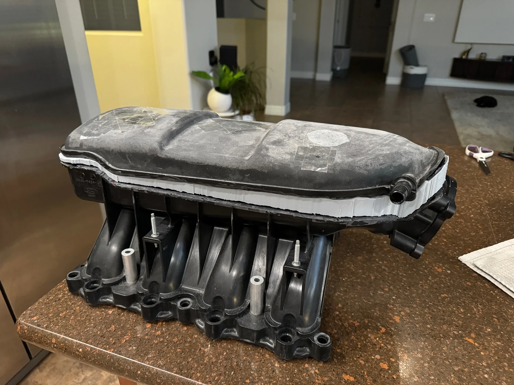

The spacer I was making was for the plenum. Just the cheapest plastic I could have 3d printed in decent detail from an online parts printer. It was a little warped but it was still off enough I got discouraged. For the throttle body I was going to see if something like rtv could hold up since the surfaces seemed to be so bad on the manifold after removing the oring that a simple paper style gasket didn’t seem to be viable. Again this was just for na.
Here is my prototype spacer I had
AcceptableNebula
Apr 5, 2023
339
961
Massachusetts
Jake
2023 Ford Mustang GT Premium
Cool idea for sure!
