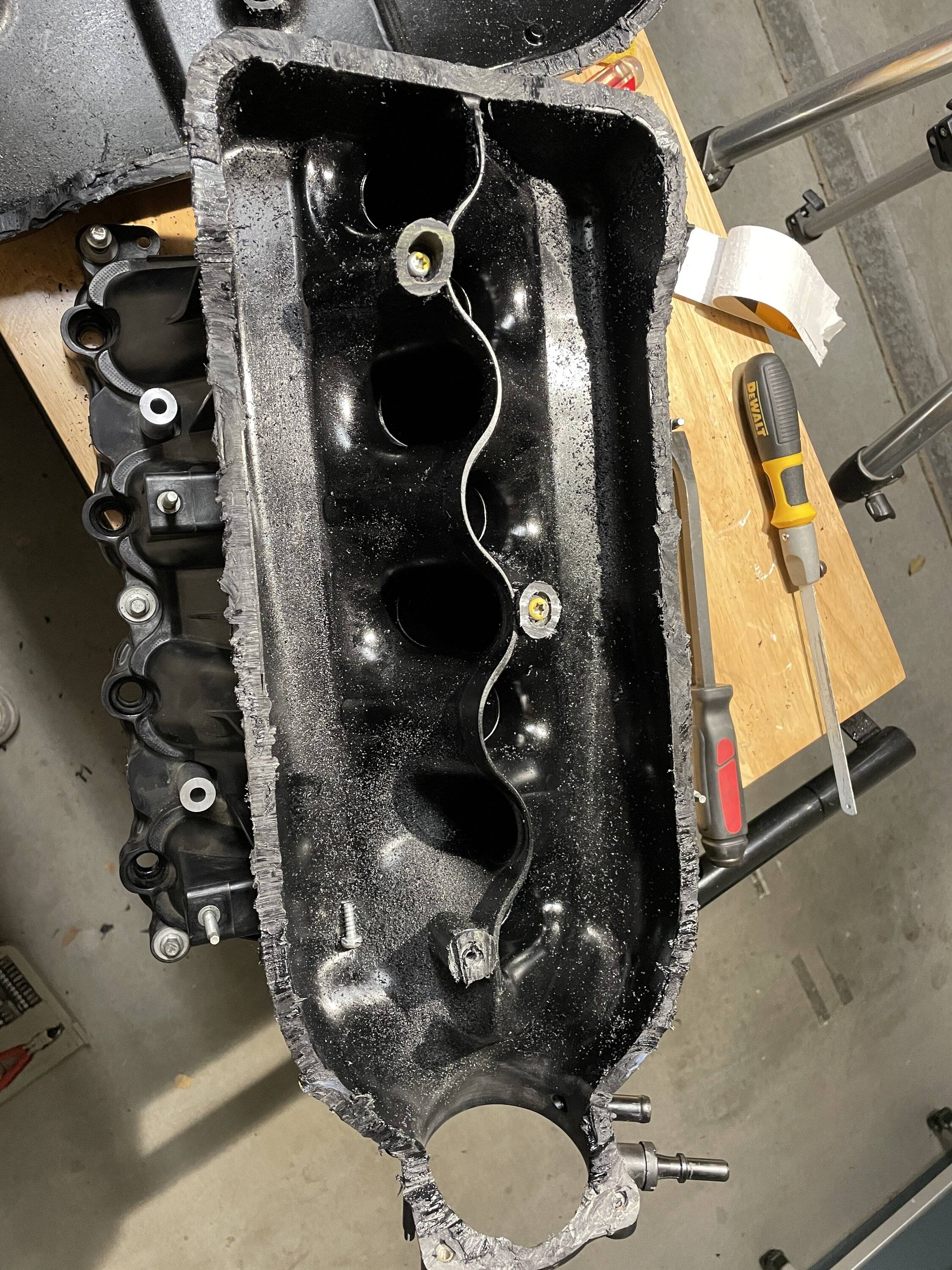

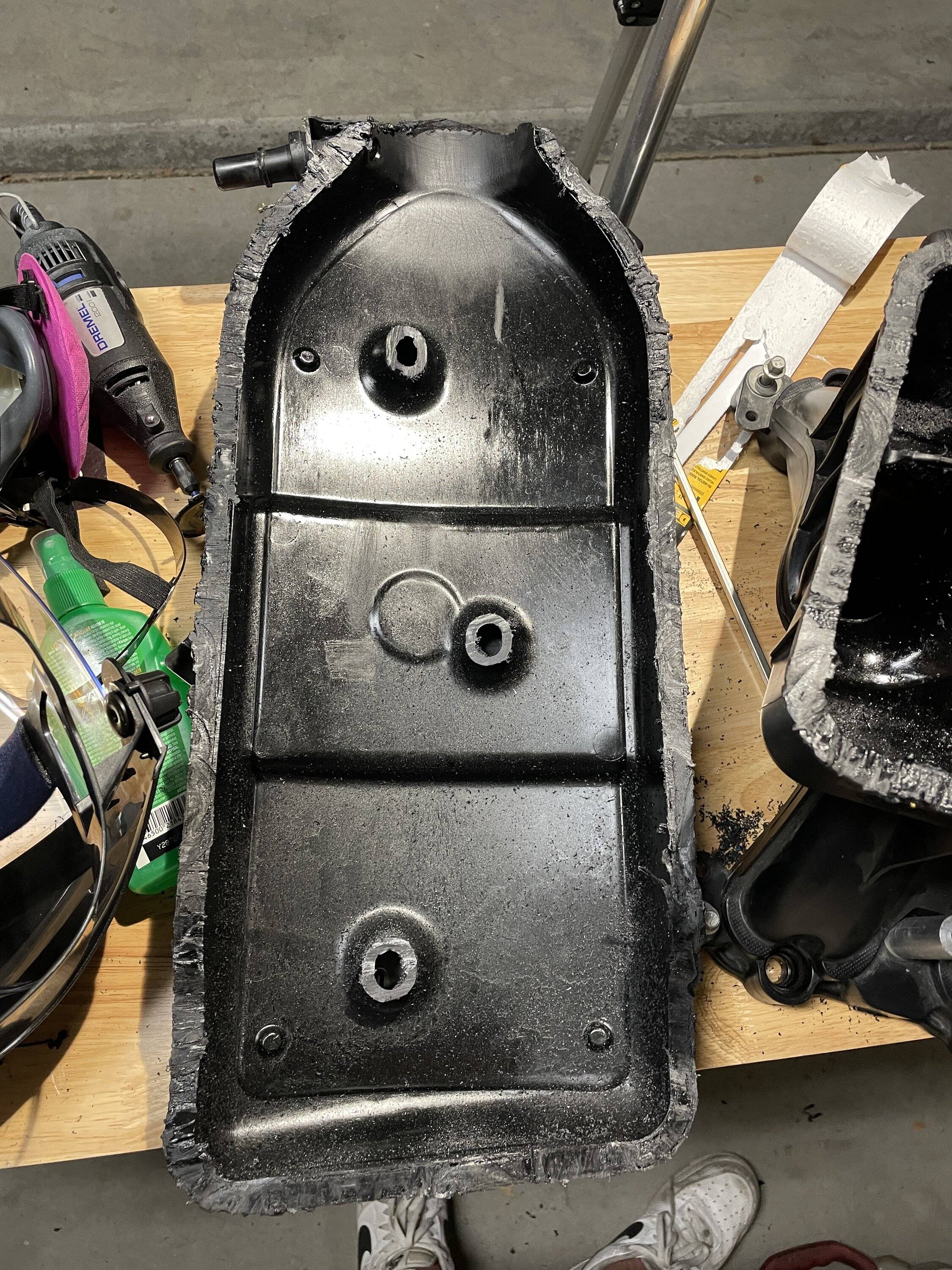

Finished cutting open the manifold. Here is what it looks like.
Also here are some tips for anyone else who is attempting this:
Use a Dremel and a reciprocating saw that has enough clearance to go around the manifold. Use the Dremel to start cutting into the manifold along the seam of the two pieces. Use the saw to cut the rest of the way. Make sure the saw is actually cutting and not just melting the plastic. If you go the slow and the saw gets too hot the plastic will melt and seal the cut. Once you cut all the way around use some pry bars to make sure the edge of the lid is free. After the edge is free get a small hand saw with a long blade and cut the supports in the middle. Cut towards the top of the supports to await the metal screw in the middle.

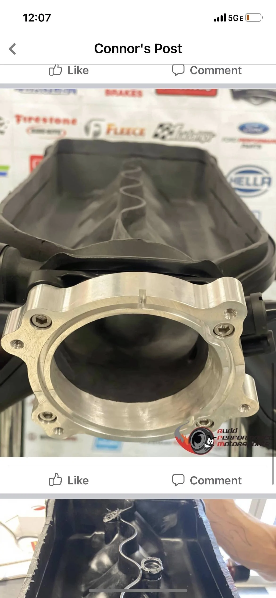

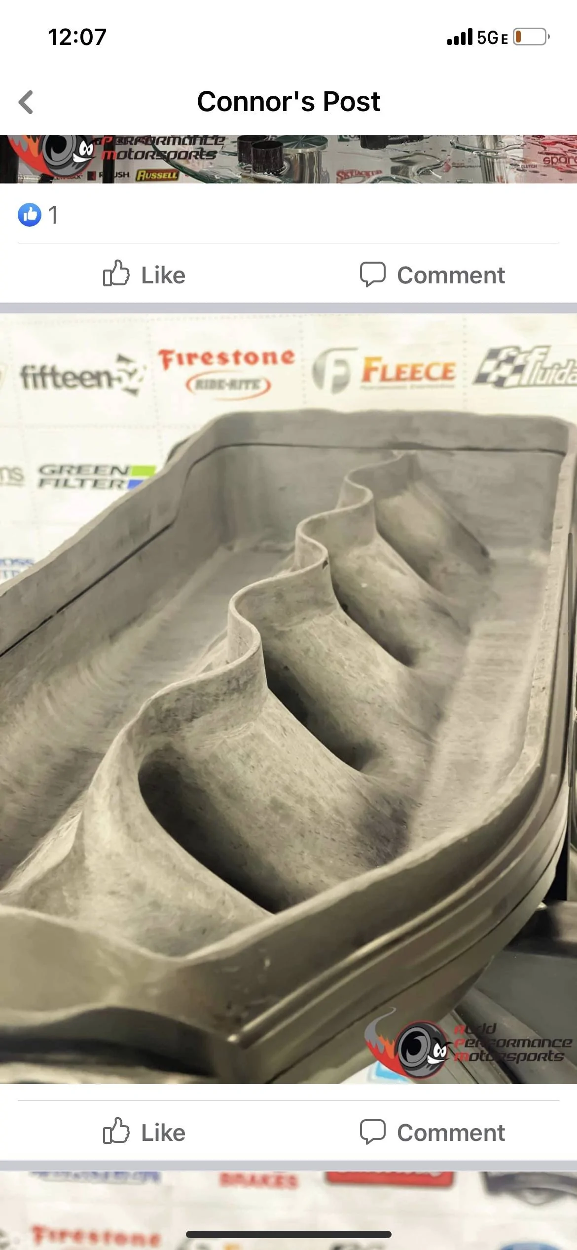

Here is what I plan on making the manifold look like. I’m gonna cut out the supports and add a spacer along with smoothening the manifold and filling in any gaps.
