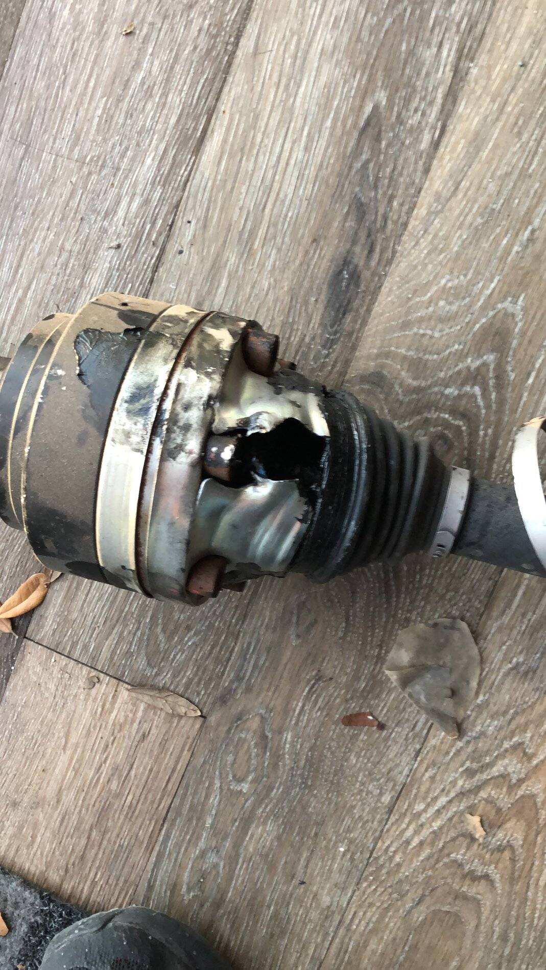

Are you going to fool with DSS on warranty work or upgrade to G-Force shafts?
They are about a year and haft, so no warranty, I’m going to call g-force to see what they tell me before I order. I think they have lifetime warranty right?

I broke passenger side “2000hp” rated dss. Car is only making 800hp my-82. What axle should I get next? Hoping to be on the 1000 to 1100 soon
What axle should you get next ——> GForce no doubt.
The 03/04 Terminators were having the same issues well before the S550 came to fruition.... guess what they were breaking too... DSS.
What many Termi owners went to were G-Force shafts, that could withstand a lot of power, didn’t fail and come recommended from many high HP owners.
