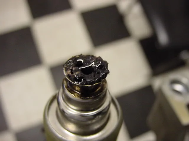

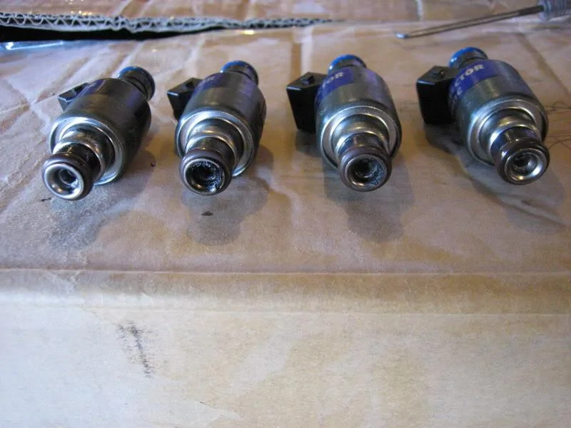

On a car making big power, its a very very good idea to take the 10 min. and pull the rails off the car at least once a season to look at the tips of the injectors.
Sometimes you will find the injector tip covered with what I can only describe as "sap" .... pump gas cleans it right off, so thats why I run pump through every now and then.... but my friends that run E85 for a full year or two without doing that, can get injectors with very very badly blocked spray patterns.
Again, nothing the end of the world. But the 10 min. it takes to check is WELL worth the piece of mind. :)

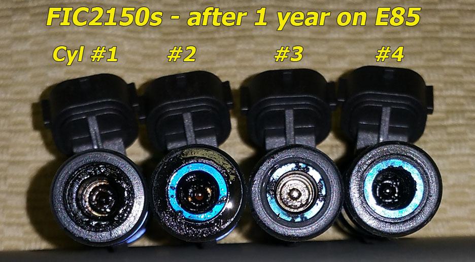

The “black goo” usually only occurred in higher mileage builds that converted to e85. Essentially we all came to the conclusion the ethanol was cleaning out the entire fuel system and the goo was the remnants. We always usually run a tank of 91 through the car every 6 months or so to keep any goo buildup at bay.
However, with the ID1300’s and Teflon fuel line setup in new (1500 miles or less) cars, we haven’t seen any goo whatsoever in the last 2 years or so and 8+k miles of straight pump e. Could be just the newness of the car or the stainless injectors, but it’s not happening whatsoever, even without running pump gas occasionally.

I get this pretty bad in Ohio with just a NA gt350 and the stock injectors. I have tried all of the additives, lucas seemed to be the best as far as a conditioner, but didn't necessarily help this gunk crap. Also tried every bottle injector cleaner there is and have found that the cheap, STP fuel injector cleaner is actually the best, Lucas was the worse at least for this. Also a tank of tier 1 gas every now and again helps. Never tried marvel but I suspect its the same "old time" chemicals used in STP.

I had the goo on a car with less than 6k total miles, 3k of flex fuel. I read somewhere and am convinced its due to something in the cheap ass gas they use as the base for the e85 and the heat in the engine when its shut off after running.
The e85 stations by me all carry non tier 1 blends. I run a cheap ass bottle of stp injector cleaner in every tank now, it is the only thing that has kept the damn things clean here. Seriously hoping the move to FI and ID1050X or 1300s help this.

That crap was so bad my car stumbled, head temp went up, and one banks fuel trims started adding a shit ton of fuel to make up for the clogged injector. If I had been FI, Or not paying attention I might have had a real shitty day. Now I can tell if they are starting to get gunked because the tune infers the wrong alc percentage because the IDC gets screwed up when it re learns on a fill up.
