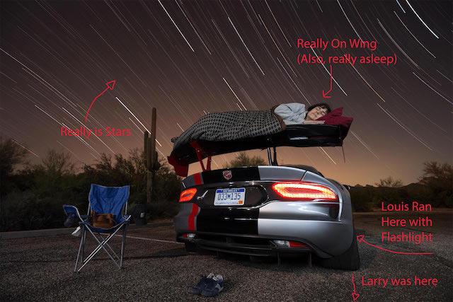

Hate to be pedantic, but that is downforce. Downforce is a pressure differential that pushes the car down, in the simplest terms. It can be done between the top and bottom surfaces of a wing, or between the sheetmetal and underbody, as a splitter does. Either way it's still downforce. The GT350 splitter essentially makes the front end lift neutralized at most track speeds. The R splitter actually adds downforce, as does the wing.
There is no noteworthy force "added" by the 350R splitter. There's more high pressure on top so more low pressure below it. We don't need to argue about it - go stand on a 350R splitter and let me know how far the car went down before it snapped off. Also note how distorted the spoiler becomes under your weight.
I think there was a report the GT350R aero package generates more aggregate downforce at speed than a 911 GT3... 911 GT3 has net of like 276 at 186mph.
Assuming you don't weight 276lbs - if you go stand on the front spoiler of an R - it will pull the car down (before snapping) and prior to snapping it will bend the spoiler itself..
Now compare that visual to what you actually see in photos of GT350Rs at speed (or any cars with cheap plastic composite front spoilers).
Meanwhile - a Dodge Viper ACR will produce about 1700lbs of downforce at speed.. which is why you can do this on its rear wing:
