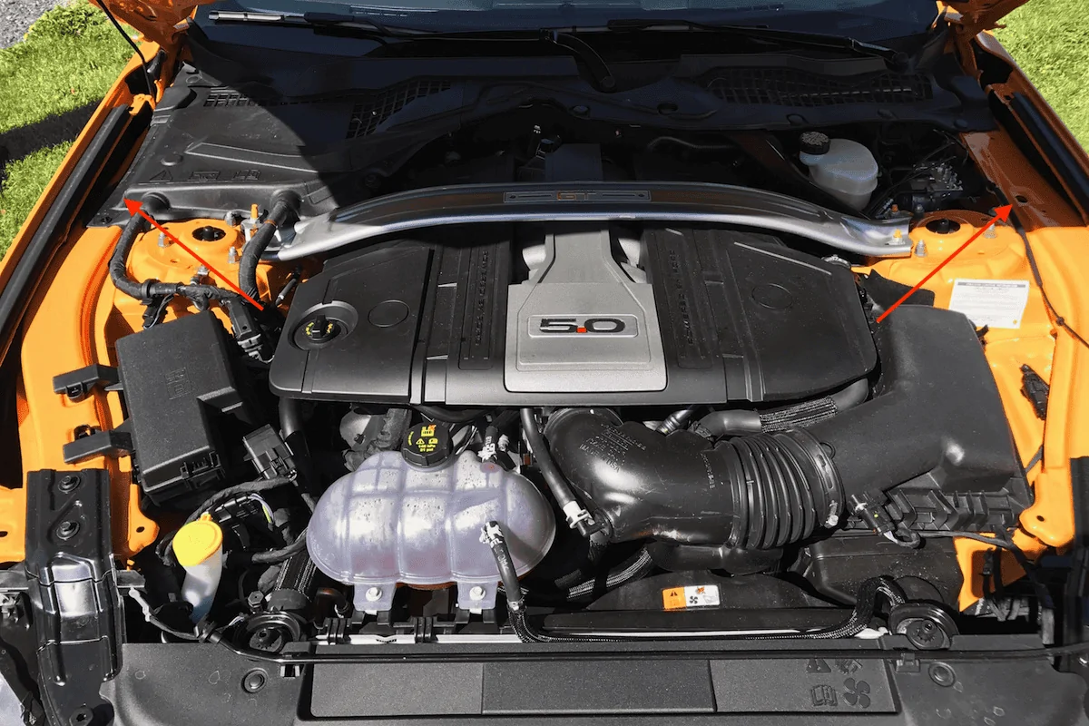

So there's two ways to mount the lower bracket in a GT (that should be applicable to GT350), there's a cutout in the inner fender, shown in by the red arrows, and note the other side that area is covered by the battery cover, so that's the ONLY drill/cut, just a small hole in that plastic cover about the size of a nickel:
The MRT struts use the exposed 10mm fastener at the end of the fender/hood channel (just after the weather seal), shown in the photo with blue arrows:
The MRT use an L-bracket, where most others: Redline, etc., use a sort of "toggle bolt" like lug and fastener in that cutout in the frame (which is covered on the passenger side and requires the minor battery cover hole/trim I mentioned above).
Assuming the GT350/R has that same 10mm fastener indicated by the second photo, then they will work, and won't require any other modifications (including the battery cover ...)
