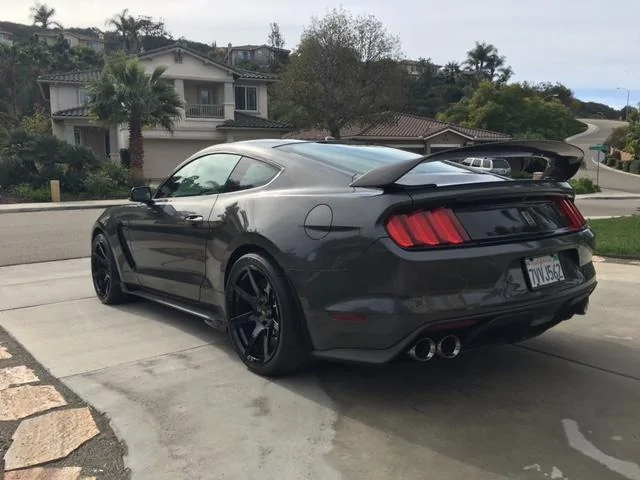

Dude... why are we trying to shift the wheel inwards on a car designed that way for a reason? You have a lot of rear wheel travel (see wheel gap) to accommodate the articulation of the suspension cambering negative as the wheel is pushed up, slipping that wide ass wheel under the fender... because the handling benefits from it. Camber it at -2.1 (which, BTW, max on my GT without camber arms), hell maybe more on those cars if you're at the track and it's possible. Will handle like heaven and is fine on the street if you don't have a stupid alignment guy who sets god awful toe. Also, FWIW, Nitto tires always seem to look "tall". A Nitto Invo 315 I had looked HUUUUUUGELY TALL like a balloon compared to a Conti DW 315 on the same width and diameter rim. It's very weird. I wish I took a picture... alas I did not.

Are you referring to the factory r wheels? I see you have an r, looking forward to your input.
Yeah, the factory wheels do go beyond the fender lip just a little. The stock tires on a R are not as aggressive as the OP's rear tires.

I knew the R wheels and tires poked out a touch but why do 325's look THAT much more pronounced? I was going to guess he was running a 335 at least.

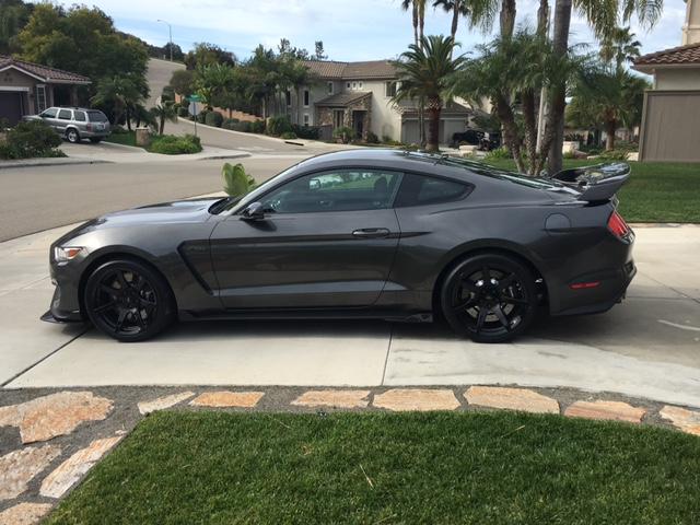

Soooo. I happen to have an extra set of 305/30's sitting around. It looks much better with this setup. For other GT350 owners this is the R spec wheel with a set of Nitto NT01's 305/30 all the way around. I should be able to lower the car now with no major issues.
Lessons learned. Both the 6GR wheel and the factory R wheel poke a little on the rear. Nitto's have an aggressive side wall and a 325/30 will make it look like monster truck. I'm hoping Need4speed will make a +60 for the rear one day.
