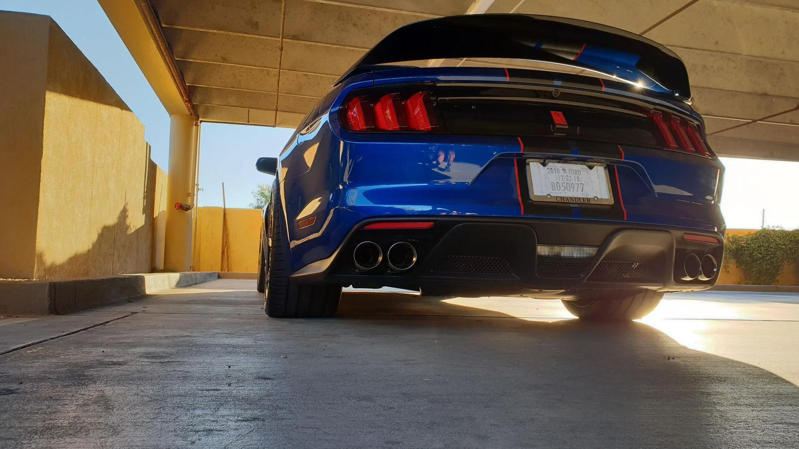

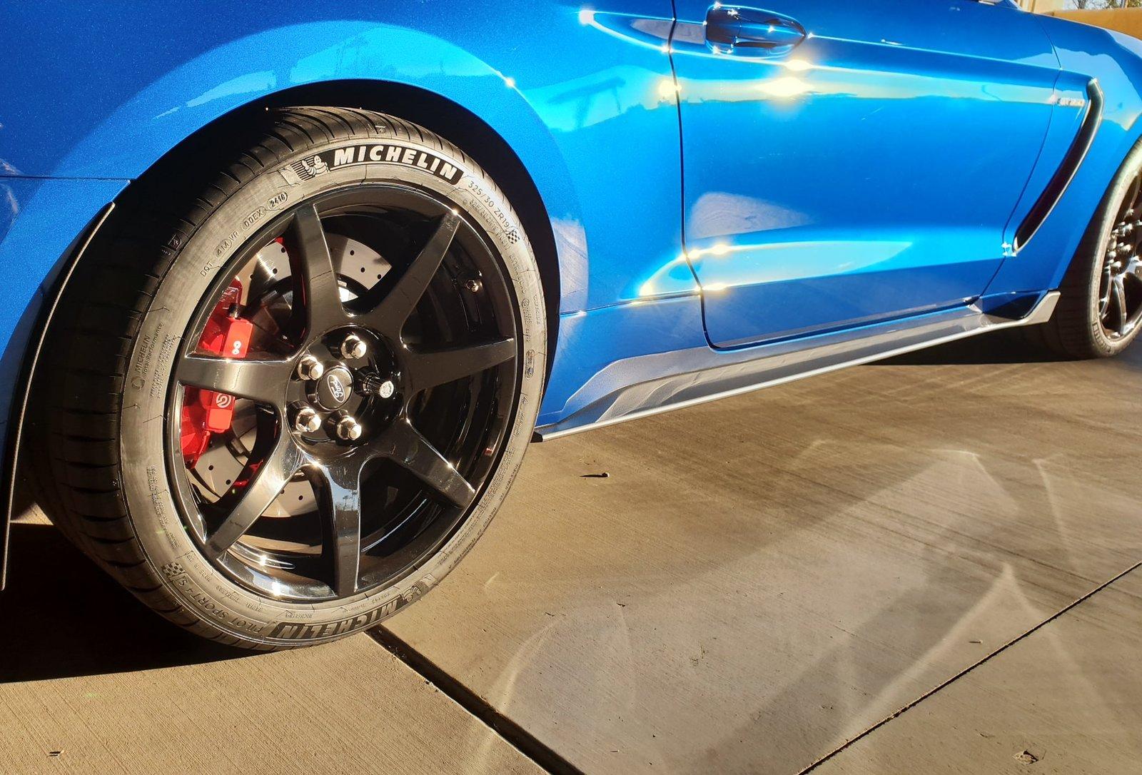

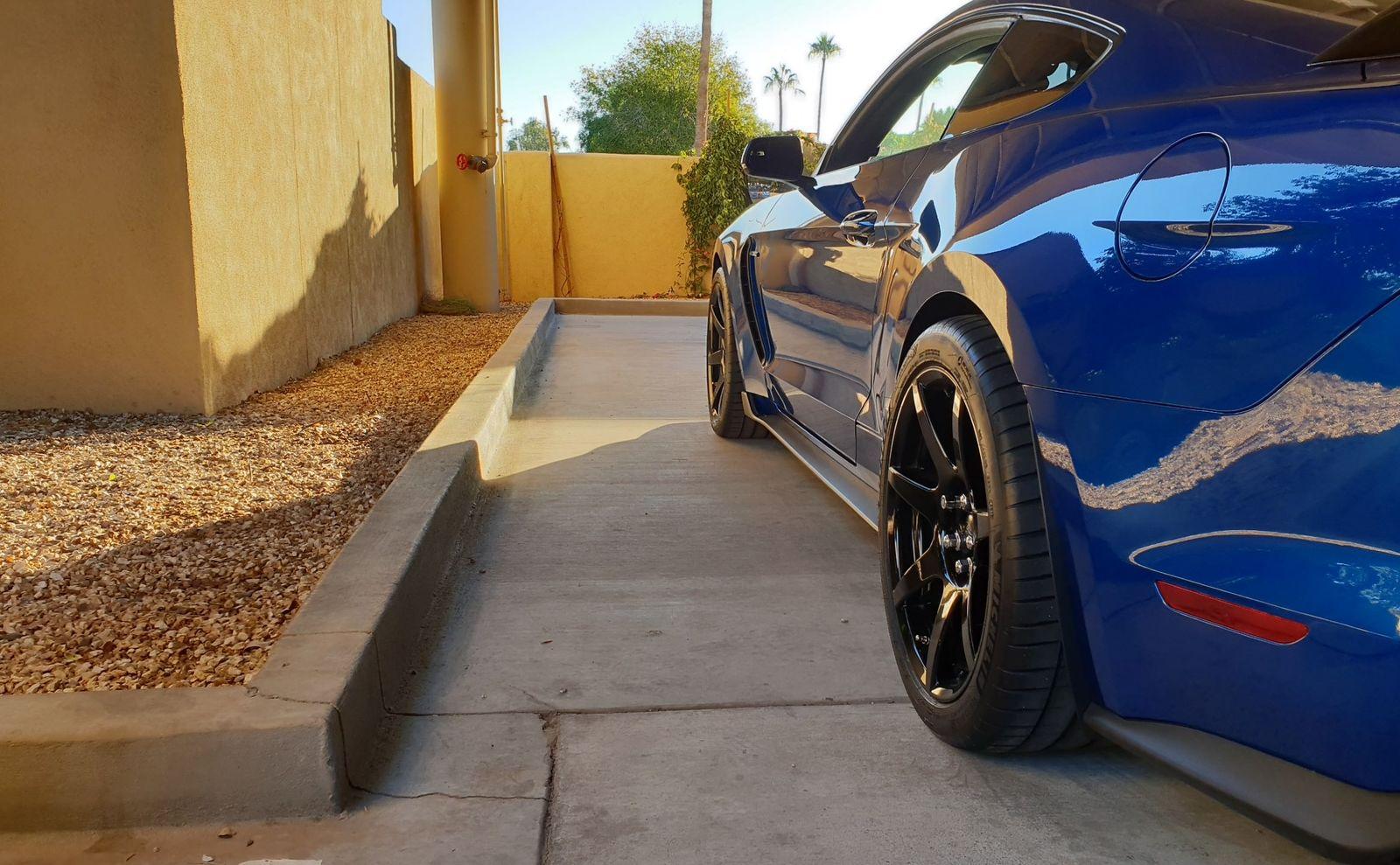

Mind showing a photo of the rear tires? How does it feel compared to the cup 2?
In my opinion, the Pilot Sport 4S is better than the Cup 2 for street use in every way. They make the car feel more stable because there is less tramlining. They also seem to provide more grip at the lower tire temps you'll be at on the street. Not to mention the obvious advantages such as more mileage, less road noise, and far better performance in the wet. I wish they came in a 315 rear so they didn't poke out the fender as much. The R's wheel is wider than the fender, it's just the OEM 315 Cup 2 is stretched onto the wheel so it has an angle that provides more clearance under the fender.
Thank you for the photos. Think i’ll have to swap over to your setup. I went with Continentals but they feel washy. Maybe the sidewall is thinner.
