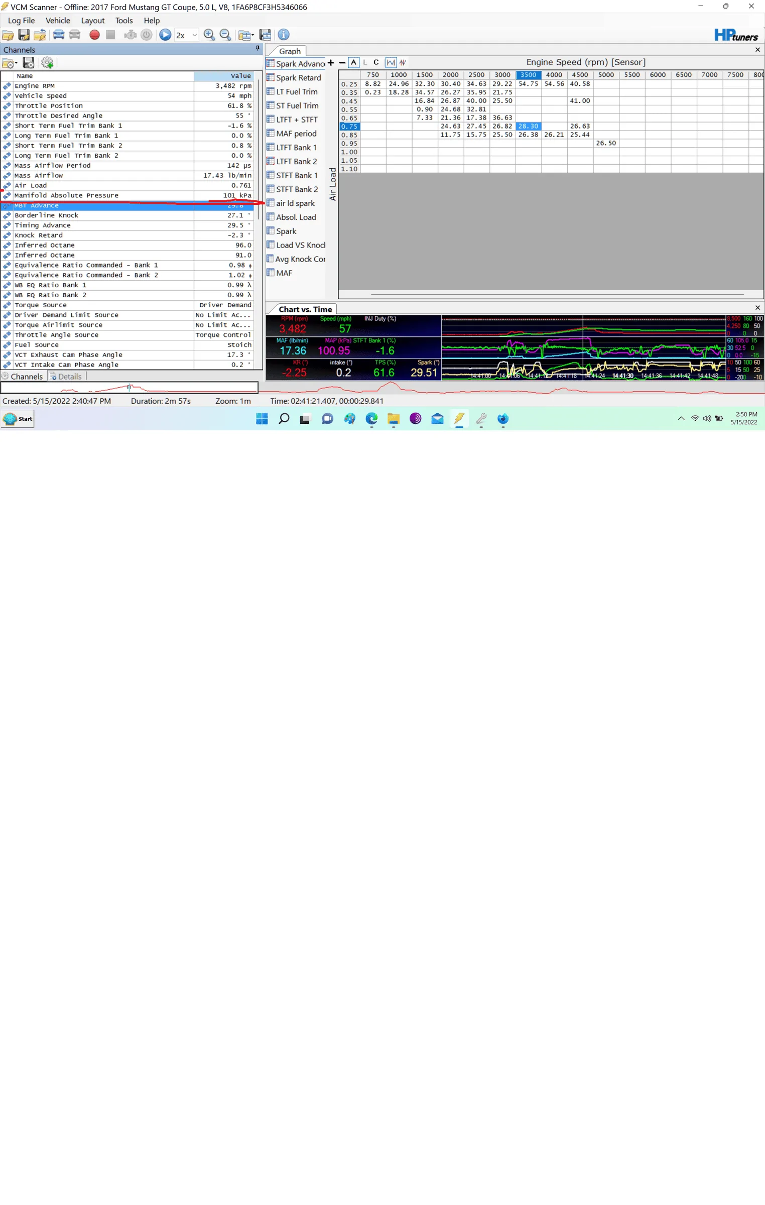

On a GT350 IM is a must IMO. I've been running a 350 IM with an adapter to fit a 80mm TB. Today I rigged up a cai and installed said 87mm TB. What a world of midrange difference. I have a fairly solid tune except for a slight skip off idle. I may need some professional tuning help for this. I am going to try a few things first. I should get some full throttle hits tonight to see if it is flowing more top end air.
So far I'm happy.

This explains the seat of pants midrange boost. It's actually pressurizing the IM, if I can believe the log. I have a mechanical gauge I'll use to verify.
101Kpa

I didn't see a change in MAP using an external sensor with a gt350 tb on 2018 mani.
Back to back logs, within the hour to try and keep any weather/baro consistent.
Curious if the gt350 mani will.
