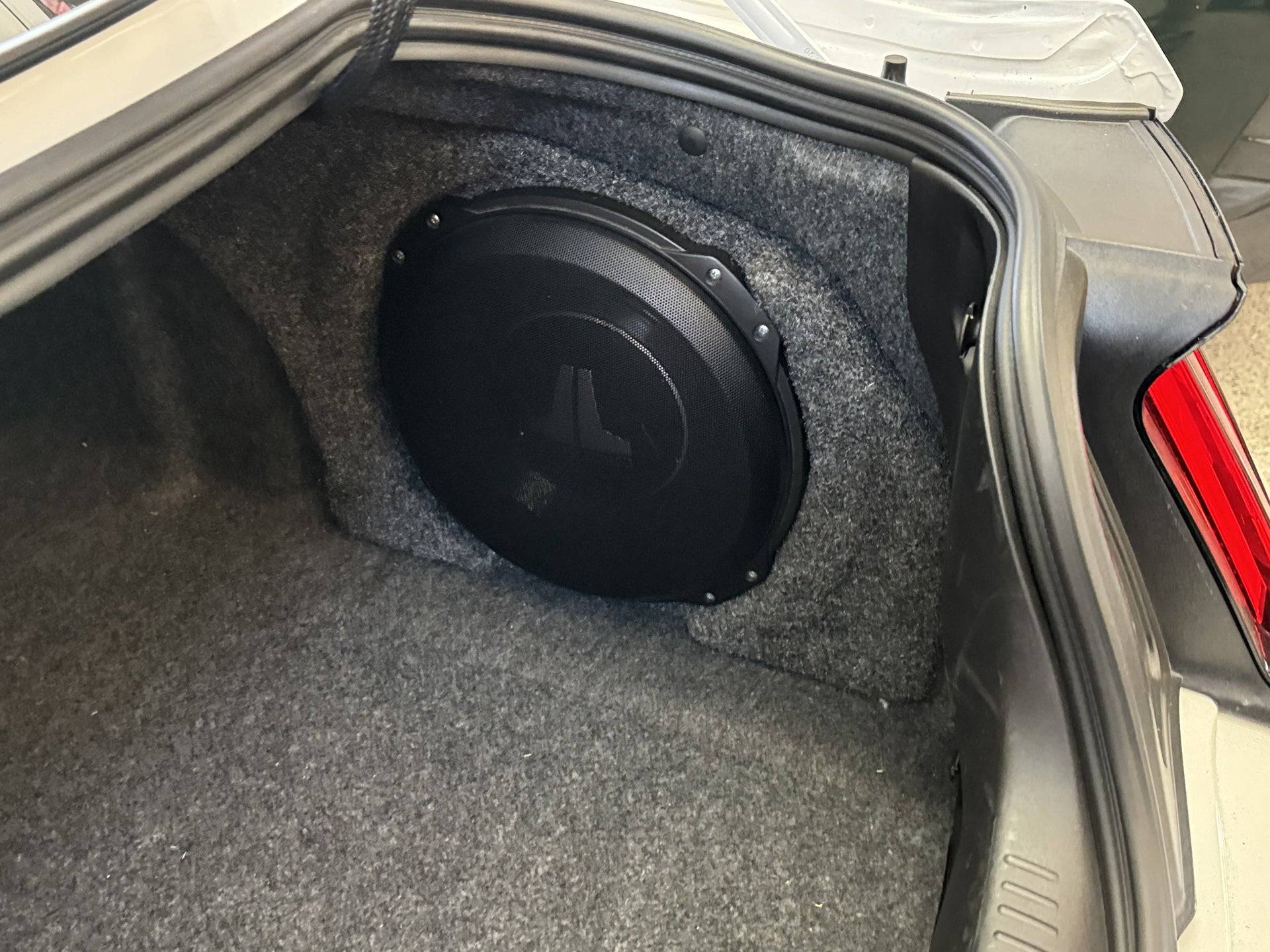

1. Installation of a JL Audio Stealth Box. I found a used one online for $300 in excellent shape. I checked the woofer etc. and nothing was out of the ordinary. Link to the part is here: SB-F-MUSCPE/12TW3

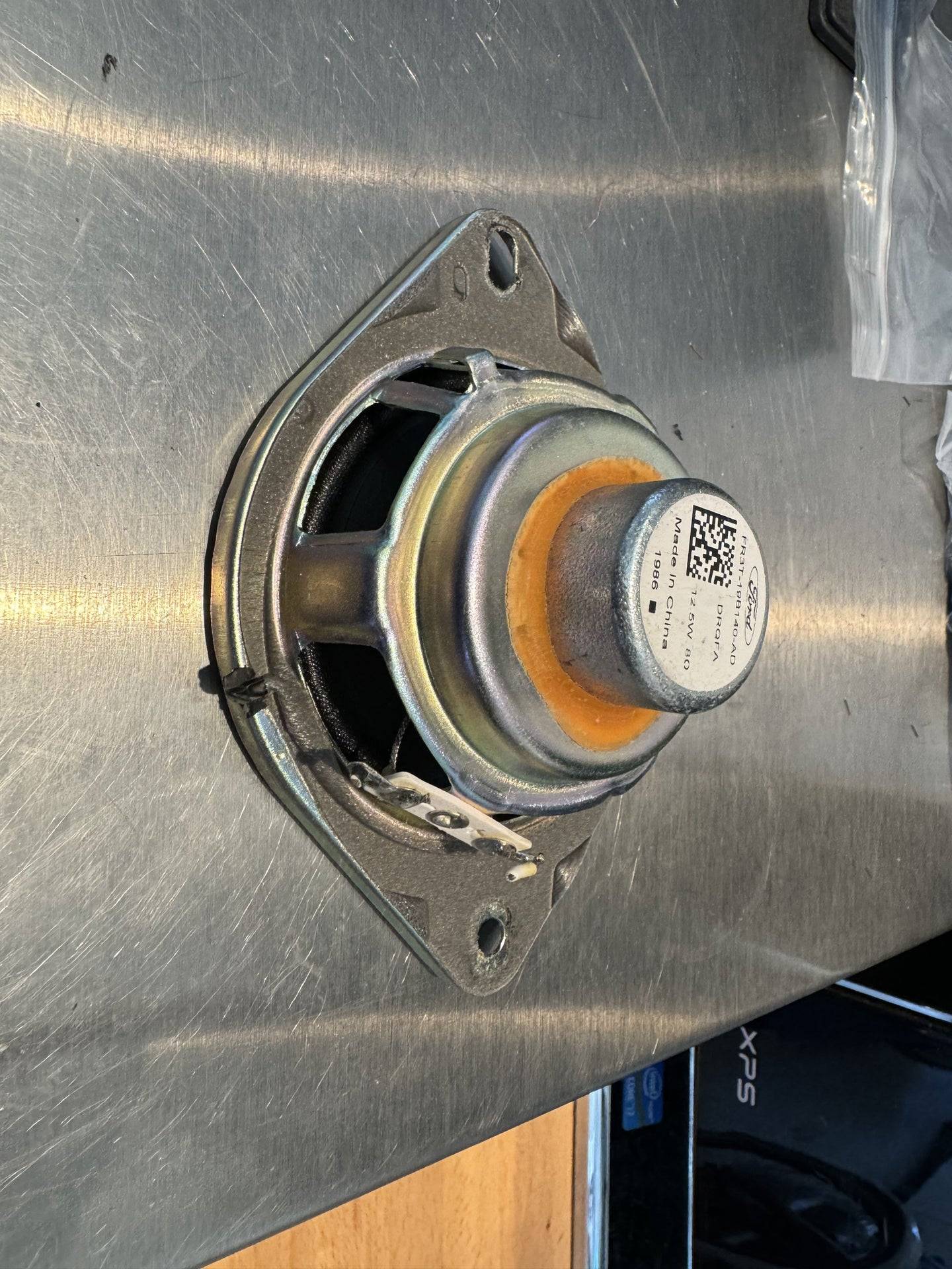

3. Installation of new midrange speakers in the door. That is the most lacking part of the front stage in my opinion. Along with the speakers I installed 500hz bass blockers. I went with Infinity REF 307F midranges. I debated between these and the Hertz DCX 87.3. In the end I got a great deal on the Infinity's and I have some Amazon credit to use so didn't have to come out of pocket. They have built-in tweeters. I am going to continue using them with the factory tweeters and the center dash. For now it sounds really good to me and no need to disconnect things. Link to the part is here: https://www.crutchfield.com/p_108R307F/Infinity-Reference-REF307F.html

JL Stealthbox installed in the passenger side well of the trunk. You really don't lose any space.

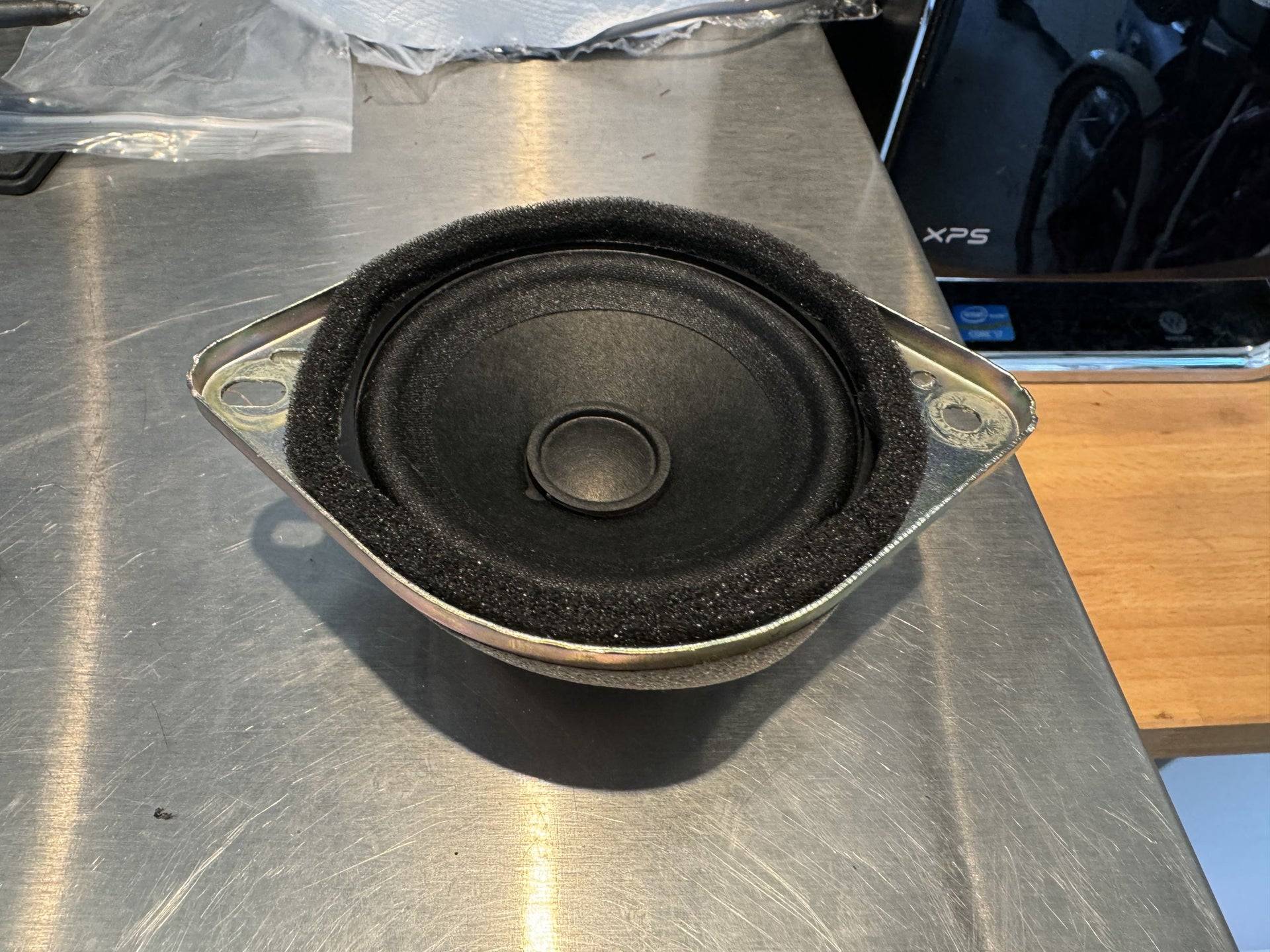

The poor quality of the factory midranges is readily apparent.

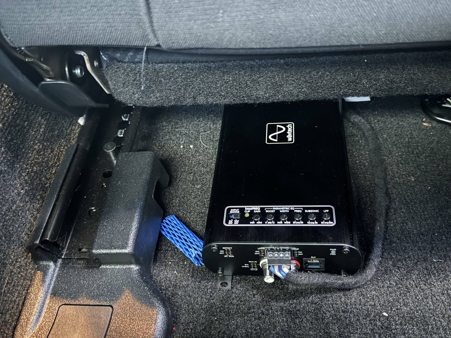

The WavTech amp was installed underneath the passenger seat. Plenty of room as this amp is TINY.

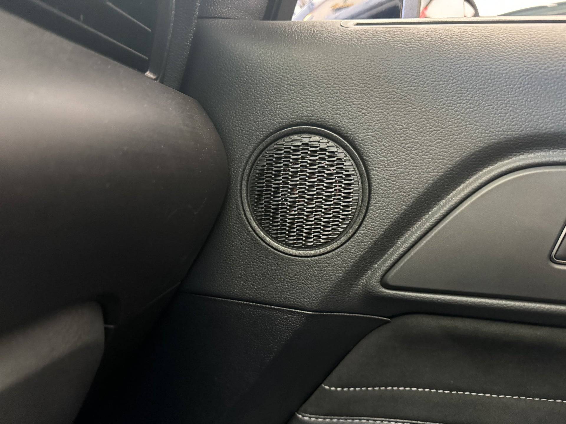

Infinity Speakers are installed. You really can't tell. Plenty of clearance to the grill (something I was concerned with).
Again the factory midranges are very poor in quality,

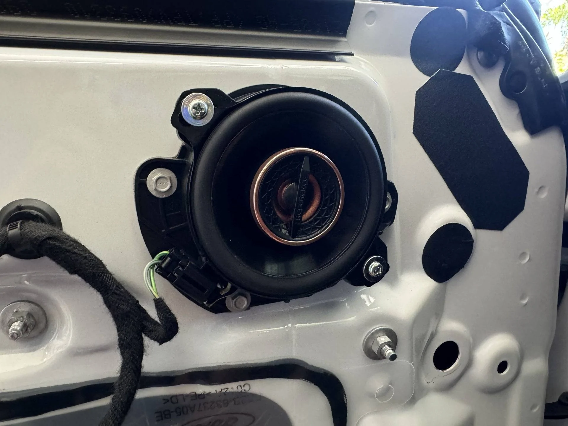

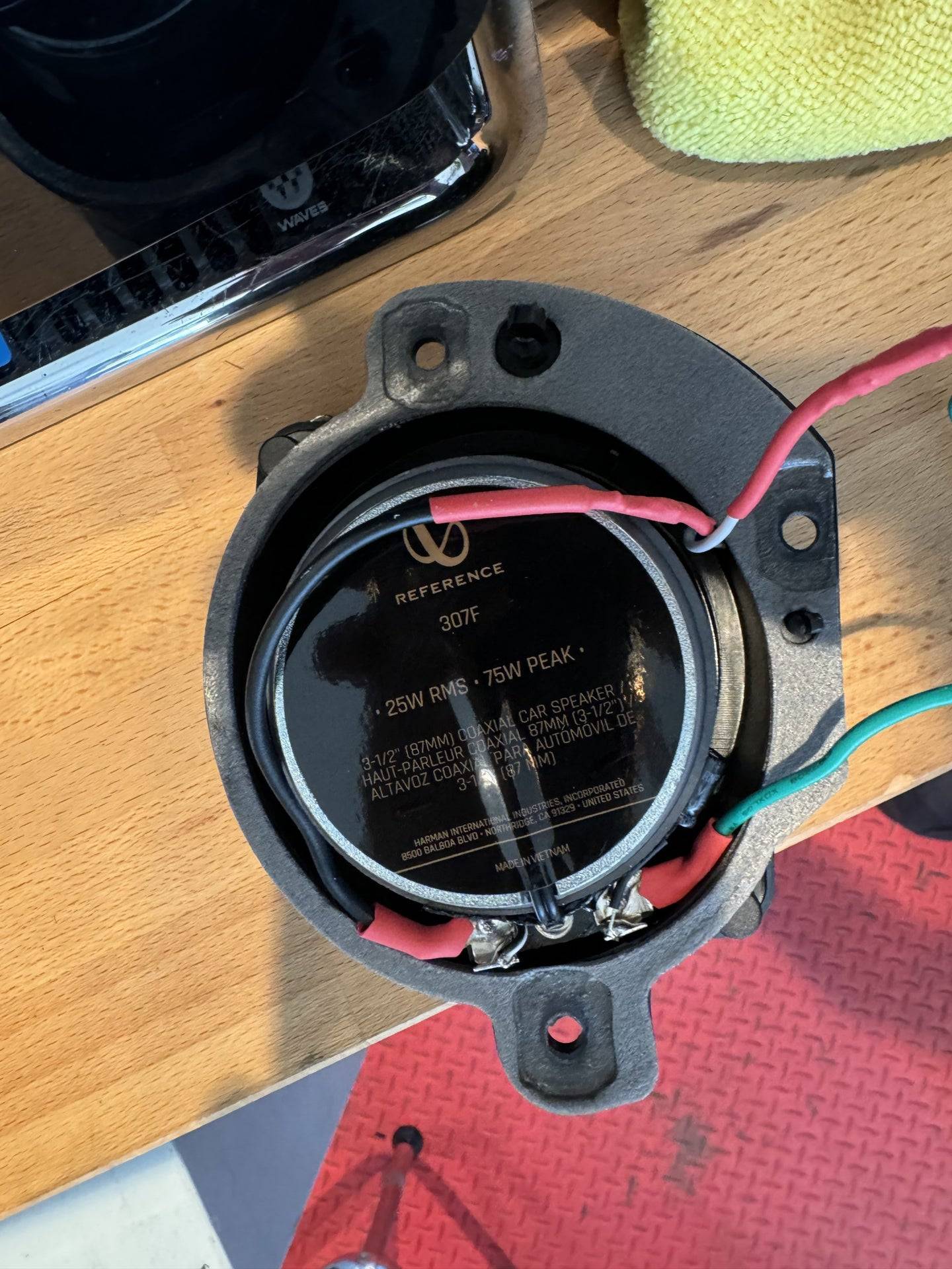

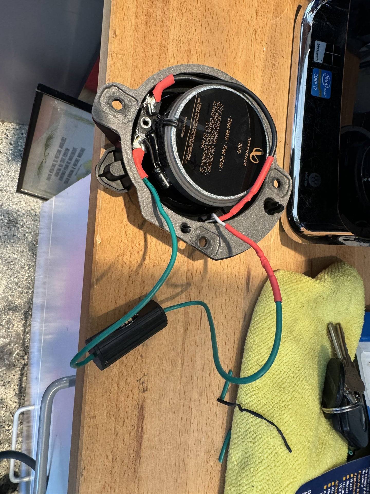

Infinity Speaker mounted in the factory basket. To make it fit without modifying the door sheet metal you have to solder wires directly to the speaker terminals. There is no clearance for butt connectors or the like. I also covered them in shrink tube to prevent any electrical short issues. You can see the bass blocker in the photo as well.
Just another photo of the speaker in the factory basket.
Factory basket installed in the door. I am using the factory harness in case I ever want to go back to the factory speaker.
